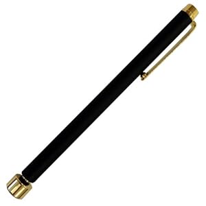

    Get yourself a magnet before you do the job in case you have to go fishing.
