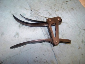

                    The chain rides on some sort of plastic surface. If that has departed, you'll get some noise. You will also have your CCT extended farther because of the missing surface. I'm not sure if you'll be able to see it with the valve cover off. Pull the oil filter and see if there are bits of plastic in it.
                    I am assuming the tensioner is made of metal with plastic bonded to it. I have not pulled or scrutinized one. Other bikes I am more familiar with are made as I describe.

                      Marty could be right, the tensioner/ cc guide has a rubber like surface contacting the chain. It could be damaged, but you won't get a good look at it unless you have a bore scope, or you pull the head. However, this would be something that should get worse over time not all of a sudden.
