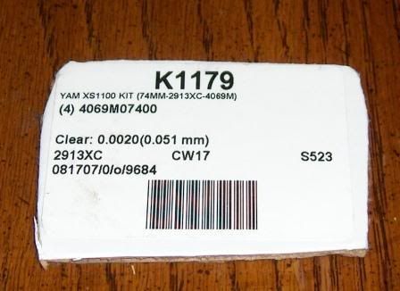

          #64
          I can't vouch for this kit, but I know the Wiseco pistons had a .002 clearance. This was from the 1179 pistons, but the 1196 pistons were the same.
