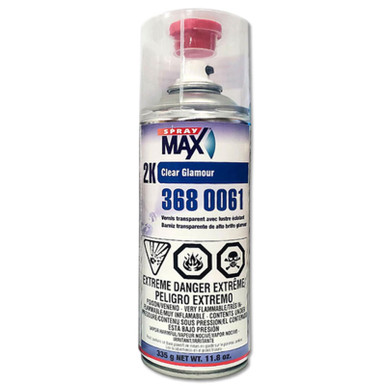

                              2k
                              You can also get 2K paint in spray cans now, here is one:
                              The SprayMax 3680061, 2K Urethane Glamour Clear Coat paint offers many benefits. Buy this 2K urethane aerosol clear coat spray can at R & E Paint Supply.
                              I used Alsa Killer 2K clear, works great but cost 40 bucks a spray can These othere brands are much less and prob just as good One can will cover tank and sidecovers fine
