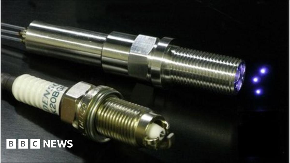

          All spark plugs can foul, even those Mercury perma-gap things that used to be popular in two smoke outboards.
          Check out whats coming...
          Small lasers capable of igniting a fuel/air mixture more efficiently, resulting in less pollution, are demonstrated at a conference in the United States.
