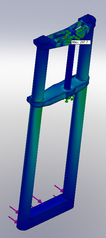

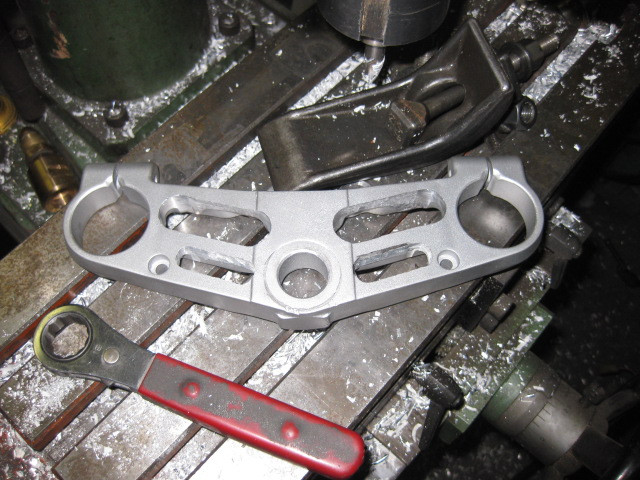

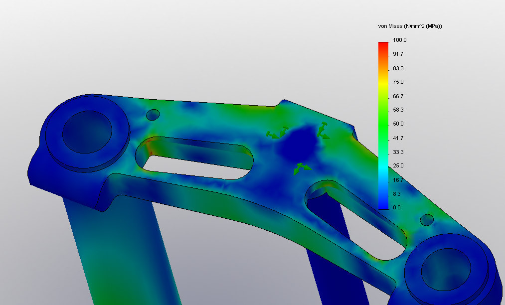

    well, I got a complaint on the UK forum about my machined upper clamp being no longer safe...
    Click image for larger version  Name:	IMG_1479.jpg Views:	14 Size:	122.0 KB ID:	876526
    So for sake of safety I called in some experts help.. here's the result:
    As seen below... the forks with the machined upper clamp.... max stress is in the outer rear side of the smaller openings: 297N/mm2. A good piece of alu can handle 240 N/mm2 pulling force. Damn!
    Click image for larger version  Name:	endu300.jpg Views:	13 Size:	57.1 KB ID:	876527
    Thanks guys
    So... I'm off looking for another upper clamp or.... weld the smaller holes shut again..
    Here's how it looks with only the two big slots on the front. Stress peak moves back into the fork legs. Max stress in the upper clamp does not exceed 110N/mm2.
    Click image for larger version  Name:	endu302.jpg Views:	13 Size:	106.0 KB ID:	876528

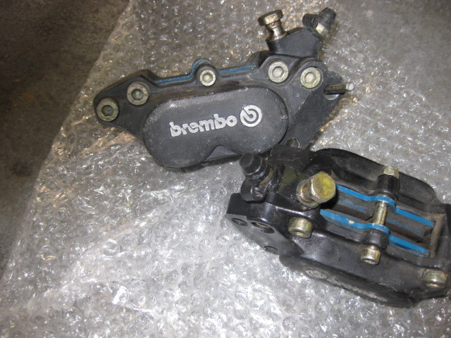

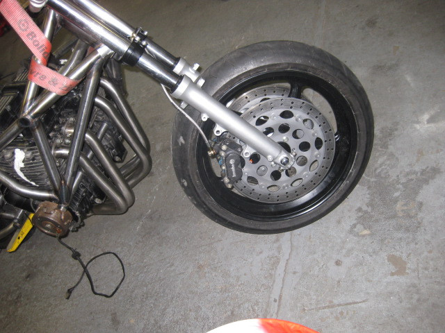

    Tiny small update... I swapped the more modern gold coloured Brembo calipers and brake discs for these older ones. Not period but almost.. :tongue: These were once standard fitment on Ducati 851 superbike ('87-'92). I blasted the gold inner of the discs with aluminum oxide. That gives a very nice, almost painted like finish. Then I have to make up some brackets (easy this one)..

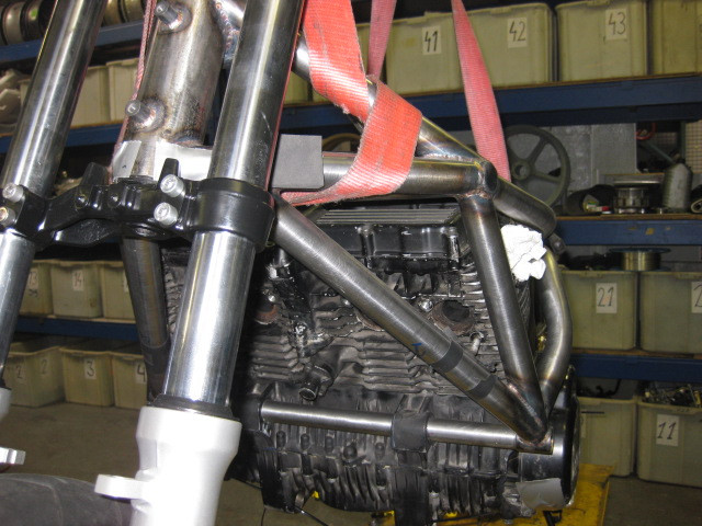

    Originally posted by WMarshy
    How come no FEA of the front half of the frame? I would like to see how stiff it is!
    No, I know it's a shame. But solidworks needs a lot of data to make these calculations and mr.Q is already designing another frame (Suzuki TR750 replica). But don't worry, tube wall thickness and diameter is way more than in those days, that combined with superior steel and welds, this thing is absolutely overkill

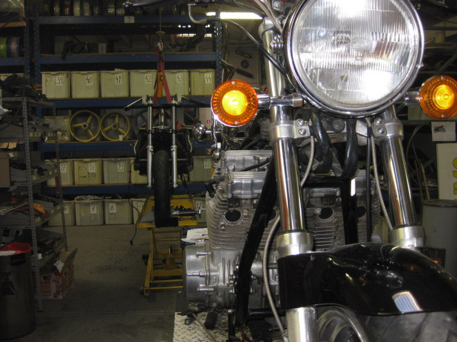

    I had the special in front of the racer and the differences are very obvious.... The racer has its engine sitting 1.5 inch higher from the floor than the stock bike. And the headstock has been lowered 4 inches from stock height.....
    Check lower triple tree clamp vs valve cover on the special and the ones from the racer:
    Click image for larger version  Name:	IMG_1502.jpg Views:	9 Size:	107.7 KB ID:	876514
    Click image for larger version  Name:	IMG_1501.jpg Views:	9 Size:	109.1 KB ID:	876515

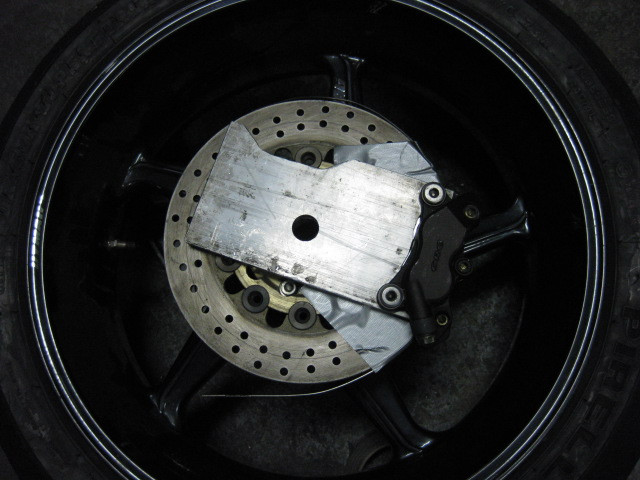

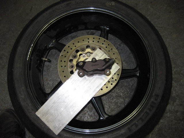

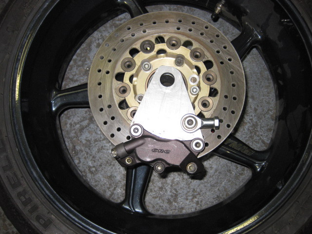

    This week I fabricated some small things like the rear brake bracket (rear brake caliper is 4-piston MV Nissin):
    Click image for larger version  Name:	IMG_1429.jpg Views:	9 Size:	85.5 KB ID:	876516
    Click image for larger version  Name:	IMG_1441.jpg Views:	9 Size:	81.3 KB ID:	876517
    Click image for larger version  Name:	IMG_1476.jpg Views:	9 Size:	97.3 KB ID:	876518
    And I machined 2 extra slots in the upper triple clamp... The smaller ones..
    I shortened the chain and put the rear wheel in line, just have to measure how much the rear wheel has to move to the right now (to get both wheels in line) and make up a spacer that comes between the wheel and the cush drive..
