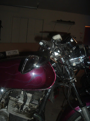

    Part of my right side mirror threads broke off in the perch. I drilled it out but final drill bit was too large. (standard/not metric) I tried PC-7 and waterweld---didn't work. I have been unsuccesfully in trying to find a left hand thread helicore kit.
    Any suggestions--this is a 82 XJ 1100. I thought about JB Weld but figured it wouldn't be any better than the other two cold weld products.

    How about;
    Drill in horizontally, tap it and install a lock bolt with lock-tite.

      Sounds intresting---I have a 5/16 hole, so you want me to drill a horizontal hole, place mirror in hole, (this is left hand thread and the hole even if tapped will be too large of a diameter than the 10mm size mirror stem). Please fill me in.

        It's a common set-screw arrangement.
        You have a cylindical mount. Drill a small (5 or 6mm) hole in the side, tap the hole according to the size you drilled. Install a bolt in the hole you made. Install your mirror stem and tighten the bolt to capture the mirror stem.
        if you go one step further and get a pointed set screw, you can drill a corresponding relief in the mirror stem, that will lock it in place to keep it from accidentally spinning.
        I hope that's clear.

            How about tap it for a right hand helicoil and install a mirror with right hand threads.You might even have more choices on mirrors that way.JAT

                Another uneccessarily brilliant idea
                " I thought of doing that, but figured the left hand thread used on the right was designed/engineered for that application."
                Hi Dodjh,
                remember when Dodge/Plymouth used L/H wheel nuts on one side? Didja ever see a wheel fall off one after they quit doing it?
                Me neither. And there's a conspicuous lack of non-Yamaha right-side mirrors decorating the highways too.
                Cross-drilling for a keeper bolt will let you use a Yammie mirror but will bitch the adjustment so get it right eh? Or salvaging the stripped out hole with a normal R/H M10 helicoil will let you use an aftermarket mirror.

                    Try a Time-Sert?
                    " The hole diameter is now 5/16, so I hope the 10mm size hole helicoil kit will work. "
                    Hi Dodjh,
                    if the 5/16" is too big for an M10 Helicoil to work, try a Time-Sert. A Time-Sert insert has a definite wall thickness instead of being a coil of thread and so may need a bigger special tap.

                      Hi Dodjh,
                      Yamaha used a L/H thread on the right mirror so that if the mirror gets knocked, it comes loose, instead of overtightening in the ally; in most incidents, they get knocked back, not forward!
                      ALL the other manufacturers used standard threads both sides.
                      When I first started working in bike shops (1978?) we caried a range of adapters to fit all sorts of mirrors into all sorts of holes; LtoR hand and RtoL hand adapters plus 8to10mm and 10 to8mm 'cos some of the small Hondas used 8mm mirrors. I have not seen any of those for years, but they must be out there somewhere!
                      Would let you T-sert back to 10mm then fit an adaptor and your original mirror.

                          I have a helicoil chart right here.
                          For a 10mm x 1 helicoil you need a .404 drill(standard 13/32 .406 will work)
                          I would do that .The trisert may be too big outside diameter to leave enough material on the boss.You may want to check how thick it is.
