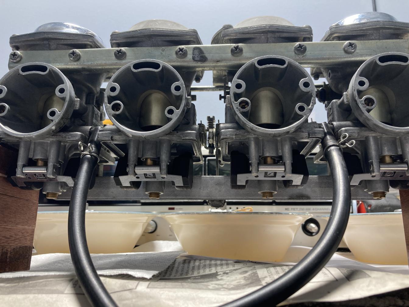

              I pulled the carbs and studied the movement of the floats and the relationship with the drop down tangs.
              None of the tangs appears to been adjusted. They are all perpendicular to the surface of the sheet metal. The floats all hang such that the top of the float is even with the gasket surface:

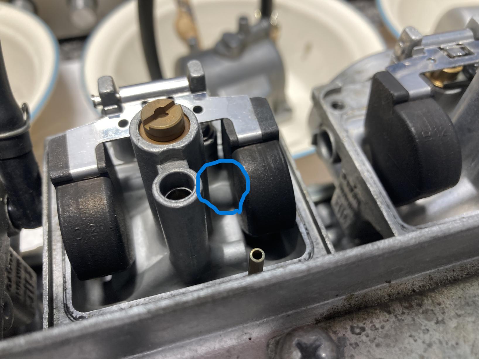

              I discovered that #3 float is bent such that one of the two bulbs can rub the carb body if it is biased to one side. I think this is probably why #3 has been the problem child:

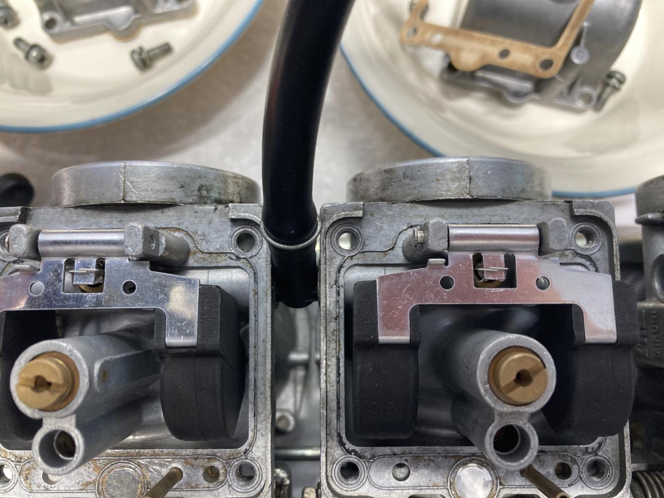

              I studied the orientation of the needle valve wire on the float tab. I found that the way I oriented them was less desirable and more likely to have the wire get off the end of the tab. The float on the left is preferred, and the float on the right is the way I had them:
Name:	IMG_5273 rotated.jpg

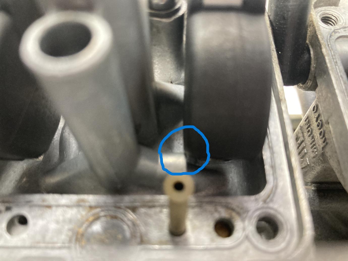

              By horsing around with the action of the floats, I discovered every float can wedge stuck if it is pushed up beyond the closed position. It wedges in the area in the picture below.

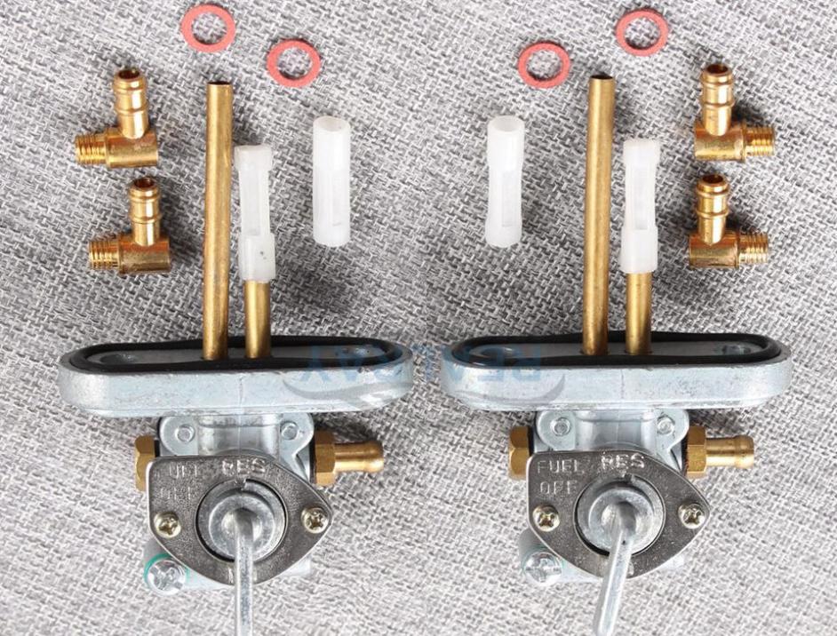

                  You never had just one cylinder die. It was the entire engine. That points to supply. Might still be a petcock problem. They might need cleaning or a rebuild. Are yours stock?
                    • 2069
                    They look stock. I would work in here also after testing the carb rebuild. However, if one side was hanging up it would only block fuel to two carbs unless you have a crossover.

                      Petcocks are aftermrket manual type. They are relativley new.

                          Mike, I go to bed at 8:00PM and get up between 3:00AM-4:00AM every day for the last 25 years. I get more done that way. I guess I remember you mentioning the manual petcocks in the past. I run those too and love em. I hope you find the issue with your bike. I will be here every morning 7 days a week if you need me.

                            I believe the #3 float rubbing the carb body above it was the root cause of most of my problems.
