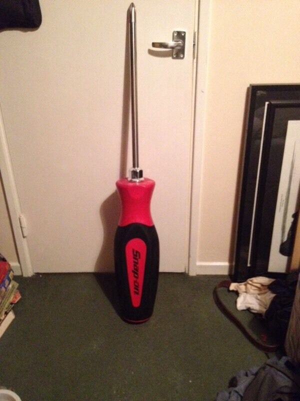

                    I like Bikerphils idea with the drill bit. But for now Mike, keep walking softly and carry a big screwdriver! 😀

                      Marginal:
Name:	Big Screwdriver.JPG
