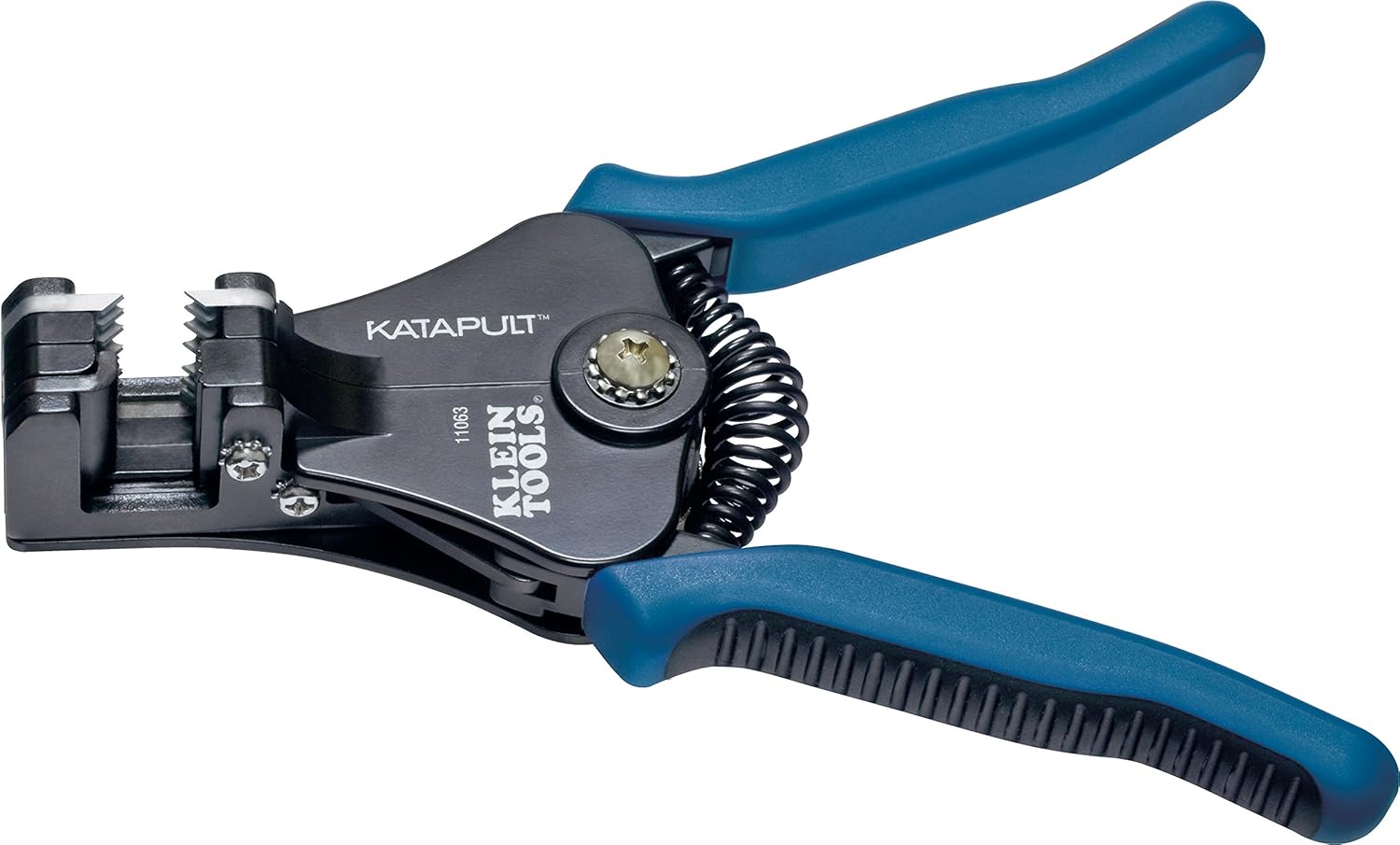

    A proper wire stripper looks like this.
    When used correctly, this tool won't nick or cut wire strands.

    The aircraft strippers by Klein you listed are "okay". The Katapults are part of the Journeyman line, and made in China, unlike their original US made tools. Now that Home Depot bought Kline, the tools are all made in China, and the build is definitely inferior. I've bought 10+ sets of aircraft strippers, and found the cheapest and most likable are made by Irwin. $22, and they hold-up well!
