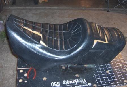

                    They do make a really nice seat cover. They sew a little extra padding into it to make up for a few years of "Crush" to the OEM cushion. This is before/after of my seat.
                    The problem is... You need to staple it with 1/4" staples, (Plastic seat pan on the XJ) which aren't very common, and a regular staple gun won't go through the plastic. I ended up using a slap style stapler that you use putting up insulation bats, but it cut the material a bit in places. My suggestion is to find an upholstery shop and spend a couple bucks more and let them use their pneumatic staplers if you don't have one. 5 minute job at the most.
                    Sorry you're having so much trouble from them. I didn't get that at all with them.

                      Thanks for the before/after shots. I did receive my seat cover and assume that my experience isn't typical. My mistake was not calling sooner.
                      I don't think there are many affordable options in getting an OEM style seat cover, so if it takes some time, so be it.
                      Now that I have the seat cover, it was worth the wait over re-covering with an aftermarket cover.
