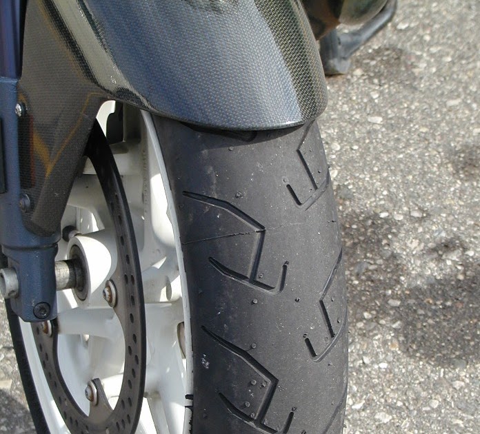

                Dyna bead fan here.
                I rode with Dynabeads for about 49k on my last bike. Just bought the XS and do not have them installed yet.
                They WORK.
                I tried them in desperation on a tire the BMW dealership could not get balanced.
                Wrote about it here:
                Are you still riding around with ugly wheel weights on your motorcycle? Believe me - There is a much better way: Dyna Beads. ( http://www.in...
                and again here:
                Nothing quite like the feeling of new tires on your bike, is there? Dang, I like it alot. Had my ...
