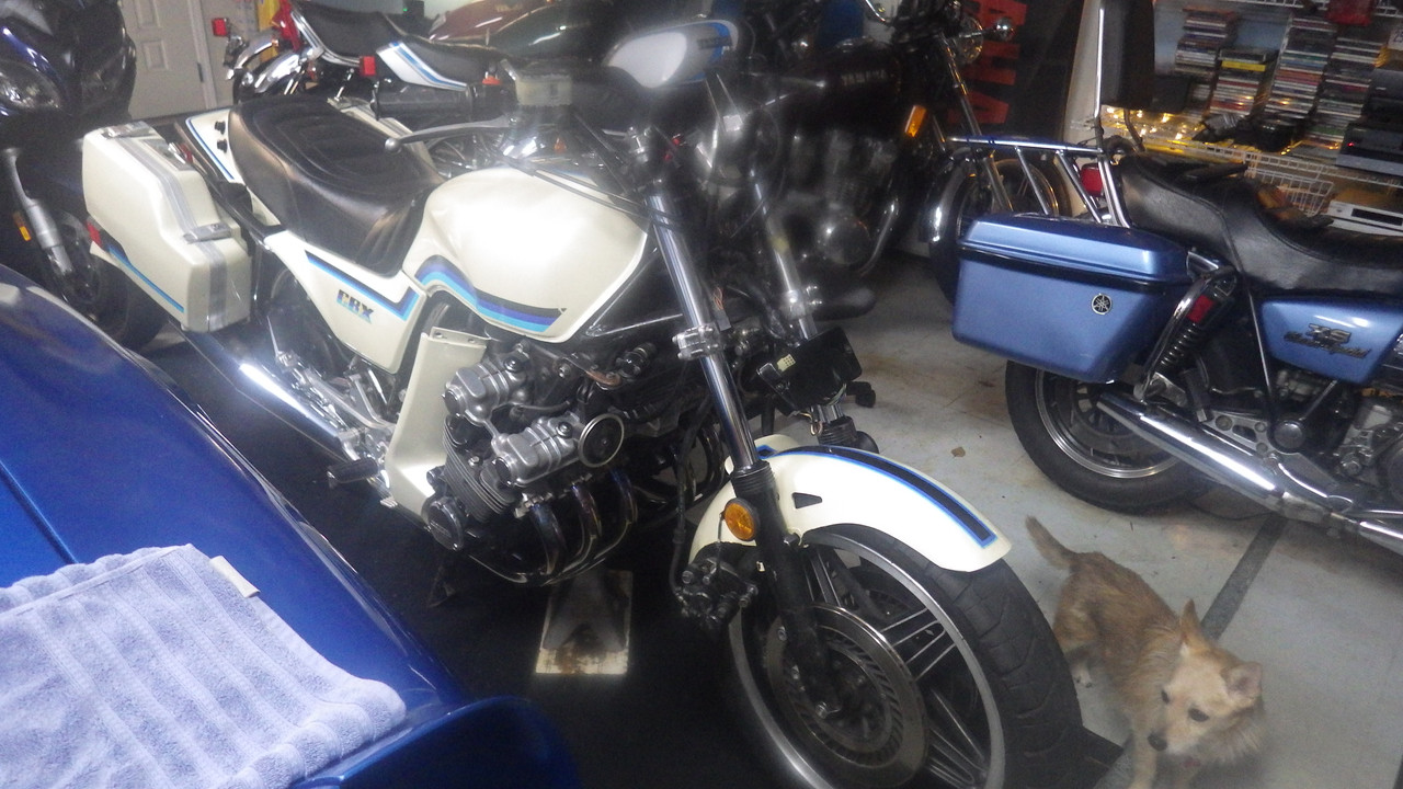

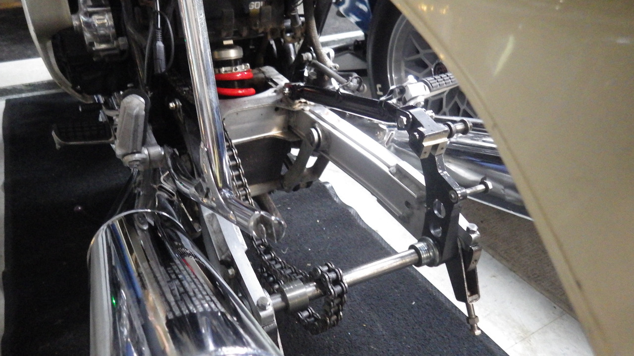

            Thanks Mike. But, it's not entirely fixed up..... There are a few deficiencies that need to be addressed.....
            • The brake lines appear to be OEM 1982 - New replacement SS from GoodRidge have already been ordered. New pads received yesterday.
              • I'll ride it, but VERY LIMITED until the brake line, pads, and rotor are up-to-snuff!!
            • The rear rotor is TOTAL CRAP... - Coordinating a replacement with an e-bay seller today.
            • The rear OEM air shock was replaced with aftermarket - Needs adjustment as a MINIMUM but I have the original and may attempt a rebuild and put it back in.
            • Front forks need new seals - Previous owner provided the new replacements so that's a plus. No air assist until seals are replaced.
            • A very SLIGHT hesitation in the mid-range.... EXTREMELY slight, likely just a carb tune & balance (X6 Carbs )
            • Tires are crap Shinko's and will need to head for the garbage as soon as possible. Michelin offers tires to fit the rear 18".
            • Seat is a crap Corbin that favors the driver eliminating some of the space needed for Muffy. We had this problem with a Corbin on my FJ1200 and my seat guy completely re-did the cushion and cover. He'll be tasked with the same for the CBX. The only advantage to the Corbin is the backrest, otherwise I'd toss it in the trash and use the OEM seat the PO provided.
            • Not certain when (or if) the valves were adjusted last. This requires a special tool (yet to find) and REMOVING THE ENGINE to accomplish.... Without frame down tubes, the engine is a stressed member of the frame "system" the attachment points on the head preclude pulling the valve cover unless the motor is disconnected from the backbone. There are actually FOUR cams as there are two per side (intake & exhaust) that are coupled together in the middle. Drive of the cams is also unique with an extra chain and other goodies.
            • Rear pull bar is missing. This is a 1982 ONLY item and hard to find. Found one complete at a CBX stripper in Florida - $400 - OUCH!
            • The airbox lid is missing, not a huge problem but a problem none the less. Only the 1981 & 1982 will fit. Haven't found one yet....
            • Right turn signal was in-operative but I already fixed that & several other SMALL issues.

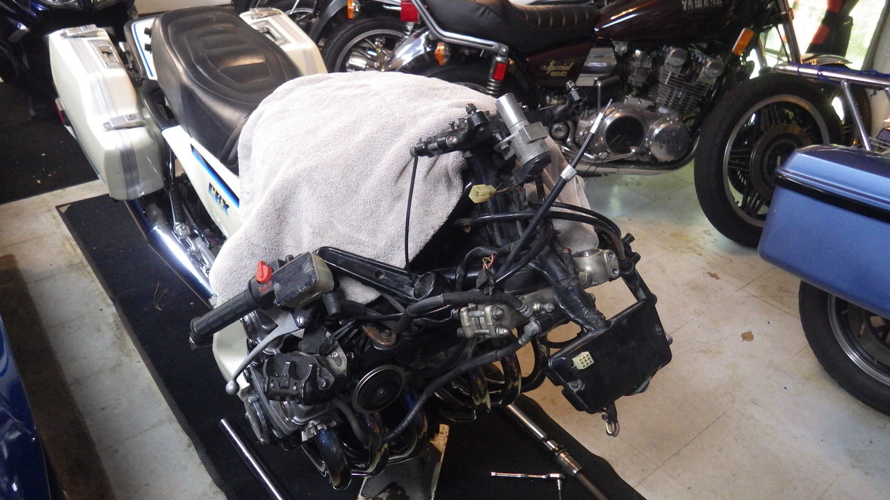

                Thank you.... But the bike is NOT already fixed up! Although the exterior is quite nice (it does have a few blemishes). Under the covers there were problems galore.
                Unfortunately, although I planned to just "Order Parts" and wait until after the rally, some work just had to be done......
                The brakes were absolute CRAP:
                • Brake lines date coded 6/1981
                  • Replaced with Goodridge SS all around!

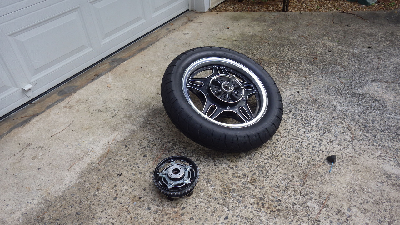

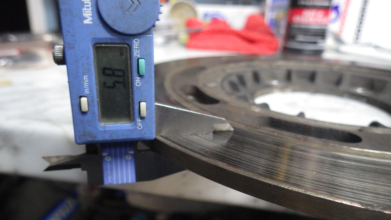

                • Rear Rotor - Trashed Measure 5.8mm with a 6mm limit.
                  • Replaced with new drilled aftermarket
                • Fluid Looked like MUD
                  • Complete FLUSH of masters and calipers
                • All pads looked suspect but not horrible
                  • Were likely replaced recently - Replaced 'em again anyway!!!
                While I have the ENTIRE front end off...

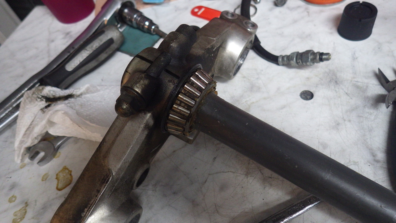

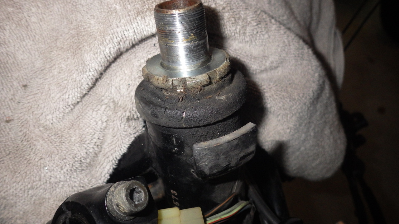

                • Steering head bearing condition unknown - Suspicious never serviced...
                  • Verified! Never Serviced
                  • Replaced the bearings with new!
                Front Forks
                • Leaking
                • Won't Hold ANY Air
                • Watching them DRIP down the back legs.
                  • Completely cleaned, new Seals, new dust seals, new fluid (of course).
                  • Hold 10# of recommended air.... feel great now!
                Obviously NEVER EVER EVER Serviced in 44 Years
                Partial Re-Assembly with new bearings - Bearing grease is a MESS to deal with....(Mike knows this well!)
                Discovered a REALLY F-Up Right Front Caliper Mounting Bracket.... Thought I was SUNK....(More on that in a minute).
                Had to CLEAN the rear end to within an inch of it's like....NEVER BEEN PROPERLY CLEANED!!!
                REBALANCED the wheel after installing new rotor.... Should have done the front too but kinda forgot...Wanted a wheel back on as support for the CBX is limited by one jack stand.

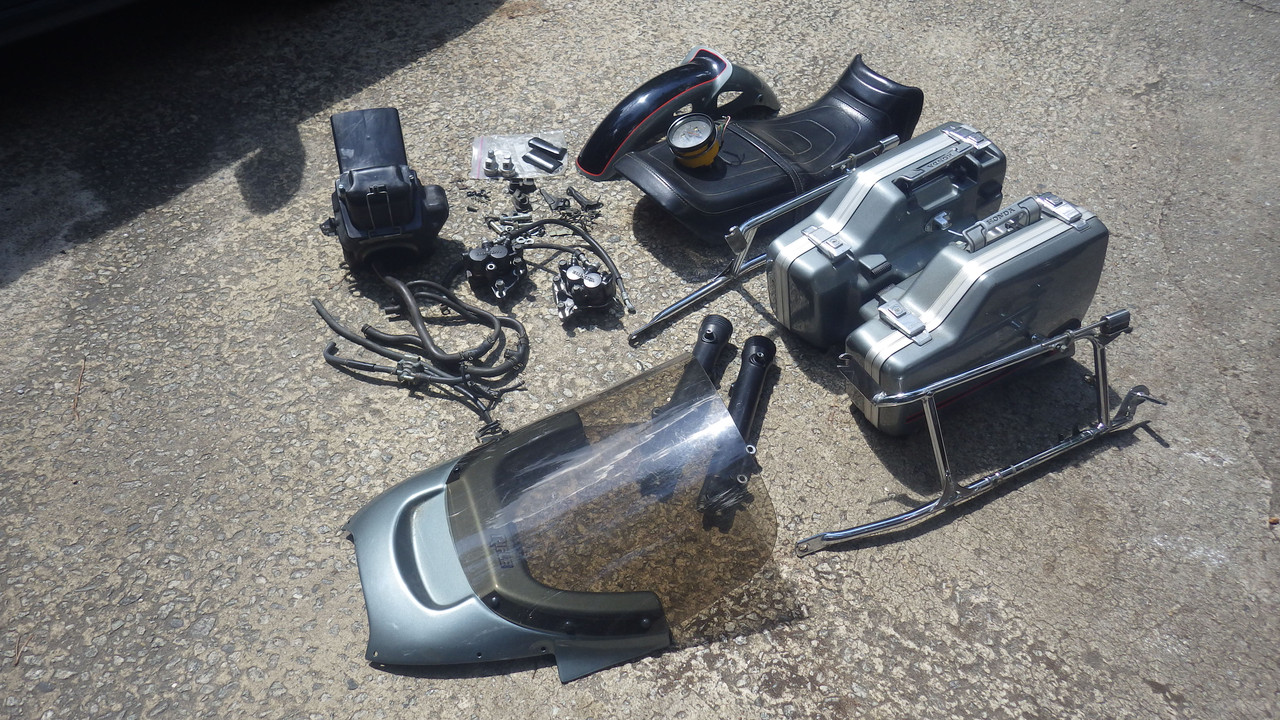

                  For those that THINK XS11 or other Yamaha parts are hard to find.... Try finding parts for a bike, produced for only 5-years in a total quantity of ~20,000 units WORLDWIDE. On top of that figure, many parts from the earlier models will NOT fit the later models (81 & 82) and one of two items are one year only (i.e. my missing rear pull bar is 1982 ONLY). All the tanks for every year have some differences too.....
                  Anyway, I noticed a post from Fort Mitchell Alabama for a batch of 1982 CBX parts. The post was 15 weeks old... But, I reached out and the guy hadn't sold ANYTHING. He had some inquiries from folks overseas but they all had crazy payment plans and wanted free shipping etc. "Robert" was not that stupid. We went to Fort Mitchell yesterday and took a look. Robert's wife was pushing hard that this stuff HAD TO GO. Robert even deflected the pricing to "Bea" his wife asking what she wanted. As far as Bea was concerned I COULD TAKE IT ALL to just get it gone... NO Charge.
                  Obviously, I wasn't going to do that. There was real value here INCLUDING THE MISSING AIR CLEANER CAP!!! I laid out a small pile of parts and offered $150 - Accepted! Then I gathered a few more parts and as far as Bea was concerned I could have them too.... I provided another $100 Robert said.... go ahead and take whatever you want!!!
                  What did I end up with?
                  • Both Front Calipers & brackets
                  • Fork Tube Lowers - Perfect OEM Paint and Great Condition.
                  • OEM Seat - Great Condition (Shown in photos above as the Corbin is getting recovered)
                  • Front Fender - Fantastic Condition (Unfortuantely Wrong Color)
                  • Saddle Bags & Full Mounting Hardware (Again, Unfortunately Wrong Color) Hardware is perfect and mine has some pitting
                  • Aftermarked RIFLE Windscreen & Mount - Hightly Sought After (Again, Wrong Color Base).
                  • Speedo - Seem the PO of Robert's bike changed the mileage.... That was news to Robert!
                  • AirBox Extension WITH THE HARD TO FIND COVER!
                  • Fuel supply Octopus (Honda's Version) with all the lines & splitters.
                  • Bag of misc. hardware & brakets...
                  It seem I mostly end up with the "Short end of the stick" or the "Low card in the deck". Yesterday was all ACES!
