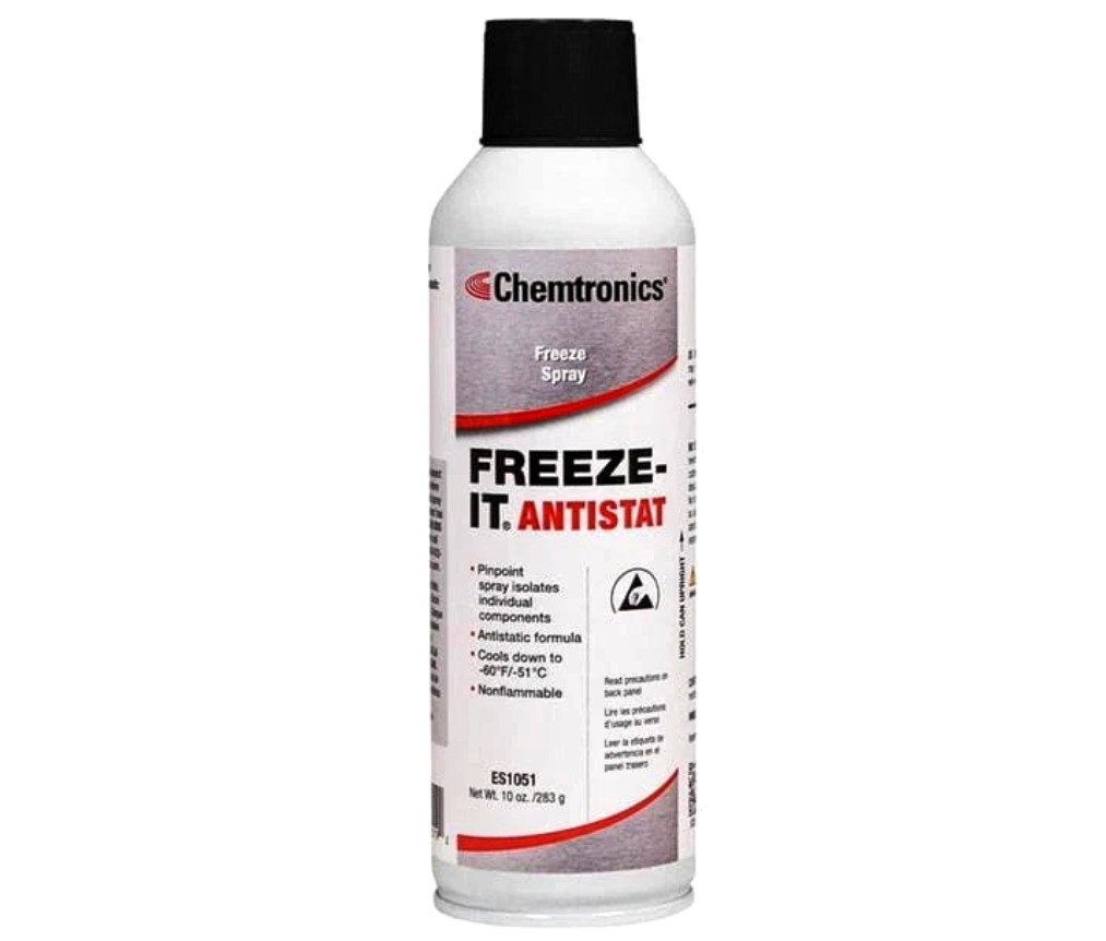

    Heat is the enemy of electronics. It is an exponential action. Heat causes resistance which causes heat which causes resistance. Hit the starter motor with Freeze It spray when it gets hot. If it starts right up, you have a bad starter (or bad starter connections).
