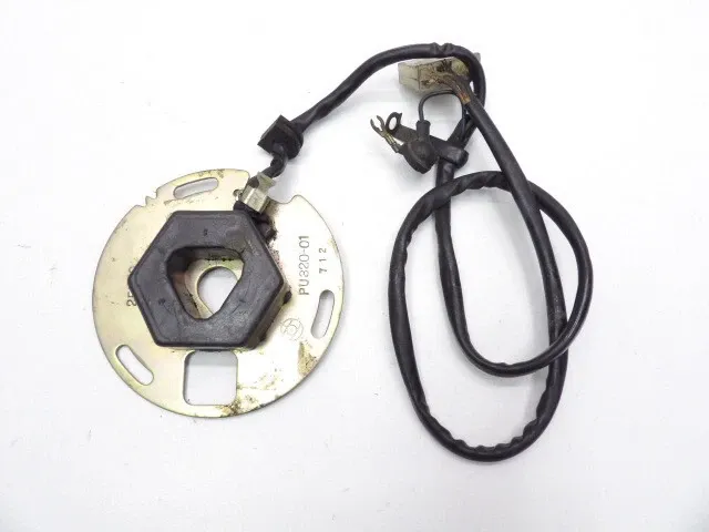

                          • 2162
                          The XS750 pick-up coils are much different than the XS1100. They are much more robust. They are potted in a single assembly. They rarely fail.
