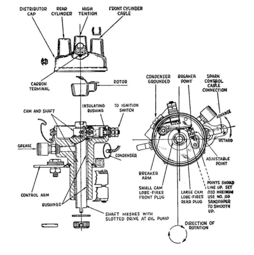

    It is imperative that this is set correctly. You retard the timing to kick start the bike. Any deviation (usually too much advance) and it can kick back and break your leg.
    Add in higher compression and the orthopedic surgeons stay busy, hence the XLCH (Extra Large Charlie Horse)

      The Indian distributor.

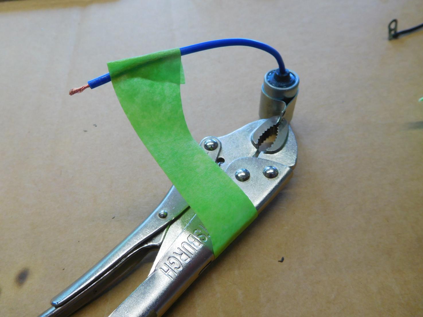

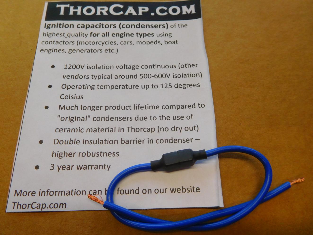

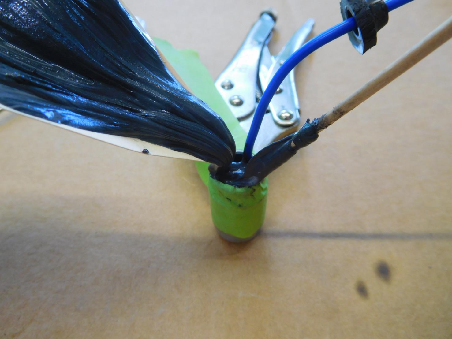

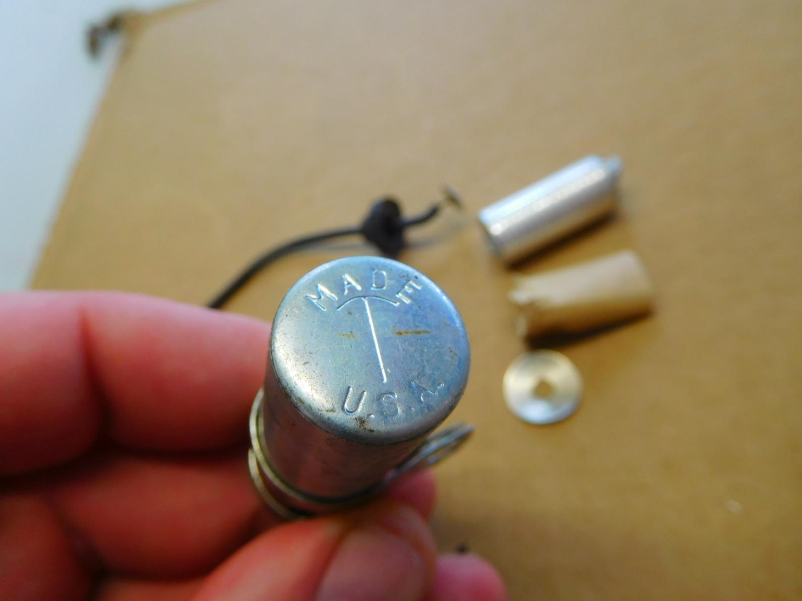

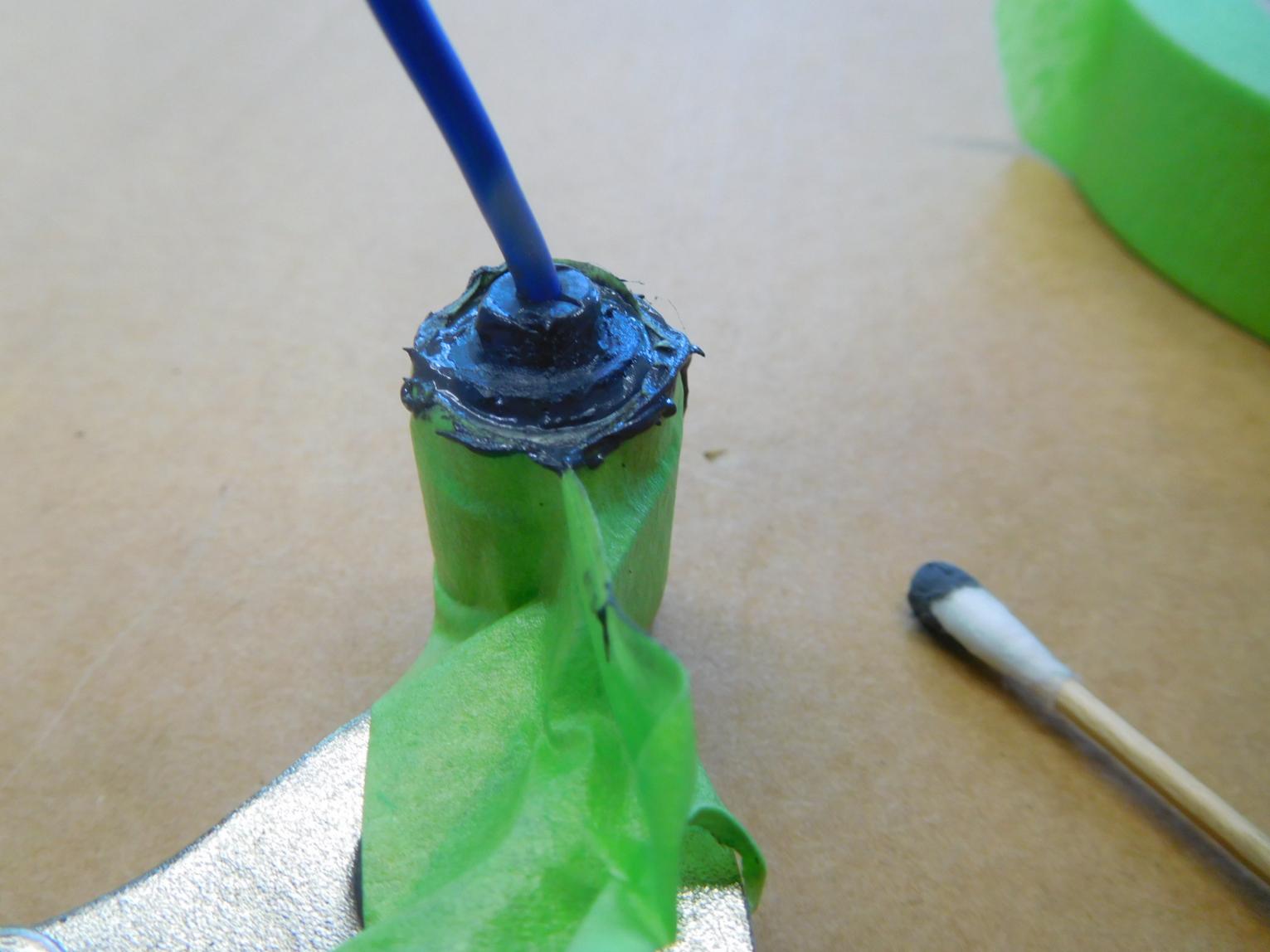

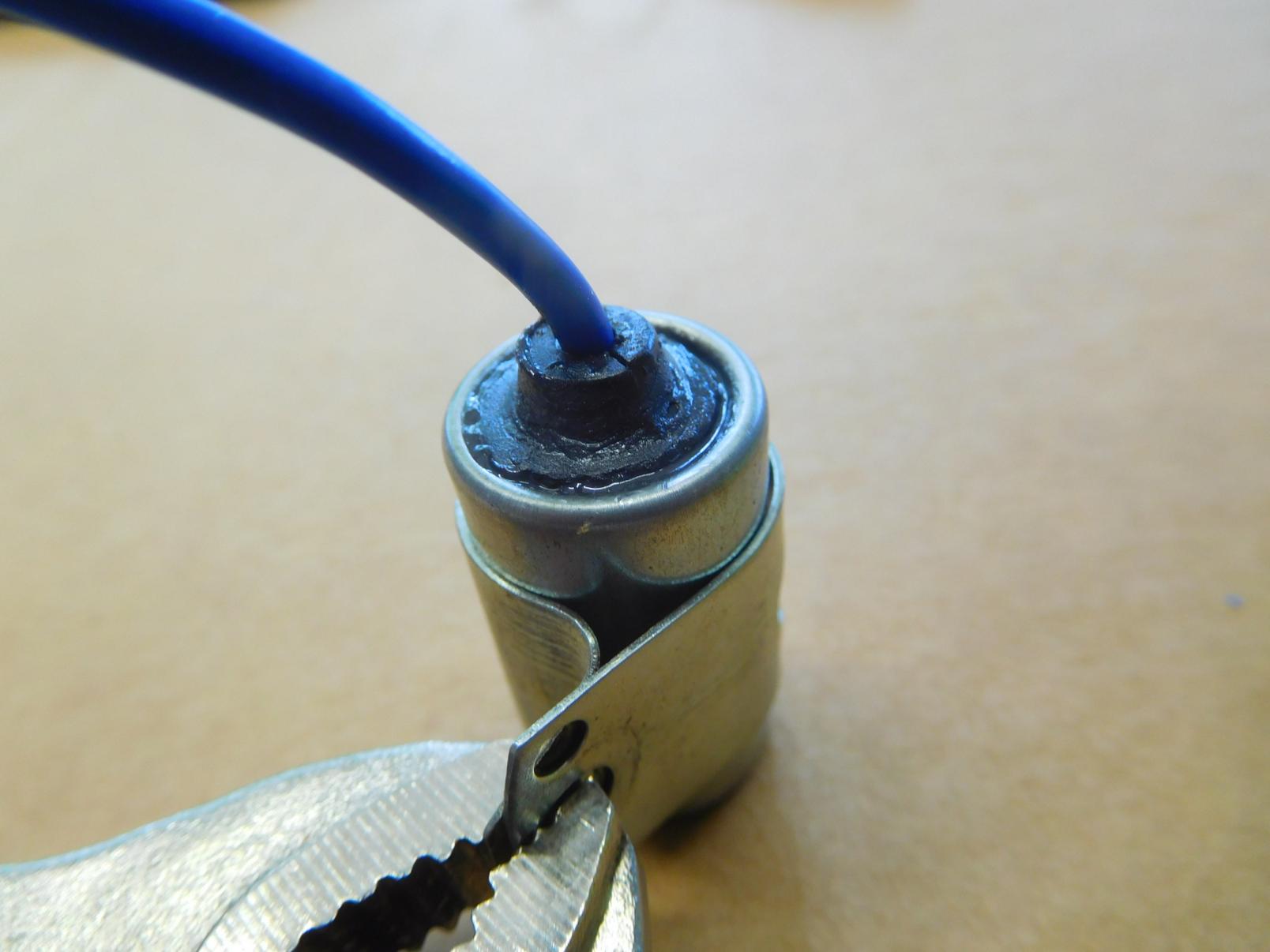

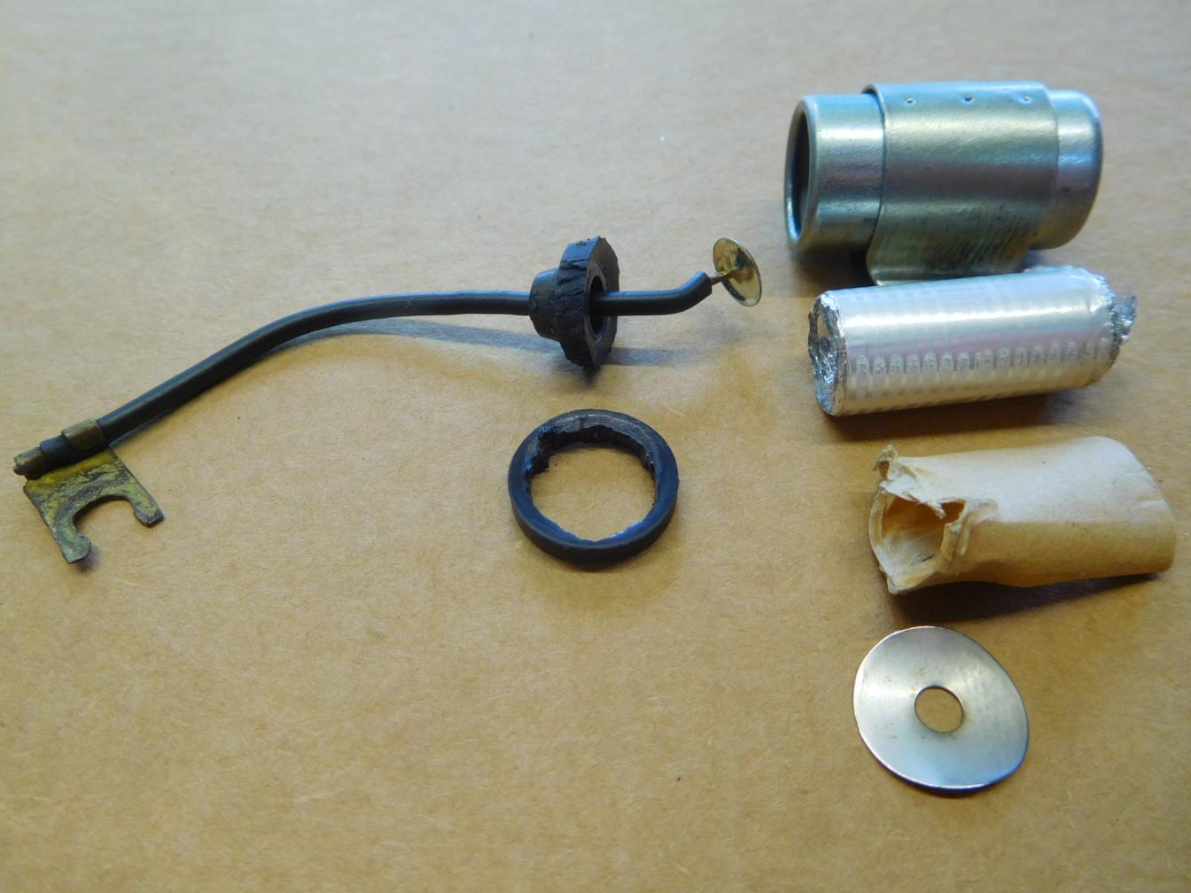

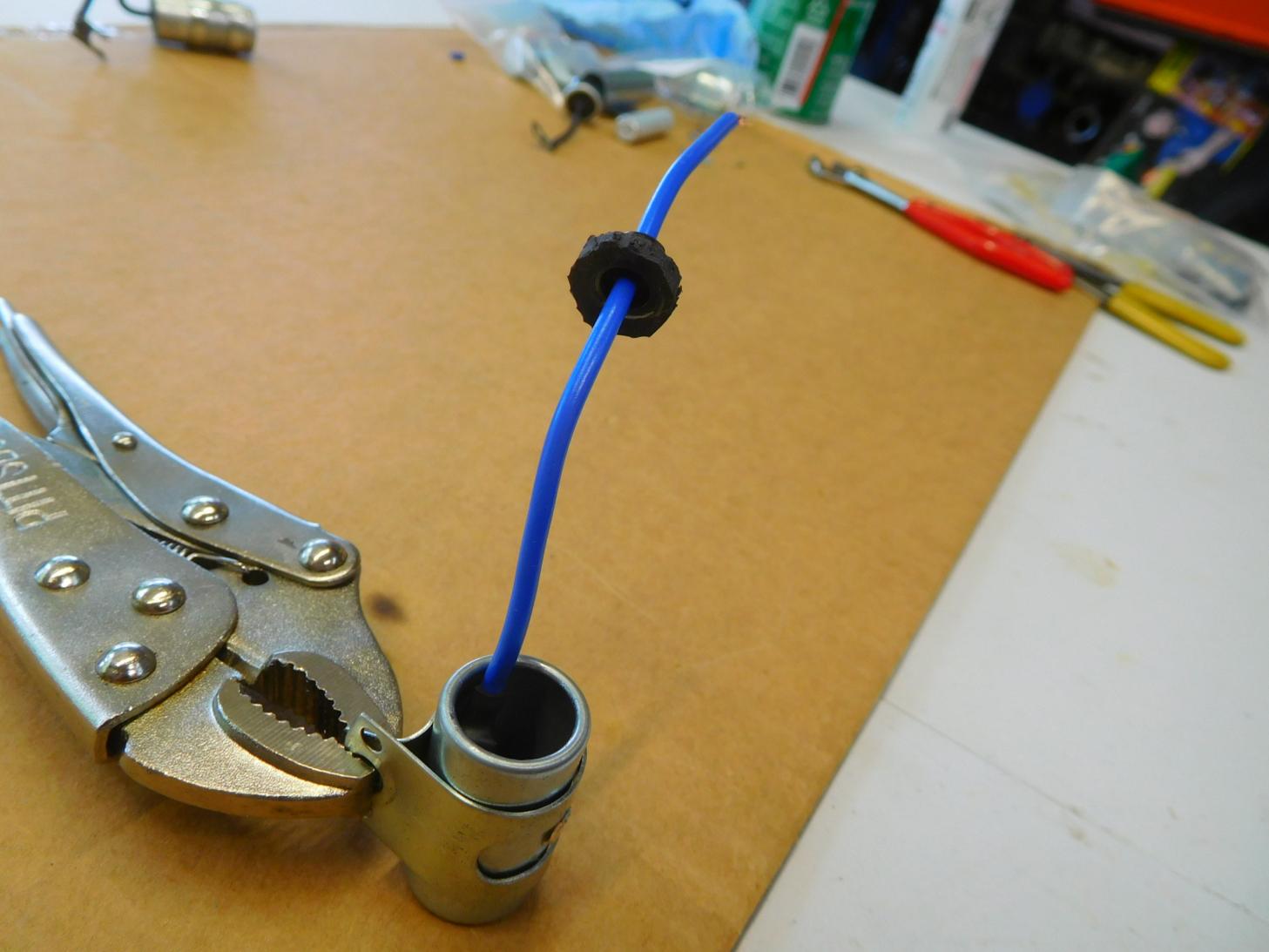

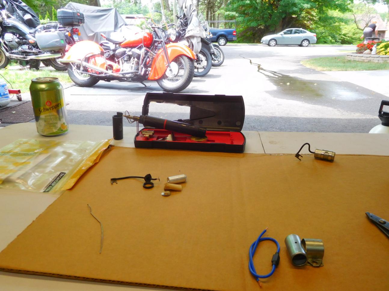

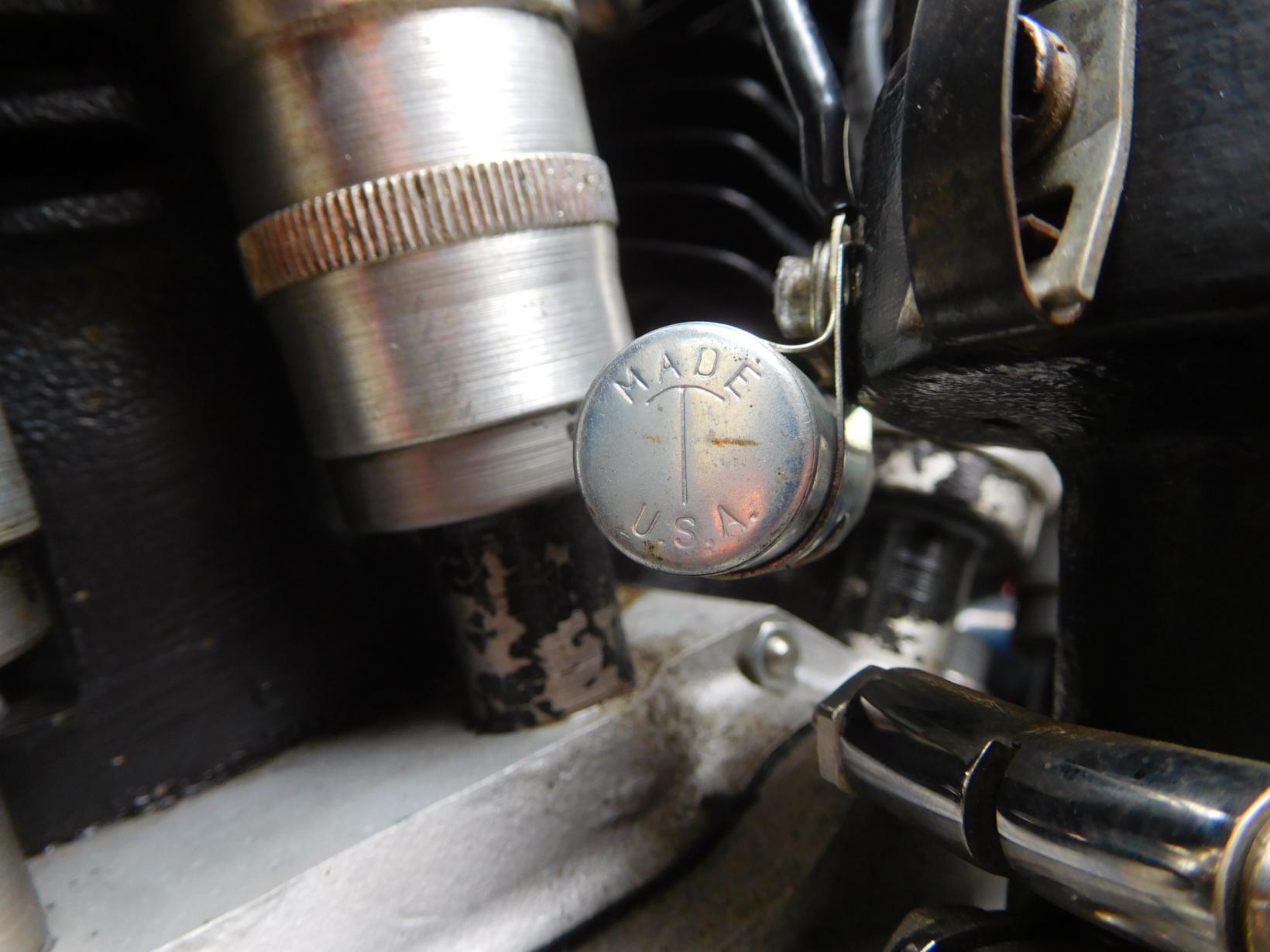

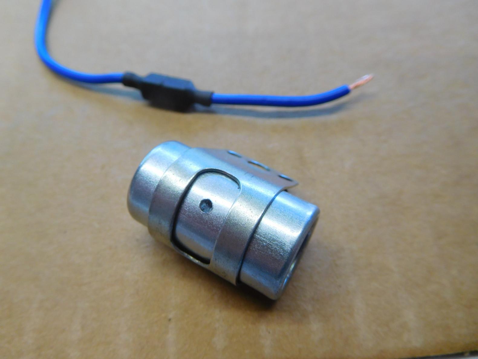

                    Some old bike still use points and condenser. The quality of cheap Chinese condensers can leave you on the side of the road. It has happened to me twice in the past 30 years. Once on the Indian and once on the BMW. I now use Thorcaps which is virtually a lifetime capacitor/condenser. This is how I hollow them out to hide the guts and then fill with JB Weld. This can be used for 100 point restorations on Indians or Harleys. BTW just about all condensers on any motor is 22uf (22 Micro Farads). This will even work on an old lawn mower.

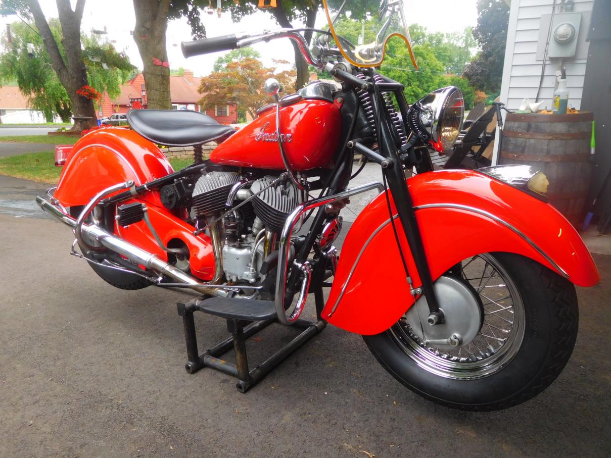

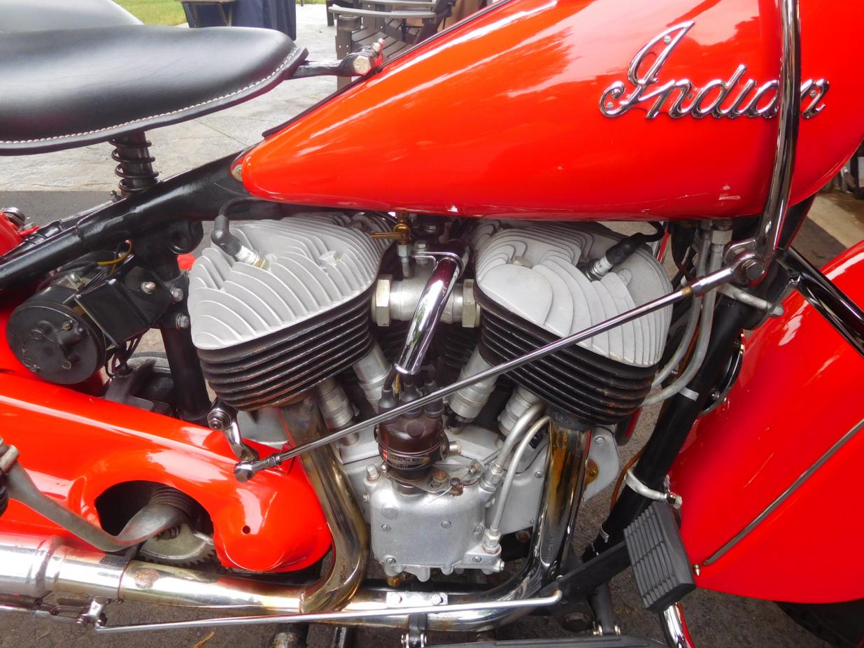

                            Will be riding her to the AMCA meet today in Greenfield.

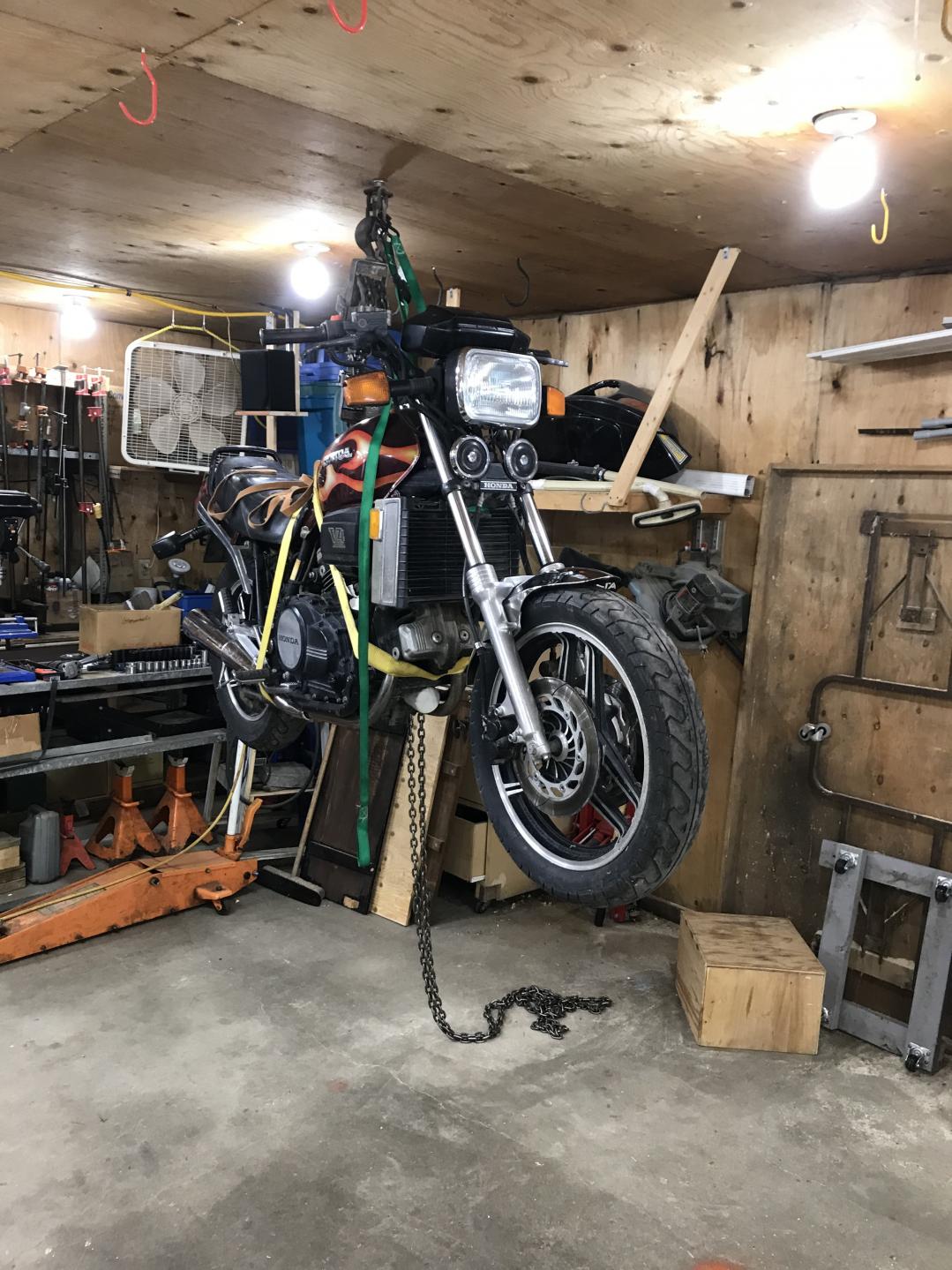

                              How two decrepit old buggers get a heavy motorcycle off the back of a half-ton without breaking a sweat. 1984 Honda V45 VFR750S found on Facebook Marketplace about 1.5 hrs away. Neglected for many
                              years needing not only TLC but levers, battery, r side cover, r mirror, straightened/repaired signals, and seat recovered. (Bless the Lord and/or AL Gore for the interweb and on-line shopping) My research
                              uncovered the fact that as of '84 due to heavy import tariffs placed on bikes over 700cc into the US, this particular model was unavailable south of the 49th and appeared as a VFR700s. This is making it
                              interesting to find parts but appears mostly similar to an '83. Despite deficiencies, it's mostly there compared to some of the basket cases (literally in baskets) I've helped rise from the ashes in the past. Not seized up
                              as it spun over when jumped. Going out today to get 5 gallons (18 L) of vinegar to help get rid of the rust in the tank. Like a kid at Christmas - blinded by solid mags (not comstars),
                              mono-shock rear suspension, shaft drive, 6 spd trans, anti-dive front end, built-in fork brace, 4 valves/cylinder and a 10K redline. Getting used to the flames on the tank and tail - not a big fan at first but it
                              appears professionally or at least well painted and not easy to remove without a complete re-paint (not in the budget). Any insights as to what to watch for on a Honda V4
                              welcome. Who says I'm not up for a challenge?

                                Those can be picked up for a song, I've often considered getting one for that exact reason. The only issue I've heard of on those was premature cam wear and failure due to the manufacturing technique used to manufacture them along with a design flaw. The cam was designed in the same way a two valve engine is with one lobe opening/closing one valve. In the four valve engine each cam lobe opens and closes two valves putting a lot more pressure on the cam which contributes to early failure. Needless to say that makes good used cams more difficult to come by and sending folks into the aftermarket for replacements.
