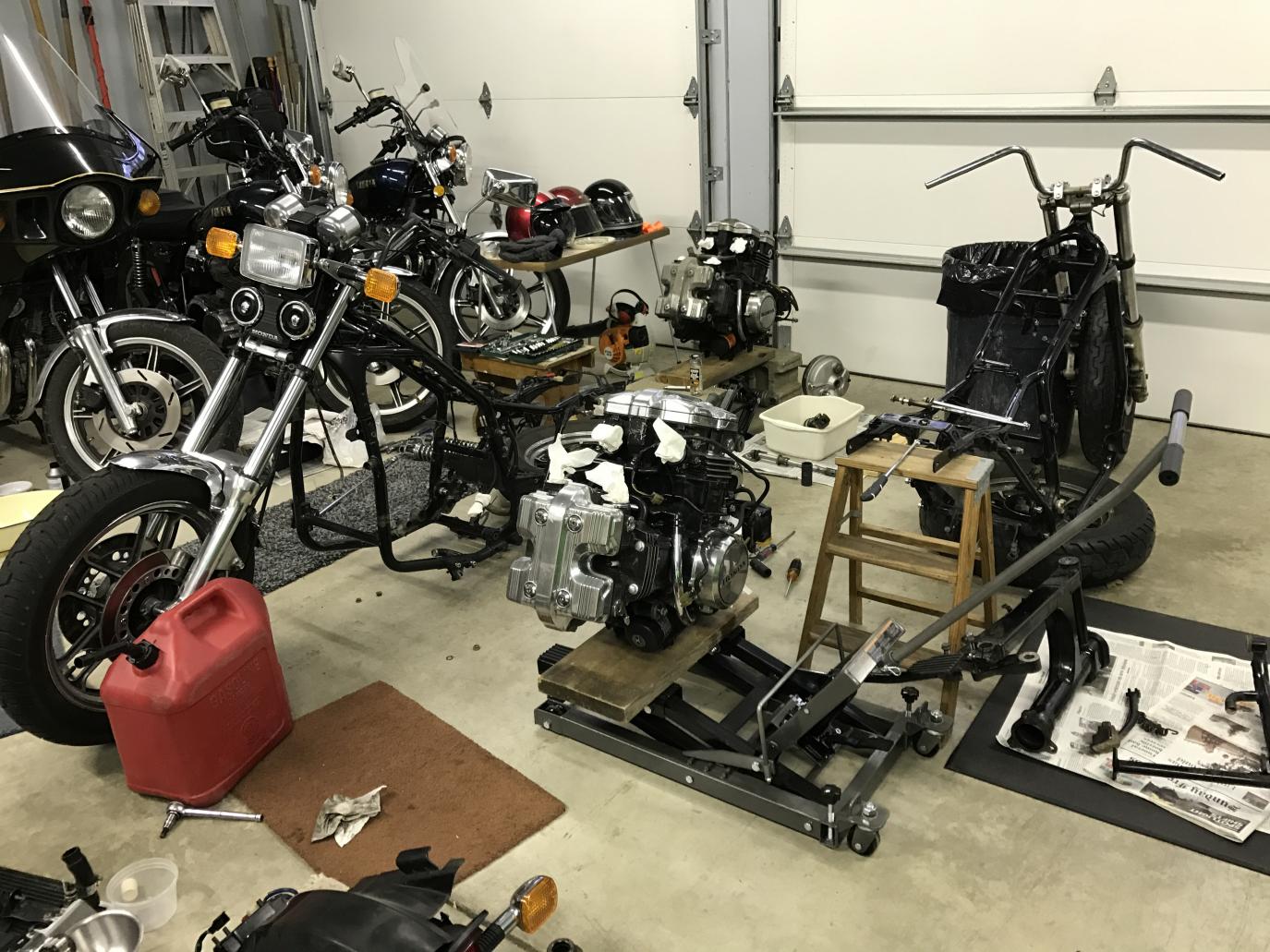

        I did everything except split the cases on my previous V65. I rebuilt everything and then discovered the frame was bent. So I took it all apart AGAIN and replaced the frame.
        My current V65 came with a rod knock that became loud enough to diagnose with a couple of hundred miles. I did an engine swap on this one.
        I have not had any transmission problem so far (knock n wood).
        Here is the frame swap in progress:

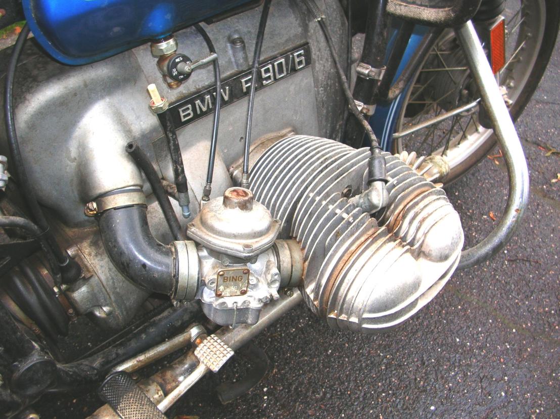

              #66

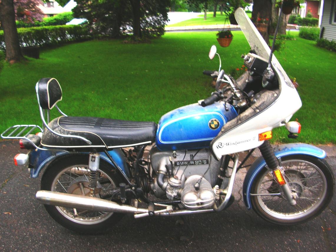

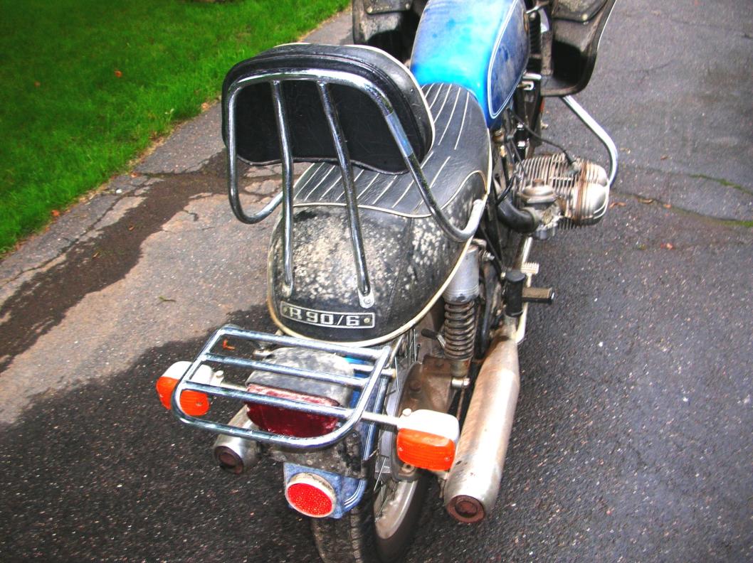

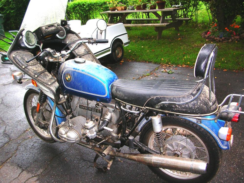

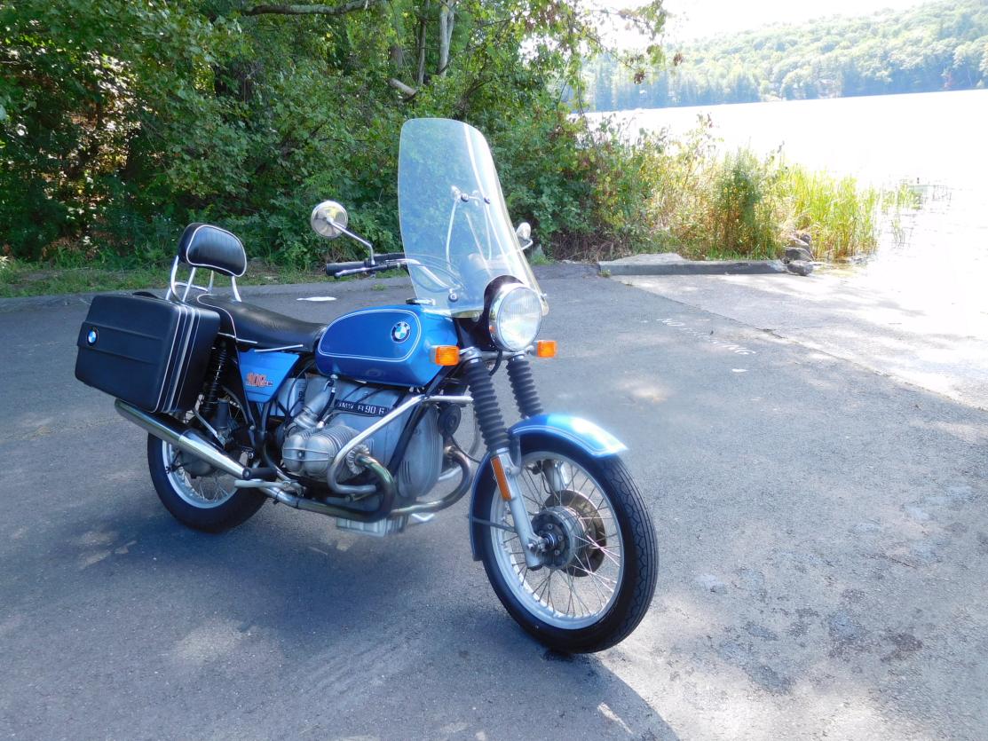

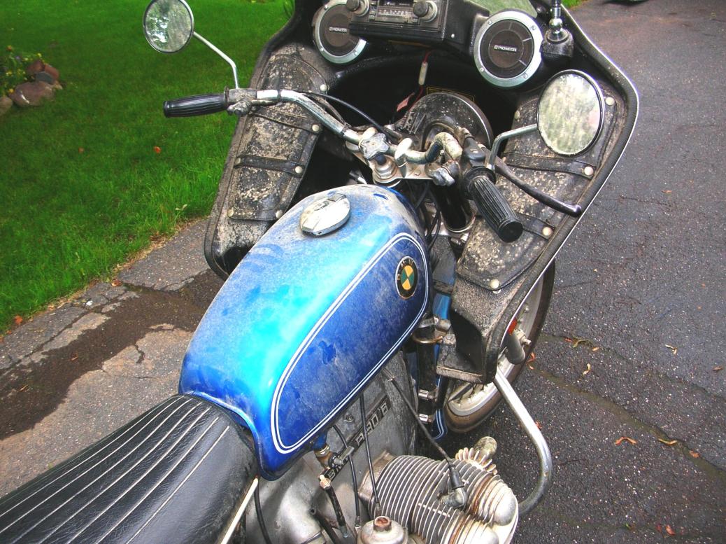

              My 74 R90/6 BMW uses oil. Quite a bit. Kinda like a 2 stroke. However, it runs great. I have ridden it for twenty years after a mechanical restoration with only basic carb rebuilding, points/condenser replacement, coil replacement, and valve adjustment/sync. It's time for a last ride and tear down to rebuild the motor from the crankshaft up.
              This is what it looked like in 2006 when I brought it home for $300.00.

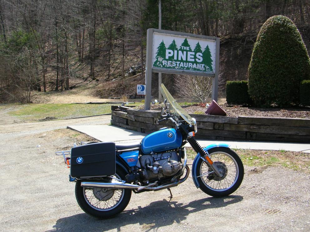

                #67

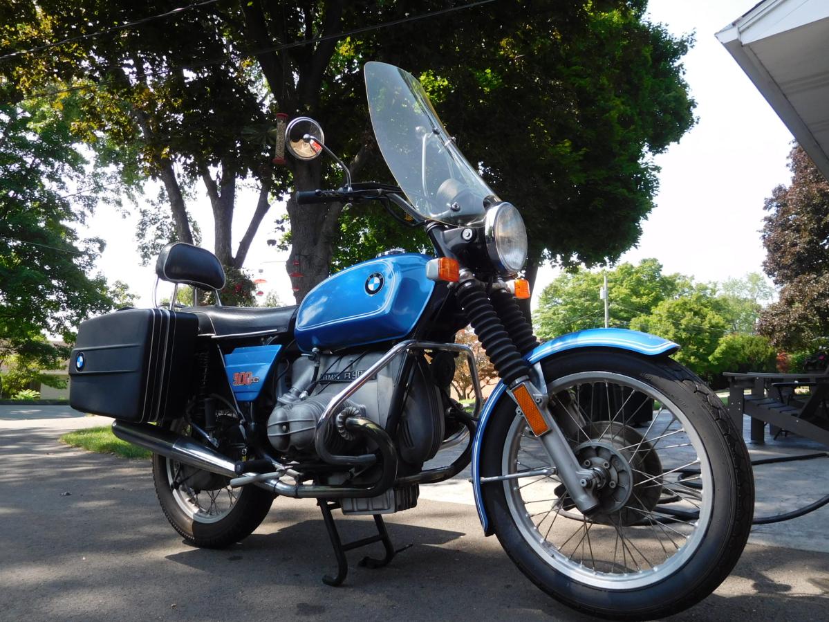

                After the rustoration.

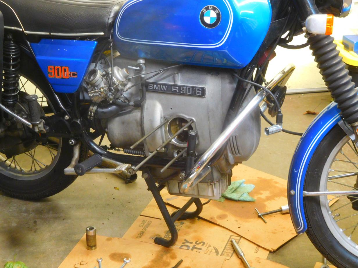

                  • 2072
                  #68

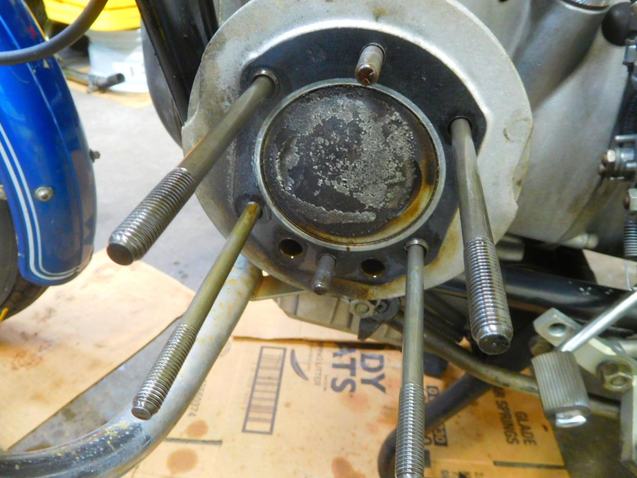

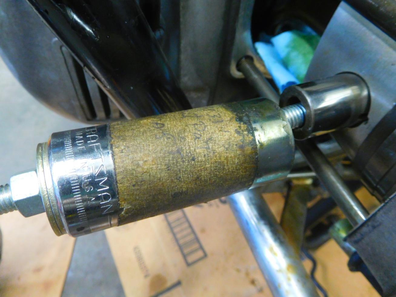

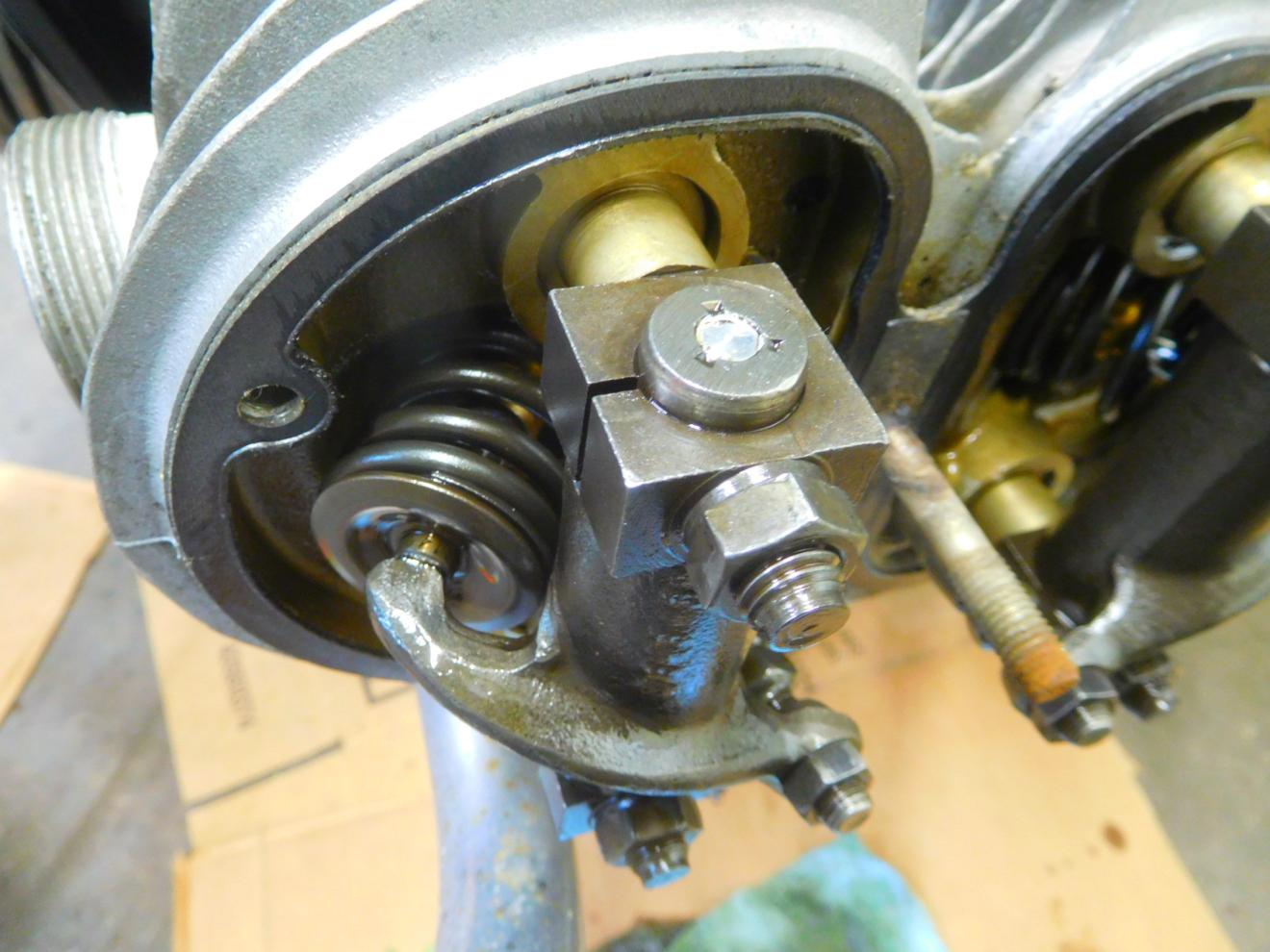

                  The teardown.
ID:	891729 Click image for larger version
ID:	891730 Click image for larger version
ID:	891731 Click image for larger version
ID:	891732 Click image for larger version

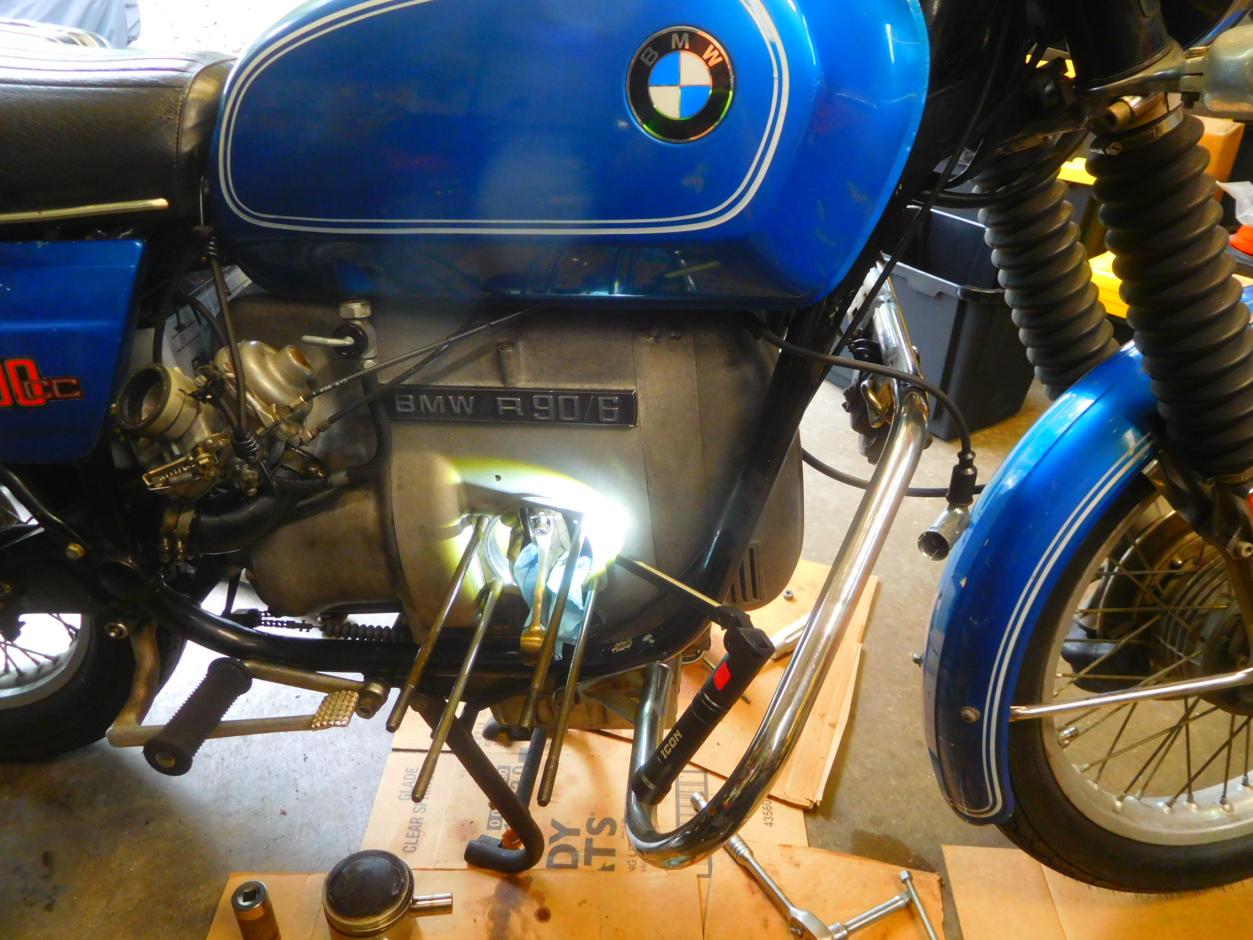

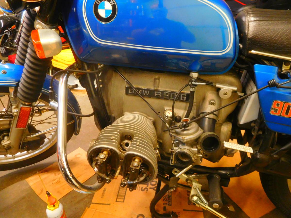

                    • 2072

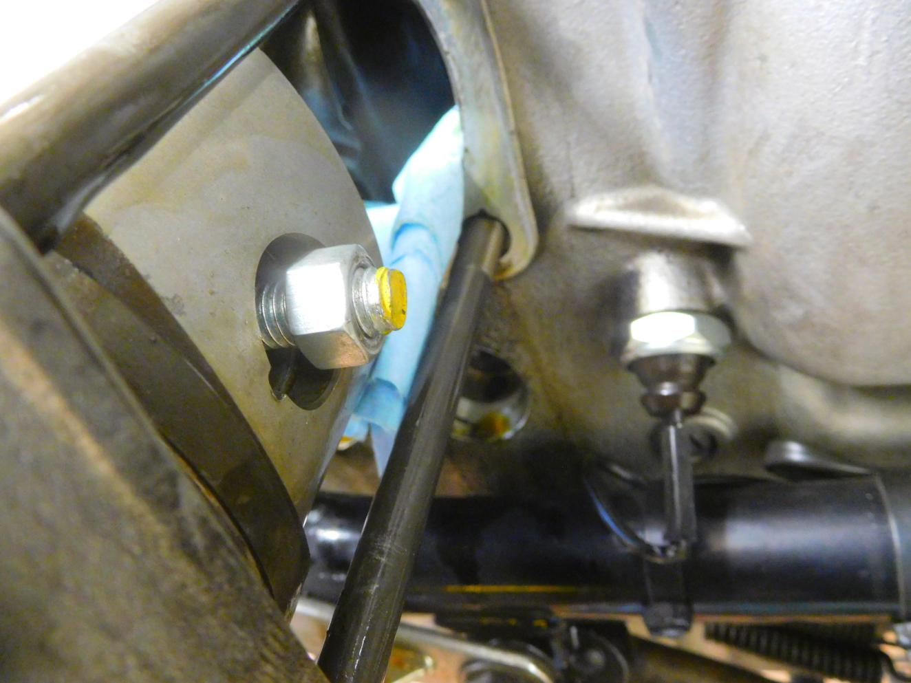

                    #69

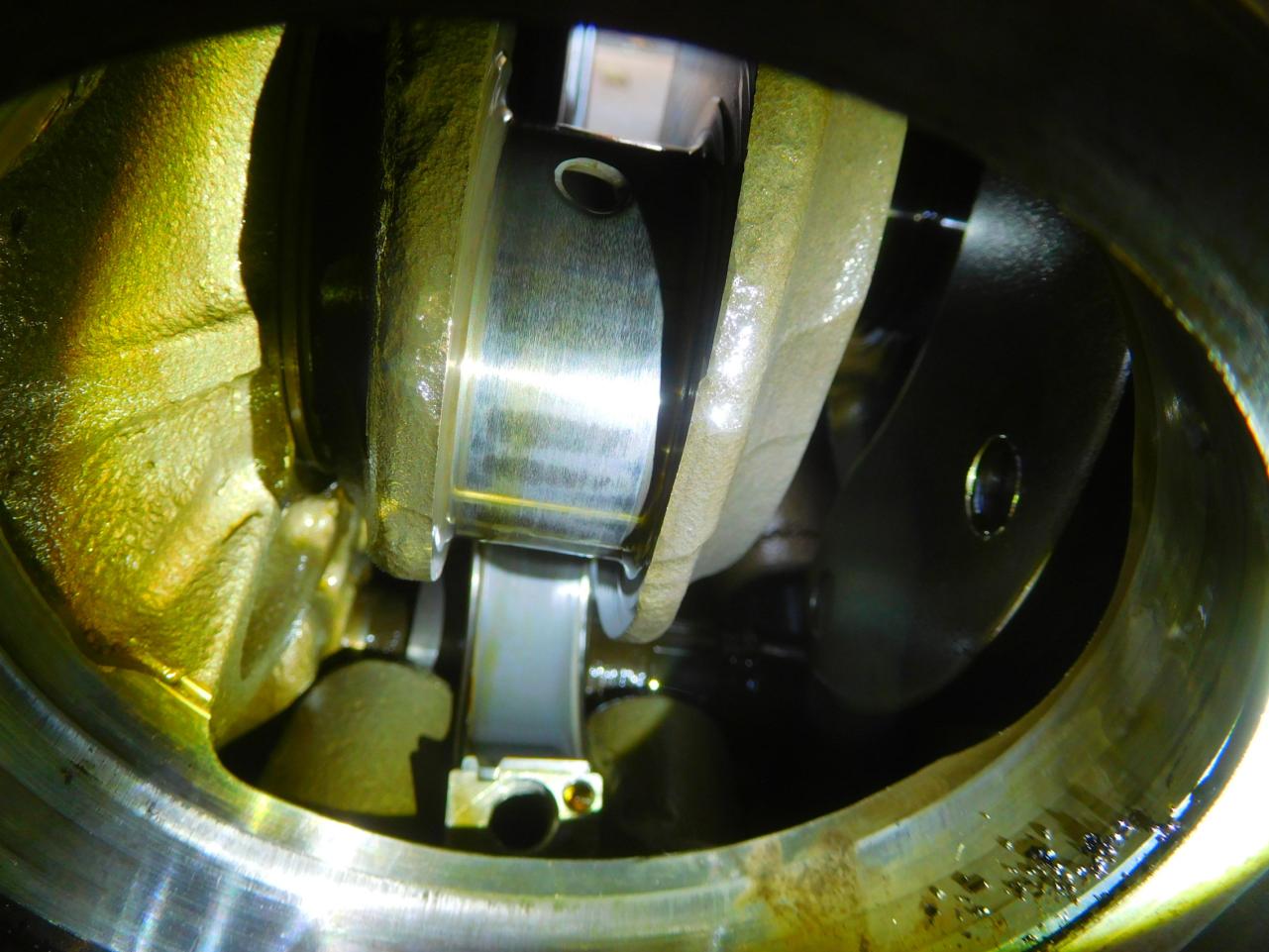

                    Down to the crankshaft.

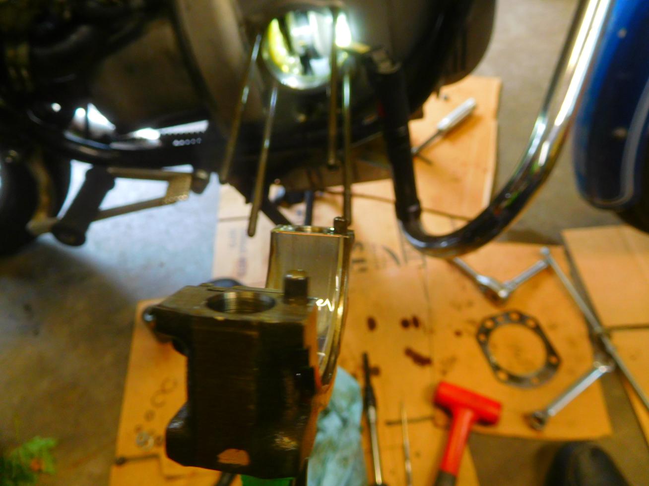

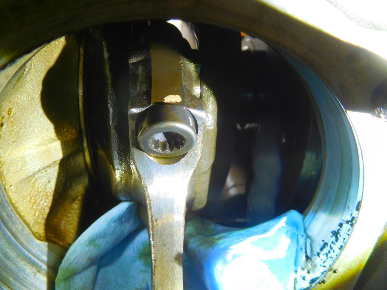

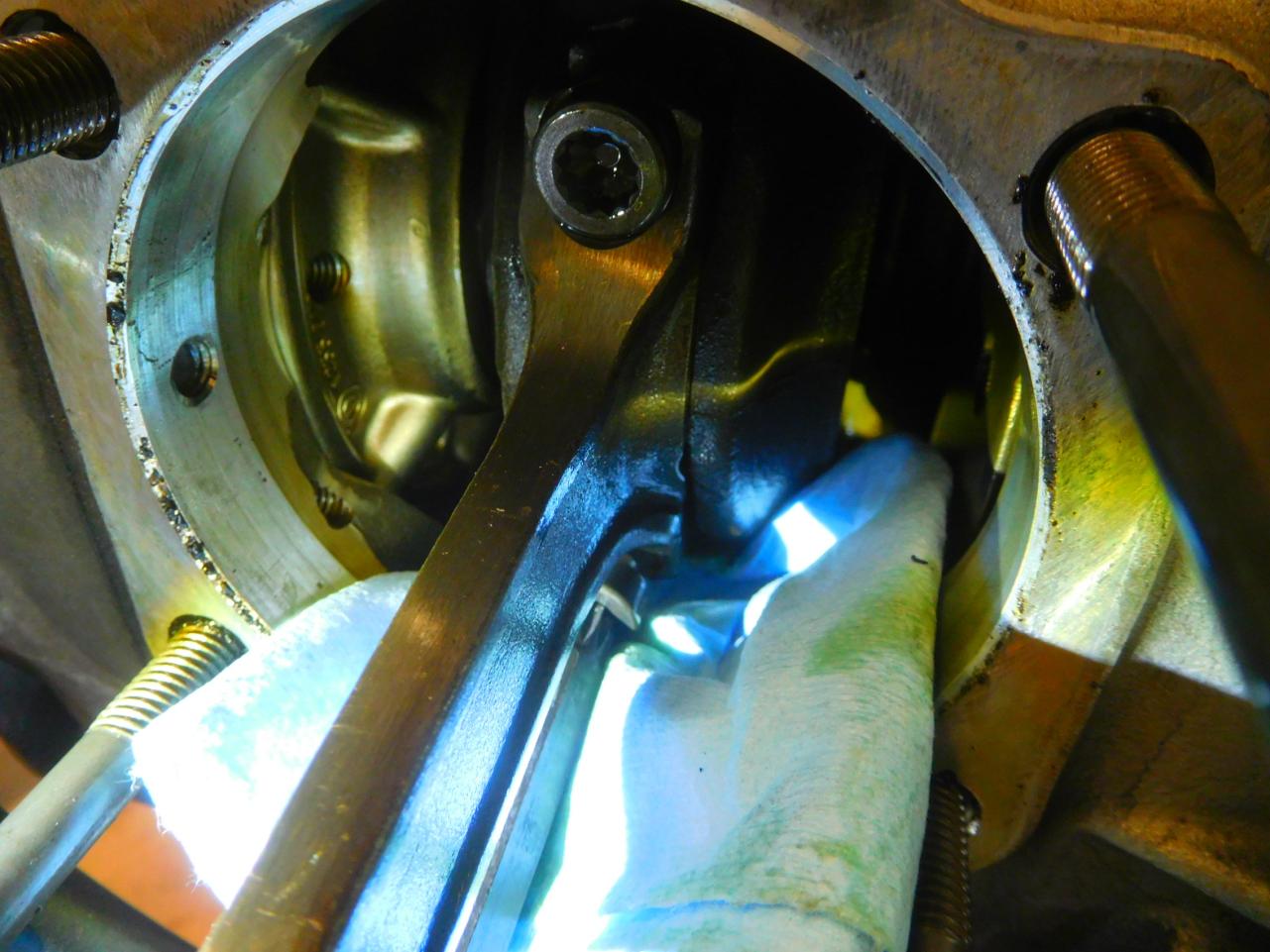

                      • 2072
                      #70

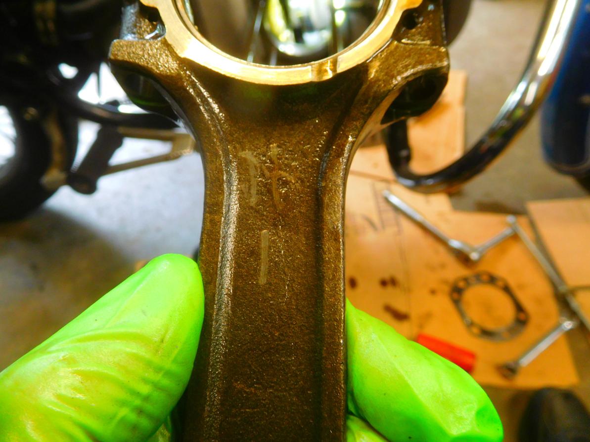

                      Connecting rods off.

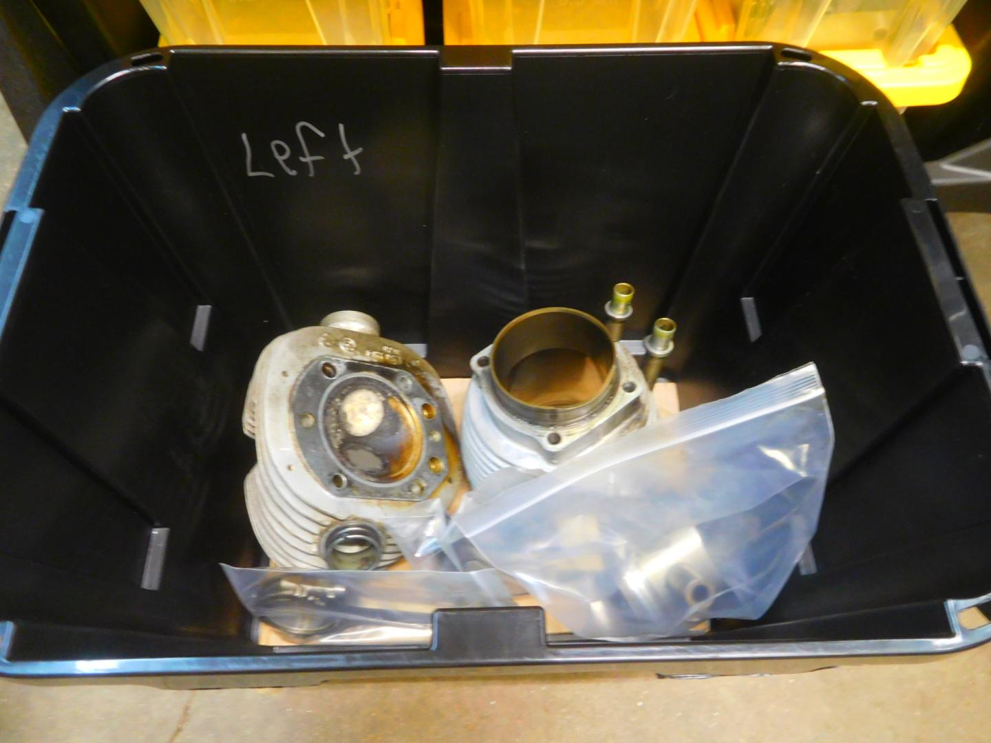

                        #71

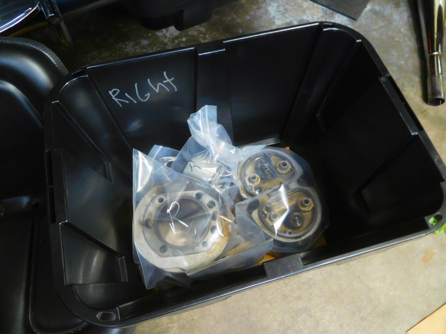

                        Kitted parts off to the machine shop.

                          • 2072
                          #72
                          All four valves are shot. The head will be rebuilt with 4 new Kibblewhite guides and valves. Rockers looked ok with the exception on left intake there was some pitting. Going to replace that rocker with a good used one. All four rocker needle bearings will be replaced. No crosshatch left inside the bore. Shiny smooth glazed. Piston ring lands were shot so they were no good. Will need 2 new pistons with a slight overbore and 3 piece oil rings to replace the BMW single oil ring which is a poor design. New head nuts. The four pushrods are good. New pushrod tube seals.

                              • 2072
                              #74
                              Mike, about 75,000 miles. I will be getting back the machined parts soon and will start reassembling. Can't wait to put some miles on before the snow.
                                • 839
                                #75
                                Being able to get that deep into the engine without pulling it out is nice!
