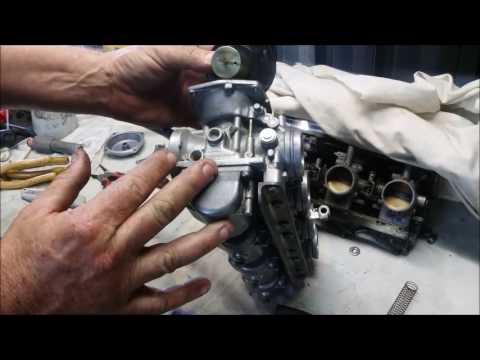

    Hi, I have looked through the carb section in the maintenance link and cannot find anything related to my question.
    I brought a spare set of carbs from eBay and have been working through stripping them and rebuilding rather than messing with the ones that work. I have just fitted a diaphragm to number one, however compared to numbers 2&3 it returns to the resting position very quickly, where as 2&3 more slowly. Any thoughts suggestions before I finish number 4

    Are you doing this test with the vent blocked?
    To post a video, upload it to YouTube. Use Click image for larger version

        Thanks for the video, I think there is a problem with number one, even with the vent covered over there is no change compared to, 2&3.

            Hi LoftCol,,,, maybe try refitting the diaphragm and make sure the Tab on the outside of the diaphragm lines up with the notch in the carb body....I usually use a bit of grease on the edges to hold it in place,,,also is the spring in ok shape,,,and check for holes in the diaphragm by holding up to a light,,,if any they can be patched but for long term, buy one....after all that try again with finger over hole and it should drop very slowly or nothing until finger is released from covering the inlet hole.....hope its simple as that,,,,,,,keep us informed, Mike in S.Diego and Pa

                  Thanks everyone, the issue was I had pinched a tiny bit of the diaphragm and was letting air through. DOH!!
