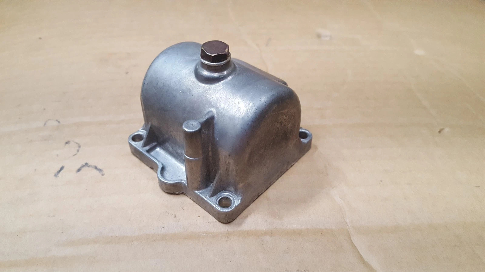

              To all: Make sure you drain those carbs by removing the plug on the bottom of the fuel bowl.

                  DEEBS11-any idea what size metric wrench? Have limited tools at my storage unit and cant find my Yamaha tool case.

                    10mm OY8.

                      Super -thanks!! I started the bike today and ran it, then shut off the fuel until the bike died. I removed the battery and didn't have a wrench only deep metric sockets that wont fit the drain plugs.

                        If you can't drain right away, which happens sometimes, the next time you are with the bike (before starting) you can remove the plugs and turn on the petcocks to "Prime" (with rags or a tray under the carbs) to flow fuel into the bowls and that will flush out any nasty sediment that has accumulated in the bottom of the bowls. Then shut the petcocks off, and return the plugs to the bowls. Now you can start the bike and not suck up any debris into the tiny jet orifices. I do this with all my bikes/equipment every spring.

                          Great tip-yes I usually drain the bowls in the winter so I don't have issues. Doesn't take much to clog up the pilots.

                            I finally drained the carbs this past weekend as they didn't plow my storage unit parking lot good, and it froze. The snow has finally melted, and this was way overdue. Quite a bit of fuel came out of the bowls. I cant wait until no threat of snow and the weather warms up.
