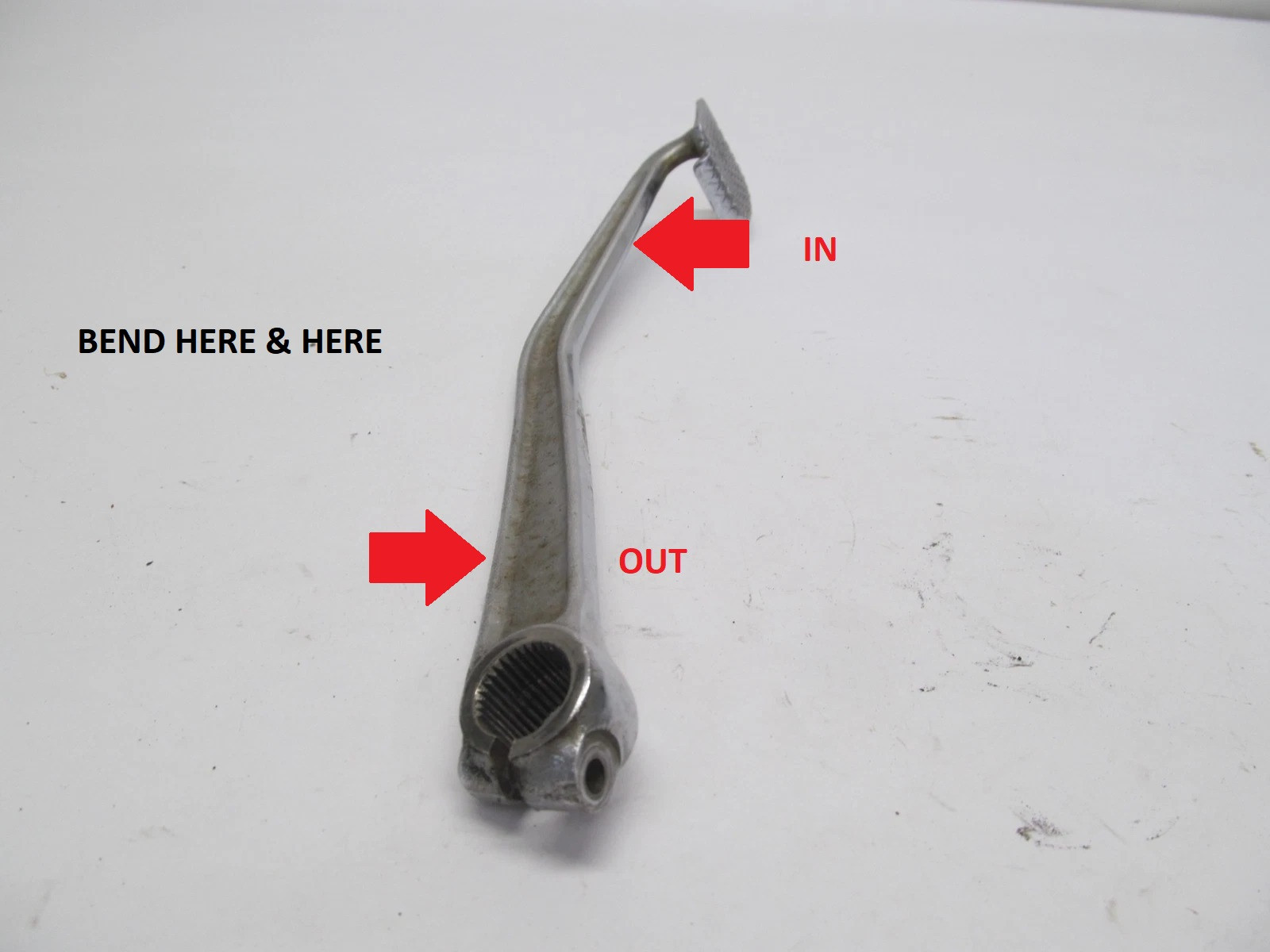

                  New issue: With the new exhaust being a bit bigger than the factory, the rear brake pedal no longer goes all the way down. It is stopped by the new pipe. I can't find any spaces that will work or even any new brake pedals that will fit this bike. I can take it to a machine shop to be bent but I really don't want to mangle an original part that is in such good shape. I would rather buy an aftermarket and replace or find some way to push out the pedal about a half inch safely. Any thoughts or suggestions would be appreciated!

                    I bent mine out slightly to clear my aftermarket pipe with no issues. The pedals are very easy to find.

                      • 2090
                      Bend at these points to re align the pedal.
