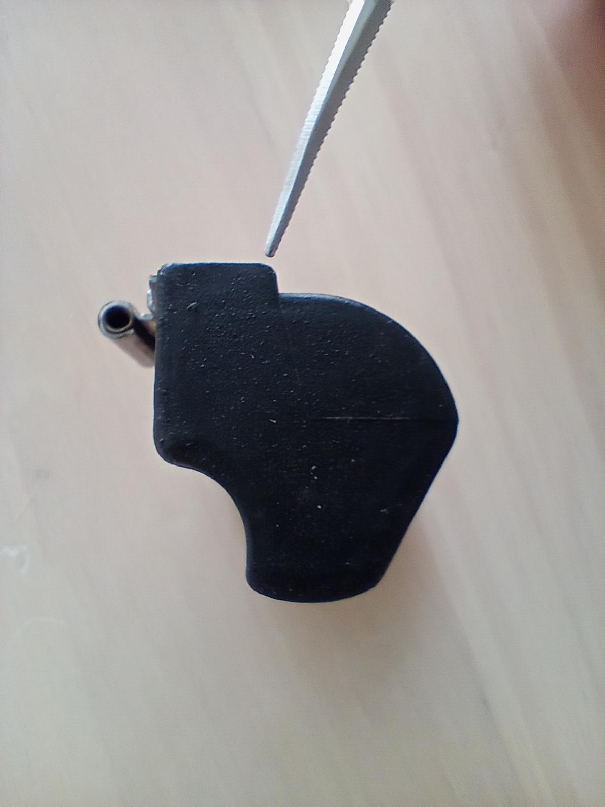

    Hi all, I'm new here, been following for a few weeks.. I have watched alot of videos about cleaning the carbs and my set has something I have never seen before and wondering if when I put everything back together if they go back... it some sort of plug.. I wonder if the previous owner bought a set of carbs new and didn't remove these?
  • Tematt
    • Nov 2023
    • 33
    • Colorado
    This is off a 1980 XS1100G
      • 8938
      Ok, if your carbs have a passageway between the two towers, it will need that rubber plug. No passage, no plug needed. Check all 4 carbs, previous owners may have switched one or more carb bodies over the years.

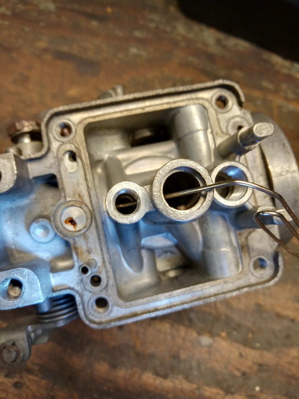

          Thank you! I do see small passages, but trying to figure out how to remove that brass tube. I recall a youtube tutorial, but not confident in it unless i can screw it out lol

            Hopefully this helps someone, the emulsion tube (if cruddy like mine) is easily removed if you put a heat gun on it for 5secs. bikerphil there is a passage way.

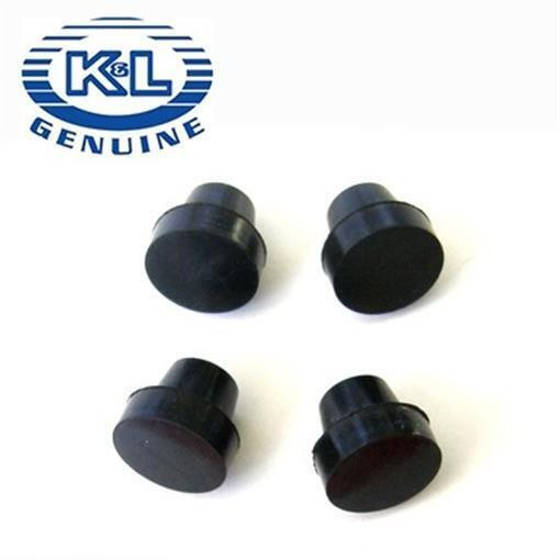

                        Hi Tematt. Welcome to the forum. If anyone is looking for the rubber plugs needed on some versions of the later XS11 carbs, here is a resource:
                        https://www.ebay.com/itm/29349348355...Bk9SR5r9kq6DYw

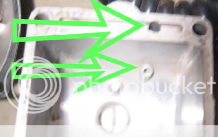

                          does the choke plunger (levers) come out? 14mm nut.
                          They won't come out without splitting up the carb bank and removing the long choke rod. You will probably be ok without doing this. Just make sure the starter jet passages in each bowl are clear.

                              A follow up to bikerphil's post. Looking at the picture of the float bowel, put the spray tube of carb cleaner into the larger hole and spray. The spray should shoot out of the smaller hole. USE SAFETY GLASSES when doing this!
