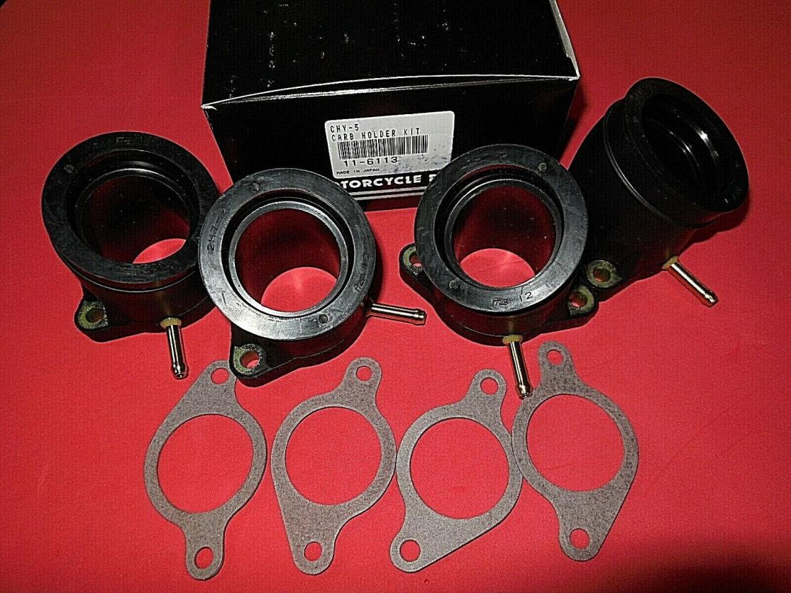

            Rubber manifolds. You can ditch the gaskets like Cajun31 said.
            https://www.ebay.com/itm/361850795811

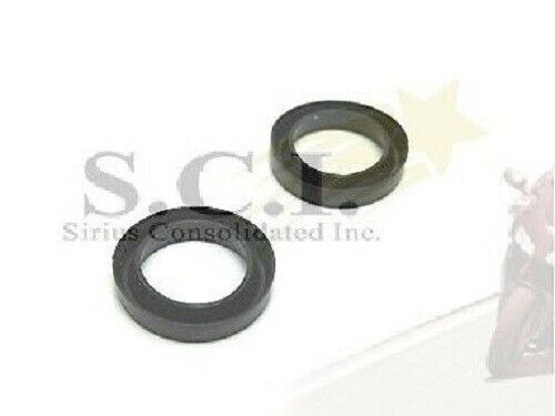

              Carbs seals. Qty 2. You will need a few sets to do your carb rack.
              https://www.ebay.com/itm/291732072322

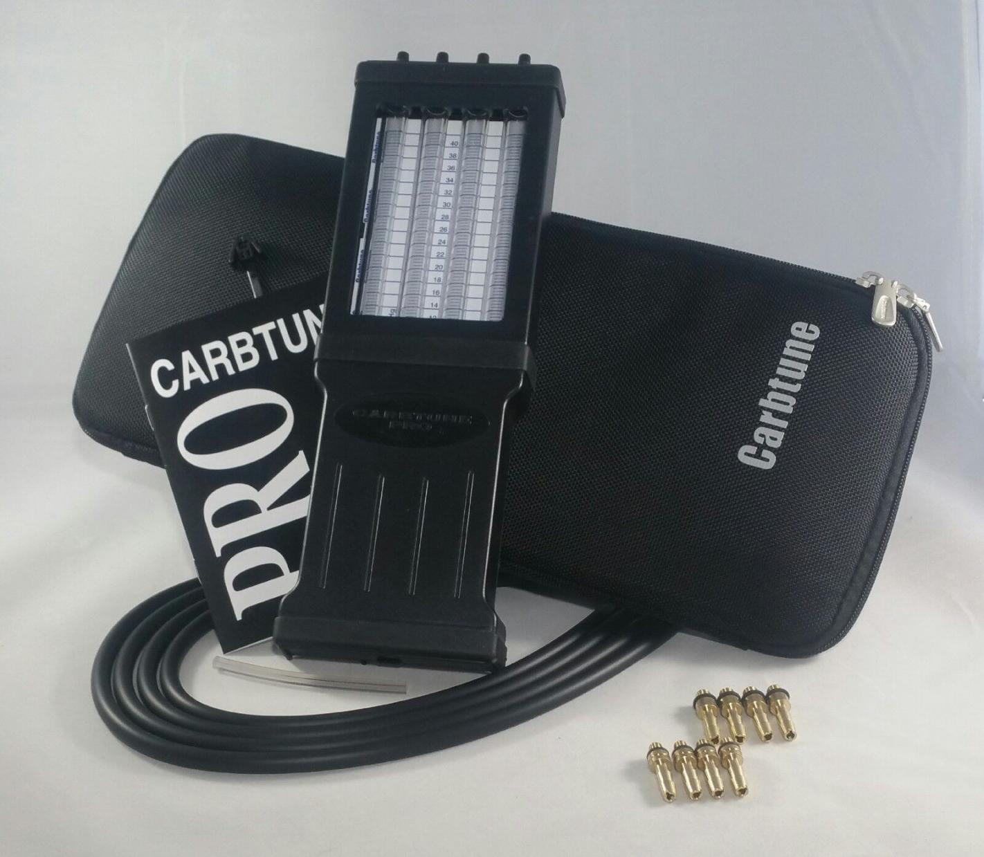

                The best carb tool on the planet (and I have used them all).
                https://www.ebay.com/itm/222463312429

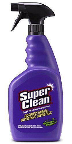

                  • 1918
                  This is my secret to cleaning carbs. Used on hundreds and hundreds of carb cleaning jobs from chainsaws and lawn mowers to antique BMW, Indian, and Harley restorations. It will not harm rubber. I use it with hot water. Much more powerful than Simple Green. Great for cleaning outside of engines too. Been using it since it was called "Castol Super Clean". About 30 years.
                  https://www.ebay.com/itm/16642201033...Bk9SR9z0nPuDYw

                      Those of us that have been around awhile know that knock off parts are often more trouble than they're worth.
                      I've seen PLENTY of intake boots out there that go anywhere from $30 to well over $100 such as the ones deebs linked. My question is are the more expensive ones really worth the extra money? Georgefix has a great rep for selling decent quality parts on eBay and he also has boots that go for half that price so my question is, are they really worth spending the extra money on?
                      Same with diaphragms, there's cheap and more expensive ones. How do you know which ones are worth passing on and which are worth buying? Seems to me best ones are the ones that have been tested by someone who's actually bought and used them.
                      I've been putting off tearing into my carbs for far too long and more than likely will be doing that in the next month or two. Now I know that genuine Mikuni is the way to go but some things can be just as well accomplished with more affordable parts, right? After all it seems to me that a viton oring is still the better choice despite who's name is on the package.
                        • 8847

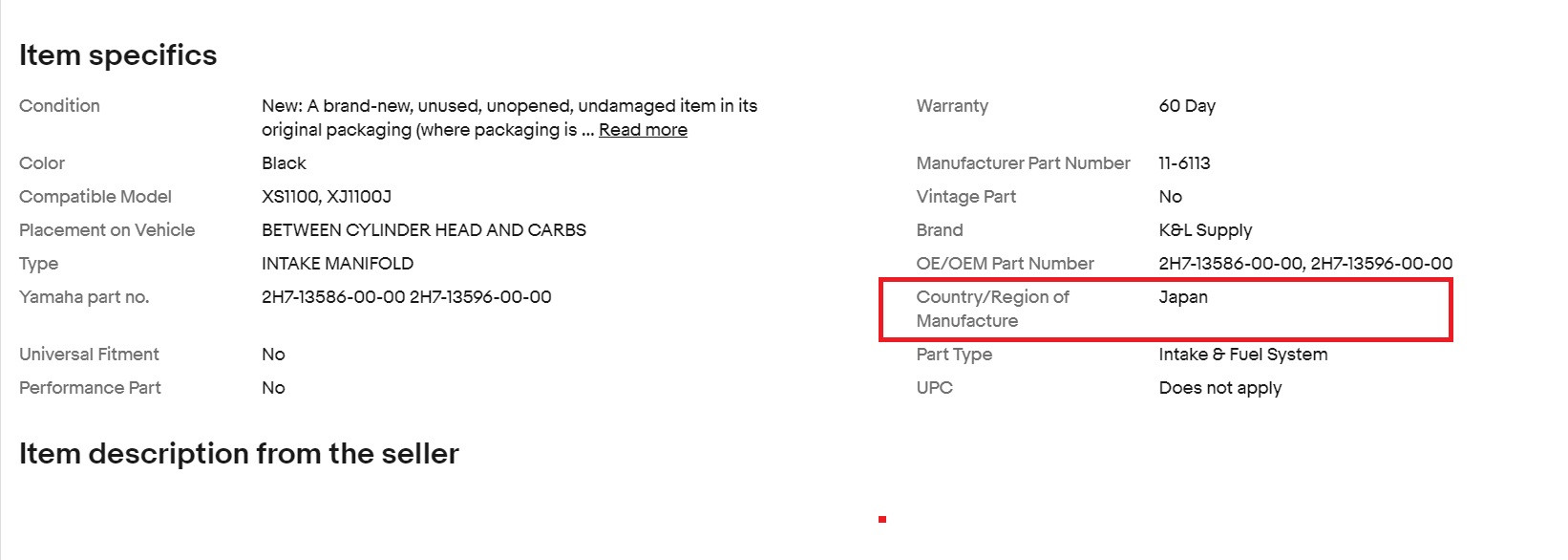

                        My experience with the cheap carb intake boots is that the sync tube ports will come out when you try to pull the rubber cap off. It seems like the internal metal under the rubber is much thinner. You can actually see how flimsy they are when they get hot, you can see them pulsating with the suction of the piston intake strokes. A real bad idea using these too if you are running pod filters with nothing extra supporting the carbs.
                        IT seems like the decent quality ones, such as TourMax
                        are made in Japan, not China.

                          • 1918
                          As I have written many times, avoid the cheap Chinese parts (especially rubber parts). I always try to source Japanese or American manufactured parts. It's getting real tough these days.
Name:	Georgefix XS11 manifolds.jpg
                            Lot's of folks don't like the morgan carbtune's but I am one of those that give them a thumbs up. I also recommend and use the colortune. If you go that route these old bike like just the hint of orange instead of the blue recommended. Gunson Colortune See Through Spark Plug Kit (gunsonshop.com) thread size is 14mm and they are usually out of stock.

                                I don't know who has the carb diaphrams, I was referring to the engine side intake boots...
                                https://www.ebay.com/itm/27269541451...Bk9SR6KKx7OEYw
