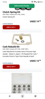

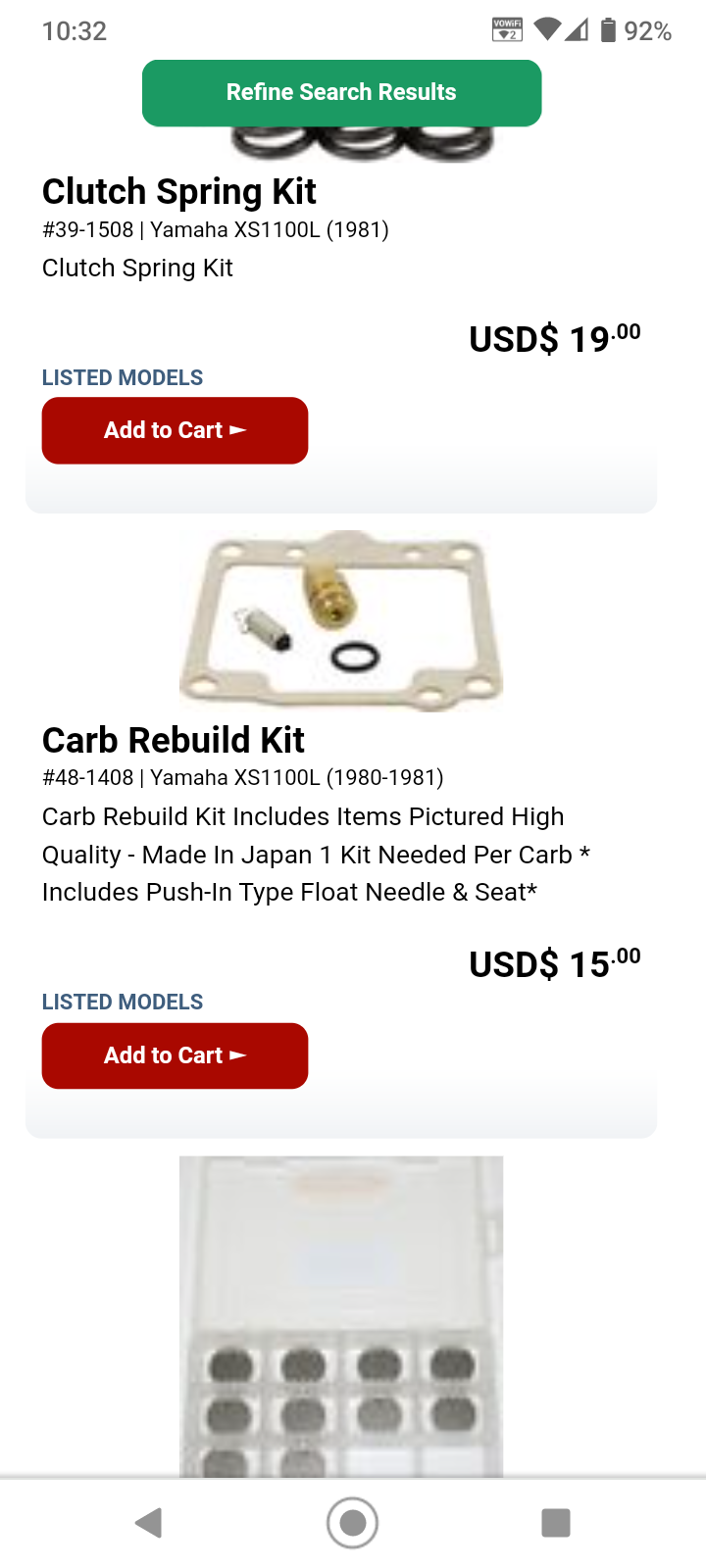

                Parts 'n more in Canada has the basic rebuild kit for the late carbs... Click image for larger version
