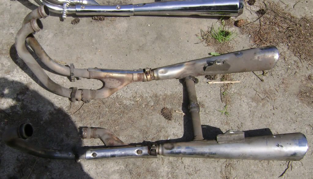

This is the 'standard' exhaust, used on the '78-80 standard bikes (NOT the '81 standard). Markedly different from any other, the most obvious difference is the large 'tuned' crossover and length. Longest of the OEM systems at about 50", these also block access to the rear axle when installed. There's a cable arrangement for holding the swingarm up when removing the axle on bikes fitted with this exhaust. These also have non-removable heatshields, they're welded-on with these (the non-US versions are removable). This system can be fitted to all other models, but fabricated muffler mounts will be needed.

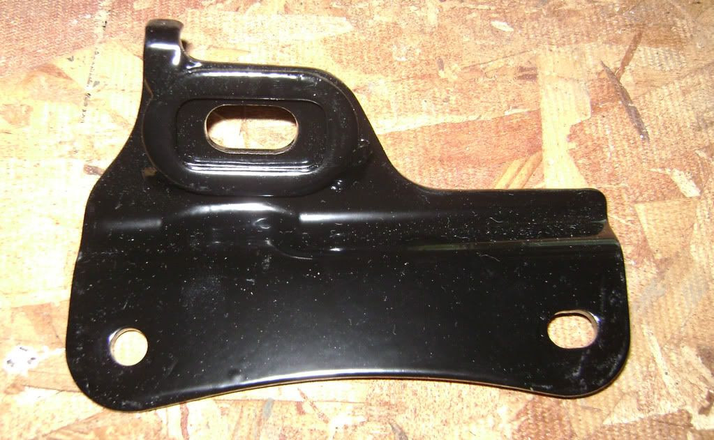

Stock standard rear muffler mount. These are the only ones not welded to the muffler.
The 'Special' exhaust. Used on all '79-81 Specials, the '81 standard, and with a black finish, the '80-81 Midnight Specials. This system is about 7" shorter than the standard system, and considerably lighter than the standard (I suspect this is the entire weight difference between the two models). This has shorter mufflers, spead further apart, so these require exhaust-specific side and centerstands. Another difference is the mufflers angle up at the rear, preventing these from being used on 'standard' models (more on this below). Both the standard and Special exhausts are one piece from the outside head pipes all the way back; replacing parts means welding.
The XJ exhaust. Really just a variation of the Special, and fully interchangeable between them as complete systems. Slash-cut mufflers are a design difference, and the mufflers are no longer welded to the collectors. Slightly longer than the Special system (about 1 1/2"), mostly due to the slash-cut. Only sold in the US for one year ('82), through '84 in Canada so these are hard to find.

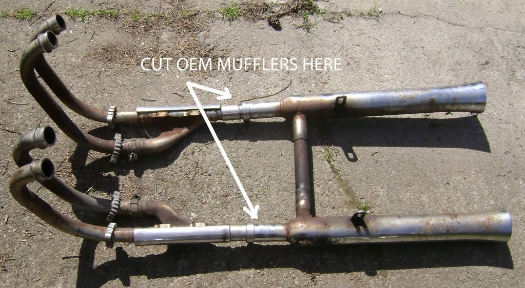

This is the 'hybrid' Jardine 'slip-on' mufflers. This is the only aftermarket exhaust that used the OEM headpipes/collectors, being designed to replace rusted-out mufflers. Sometimes mistaken for OEM, these also were the only non-OEM exhaust to feature a crossover. By cutting the stock mufflers off in a certain place, these could be installed on the 'stub'. These were designed for use with standard exhaust, additional mods will be needed if you try to install these on Special pipes. If you have set but no directions for installing, look here: Installing Jardine 4 into 2 Slip-On Mufflers

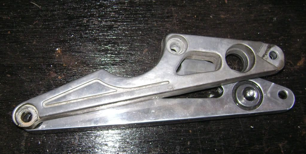

Rear footpeg/muffler mounts. The '78-80 standard unit is at the top, the Special/81H/XJ unit below. There is one variation of the Special mount; the one shown is for '81/XJ bikes, the '79-80 Special piece didn't have the 'detail' line molded in as shown. Also note that the standard mount has the brake pedal pivot as part of the mount, the special mount is cut away for the frame-mounted pivot on the other bikes. These do not interchange.
Here's why you can't swap any Special/XJ exhaust onto a '78-80 standard bike. This is how the mounts fit in relationship to each other on the bike; the special mufflers will hit the lower-hanging standard mount before getting up into position. None of the holes line up either...

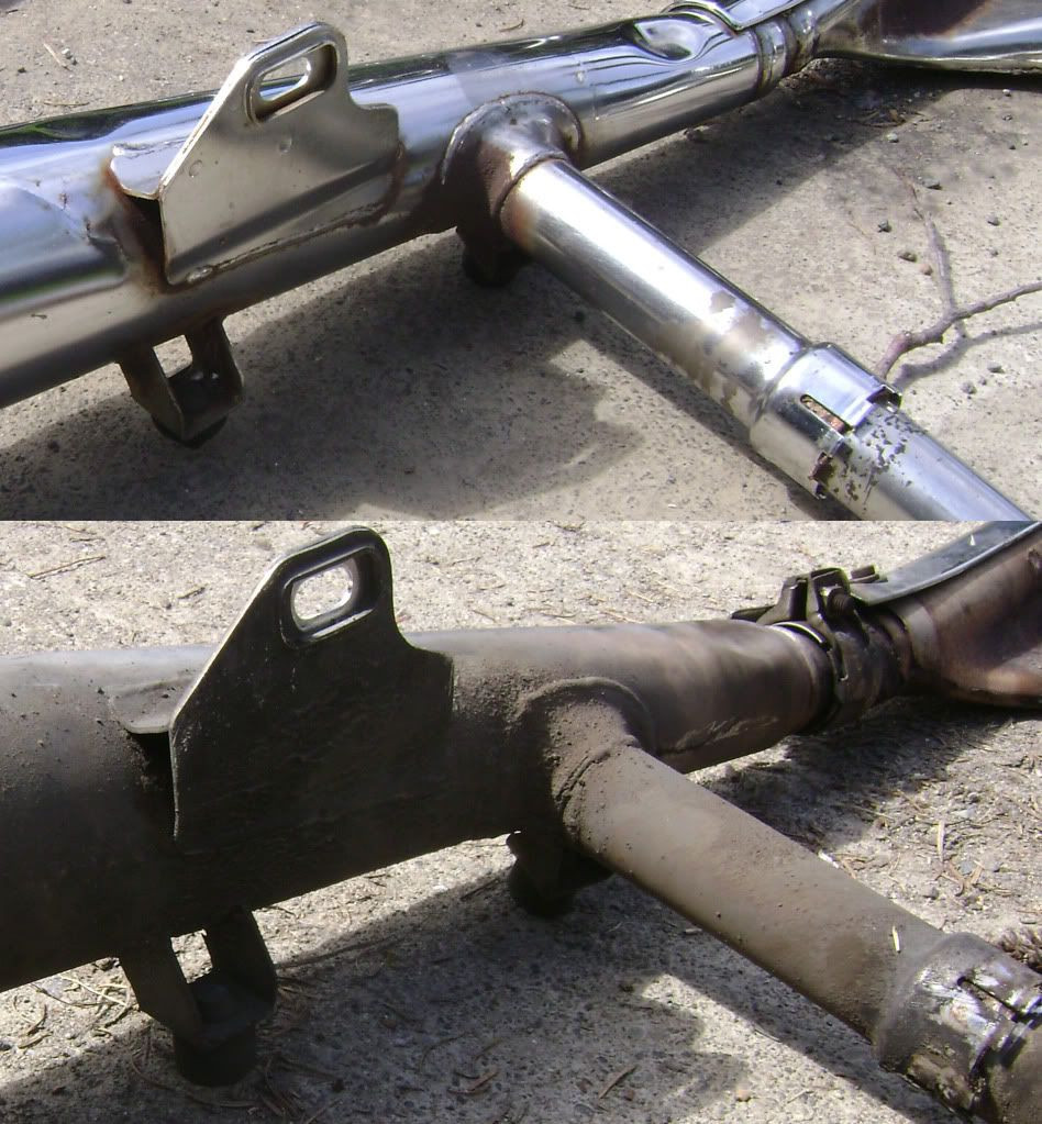

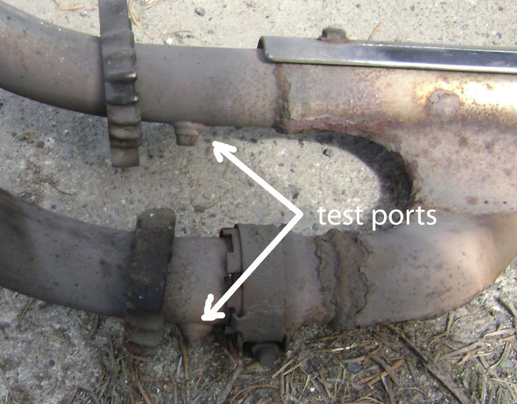

Here's some variations between years. Above is the 'test ports' fitted to later exhaust systems. I believe these were fitted first in mid-'80, and were used to end of production. Just a small hole, sealed with a bolt.

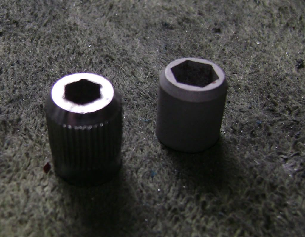

Another small difference; two different type exhaust nuts. The one on the left was used on the '78-79 bikes, is chrome and uses a 6mm wrench. The right side is the '80-up bikes, zinc plated, and uses a 8mm wrench.

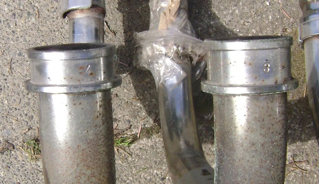

This variation makes a difference. Yamaha fitted two different flange lengths to the head pipes as seen here. The longer flange was only fitted to standard exhausts, and only the '78-79 versions. The '80 standard got the short flanges. I'll note here that the inner 2/3 headpipes are interchangeable between all OEM exhausts, but you do need to check if the flange matches. There's a 1/4" difference, and if swapping exhausts or motors, the exhaust studs can be either short or long depending on the combo. If you run into this problem, this is why...

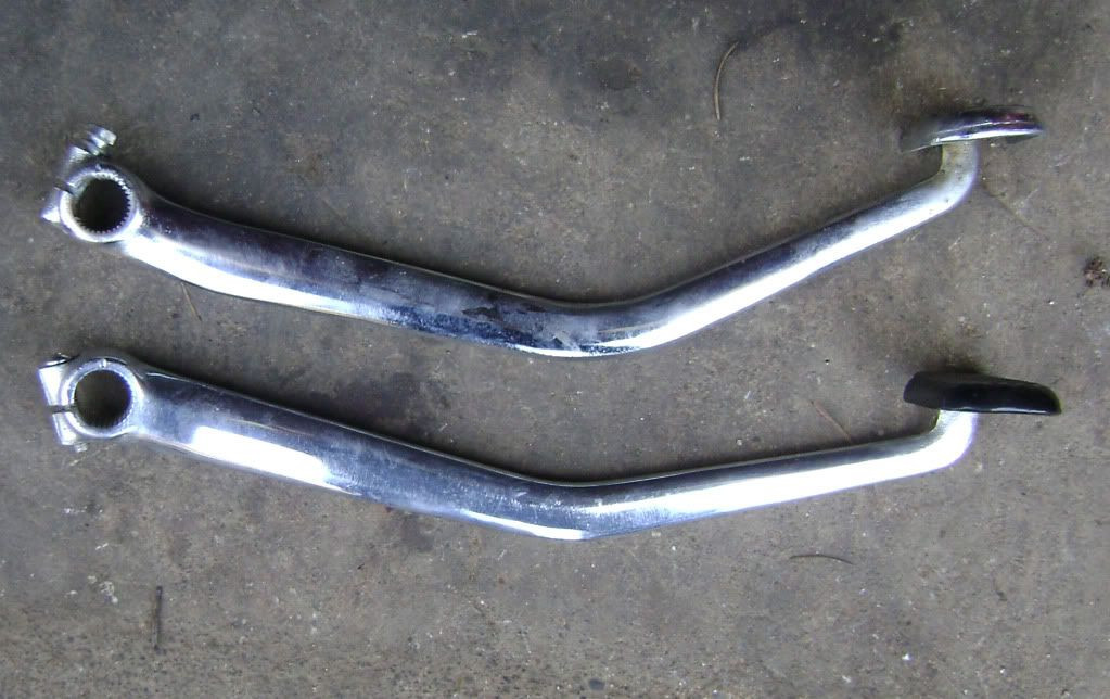

There's two different brake pedals also. Because of the relocated brake pivot, the Special pedal (top) is slightly longer and more curved to clear the footpeg. These can be interchanged, but fit and adjustment won't be the best.

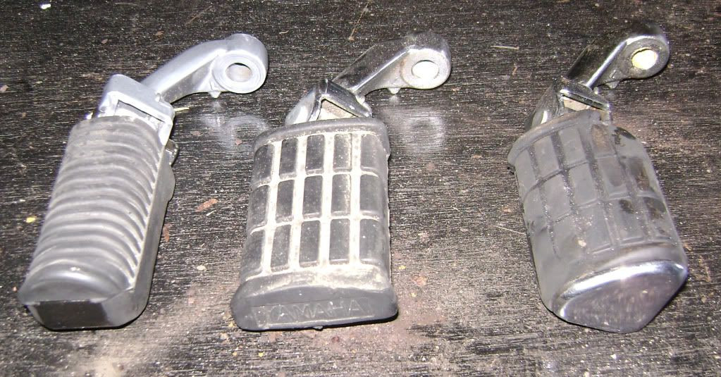

The footpegs are all interchangeable, but there are style differences depending on year. Left to right, you have '78-79, '80-81, and XJ. These are fronts, the rears are similar. One other difference is the mount is painted black on all the standards, and chrome on the Specials/XJ. The rear footpeg parts are all painted/zinc coated on the '78-80 XS bikes, chrome on the '81 XS/XJ.
