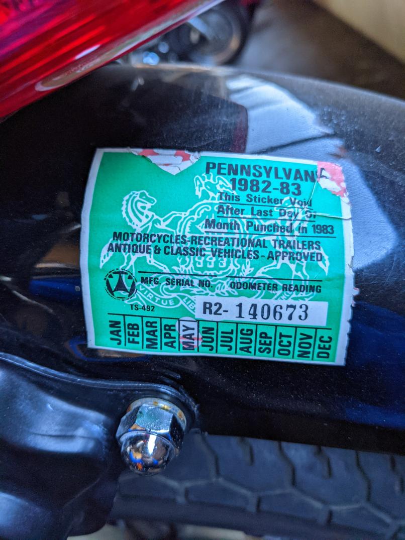

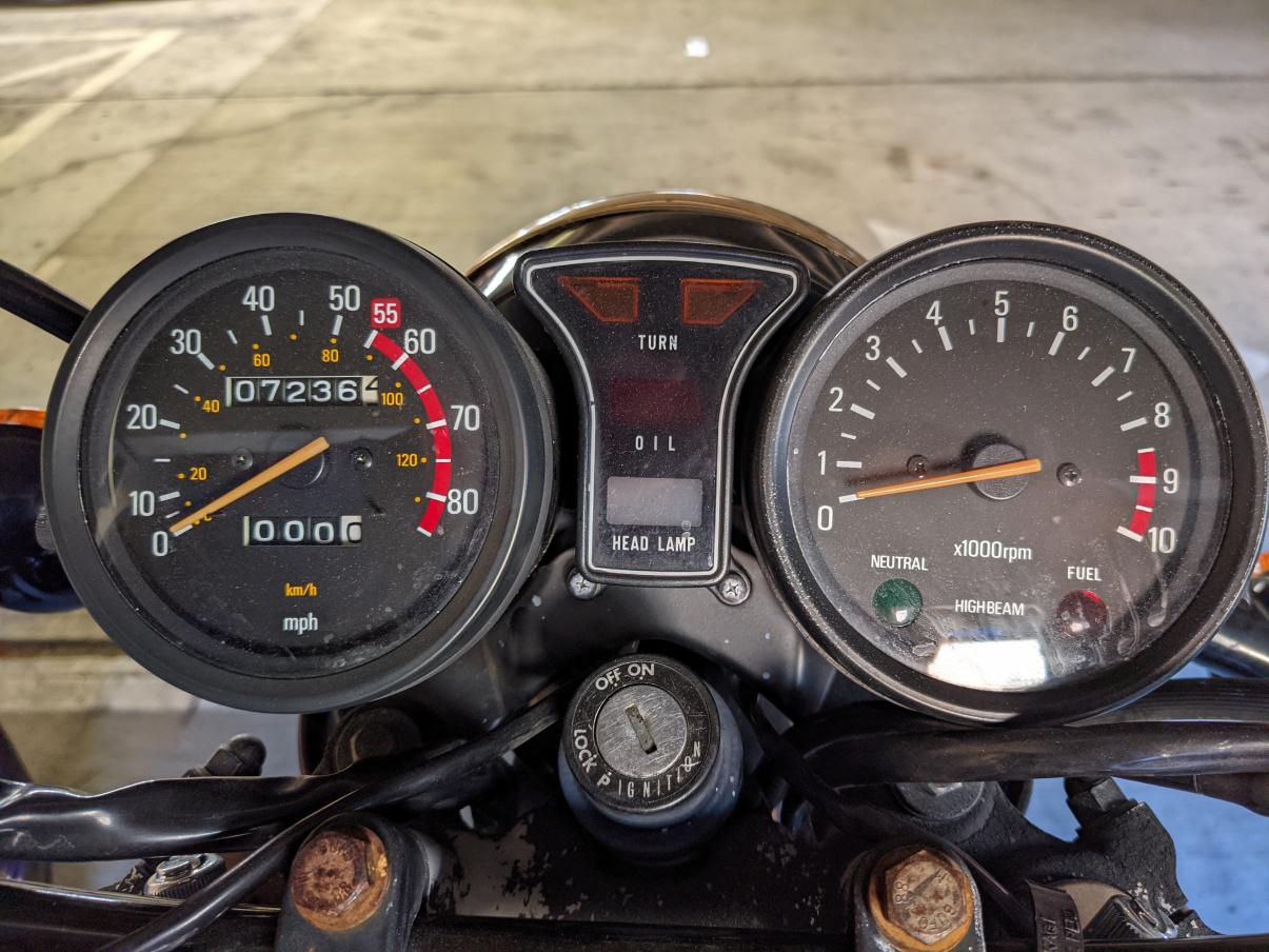

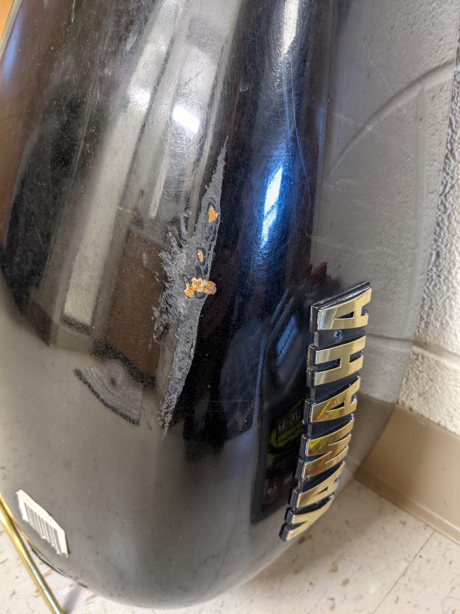

    As far as the cosmetic items go I'm not worried about the scrapes, dings, and bent items at all. My plan is to keep the bike as stock as is feasible (minus safety items like brakes, brake lines, etc.), with the possible exception of the bars as I'm really not yet sold on the swept back ones it came with. Also pictured are the gauges and an inspection/registration sticker that's still on the rear fender.

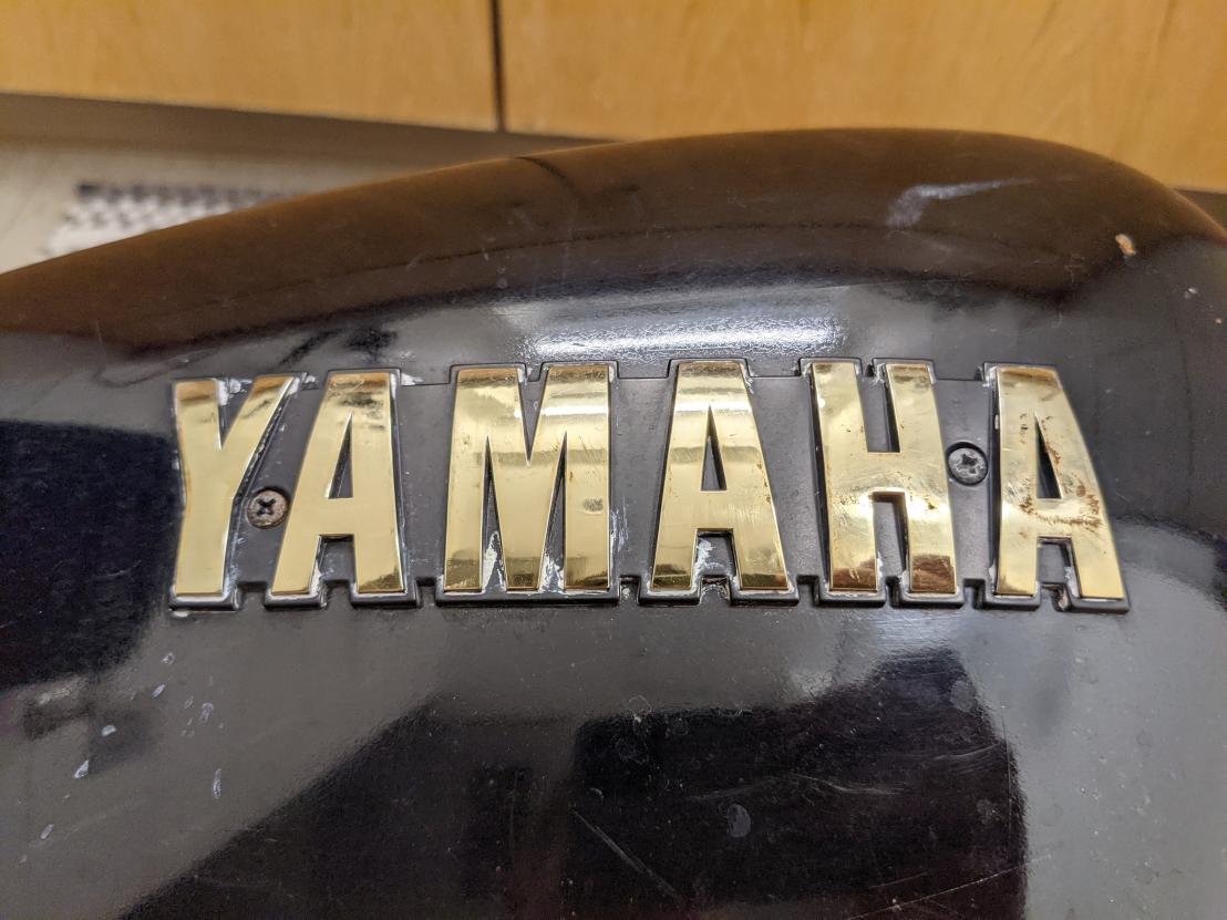

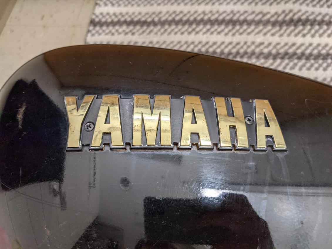

        The tank emblems are pretty solid, no real cracks or chips and the white gunk on them just scrubs right off. I wish I had the set up to do painting, but such elaborate setups in barracks rooms are highly discouraged....
            that white gunk is old wax. Someone got sloppy putting the wax on and taking it off it seems. I agree with Bob.... that bike is in too good of shape not to bring it back to factory original. Of course it is your bike and you will do what you want with it and rightfully so. Good luck with it and we are still here to advise and help if needed.
