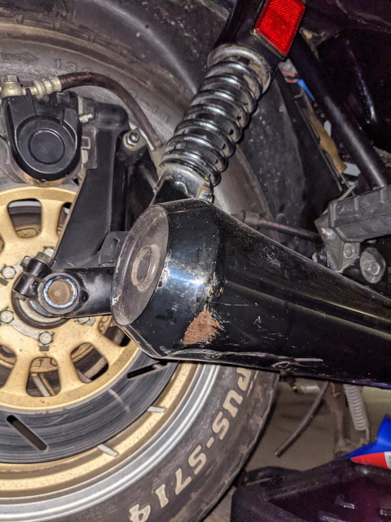

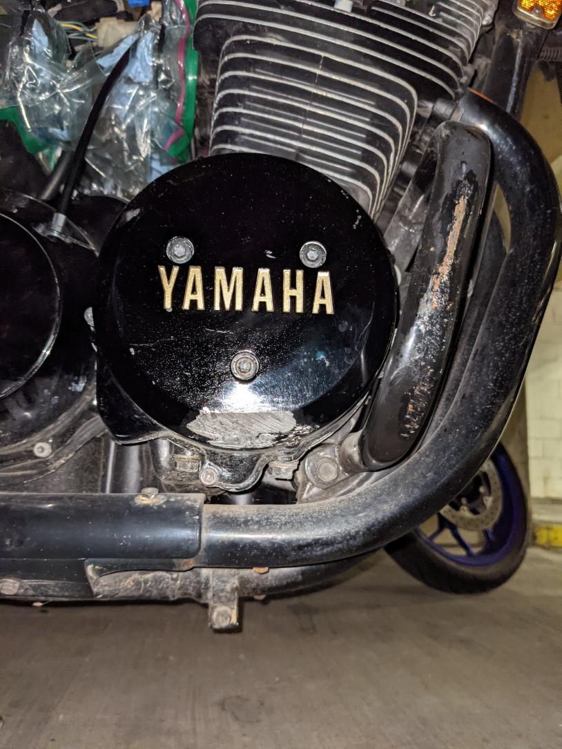

                        Small update here as I took some pictures while walking past the bike in the parking garage this evening, pictured is the scrape on the right side of the exhaust and the scraped case on the right side as well

                          • 2011
                          Those crankcase side covers are not the right ones for the 81 to begin with. Don't get me wrong they fit and work ... just not what was on the bike originally. Here is a picture of what came on the bike. Notice the grooves in gold along the edge. Kind of hard to tell from my photo but they do have grooves. On the 80 models there was a decal. I suspect that is what you have only they are just missing the decals. You will probably end up having to braze that muffler and cover that with some high heat paint. Looking at your first picture it looks like the headers are pitted too. Might want to consider having the pipes cerakoted like I did a couple of mine. Fortunately the mufflers don't get near as hot as the headers.

                            • Str8Legs
                              • Nov 2021
                              • 17
                              • Washington, DC
                              The covers aren't currently leaking and that's close enough for the girls I go out with. I double checked the left hand side one and it matches, no groove on either of them. Double checked the title too and it does read 1981. Would there be a chance that they are original to this bike and that the year of sale or date of production would be affecting that? I.E. it was made at the very end of the run of 80's but there were still parts laying around at the factory when the year ticked over or maybe 81 is when the paperwork/import went through?
