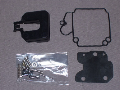

        would it be in this?
        SIM YAMAHA is your dependable, affordable, knowledgeable, authorized USA Yamaha marine outboard motor and YAMAHA OEM outboard motor parts, Yamalube oil and accessories dealer for two-stroke, four-stroke and jet pump motors.

          I think he is looking for the equivalent to one of our air/feul screws or idle screws. the rebuild kit you linked to Jeff are all internal parts.

            oh crap I thought that spring was the one for the outside screw, I see it now.
