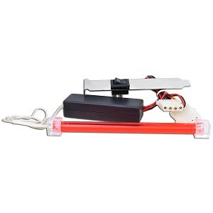

        What makes you think it's the transformer, and not the bulb? I'm not skilled in the art of troubleshooting fluorescent lights.
        I would like to pose another option for you: CCFL Lights. They are used to back-light some LCD displays, and computer enthusiasts sometimes light up their cases with them. These kits are available, and for a reasonable price. However, I couldn't find a 8" kit.
        Here is a kit with two 4" bulbs:
        http://www.amazon.com/Logisys-Dual-C...d_rhf_se_shvl3
        http://www.amazon.com/Dual-inch-CCFL...pd_sim_sbs_e_3
        Single 6":
        http://www.amazon.com/Nincom-CCFL-6R.../dp/B0057ISOS0
        http://www.amazon.com/Nincom-CCFL-6G.../dp/B0057ISO08
        Or buy bulbs and inverters separately (the 196 or 205 mm unit might work for you):
        Anyway, I just wanted to toss out that option.
