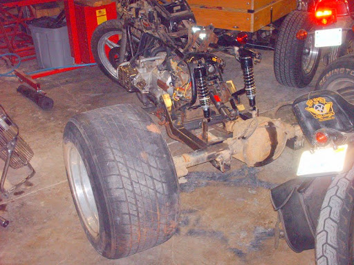

              If i can find it i will post a link to a pic of a guy who did one out of an old gold wing, used either a chevy s10 or ford ranger rear end, what he did was make a swing arm that bolted to the outside of the fame and just came back to the rear end and conected it, used motor cycle shocks for the suspention, i will look for the pic

                trike pic
                Hope this works, just figured out yesterday how to post links to pics, not a real good detail of it but may give you some ideas.

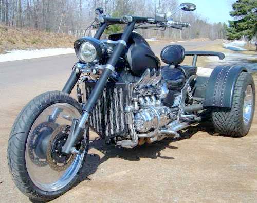

                  here is another pic of one i realy like, a honda valk. I beleave, i have been thinking about building one myself, have got some rear wheels and tires and the rear end but i got plenty of unfinished projects got to take care of first.
