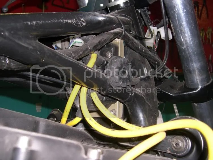

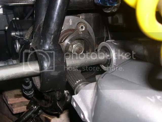

      Here a pic of the start of the project. Notice the distance between U-joint and shaft in swingarm..
      Click image for larger version  Name:	dscn0364a.jpg Views:	0 Size:	79.8 KB ID:	876472

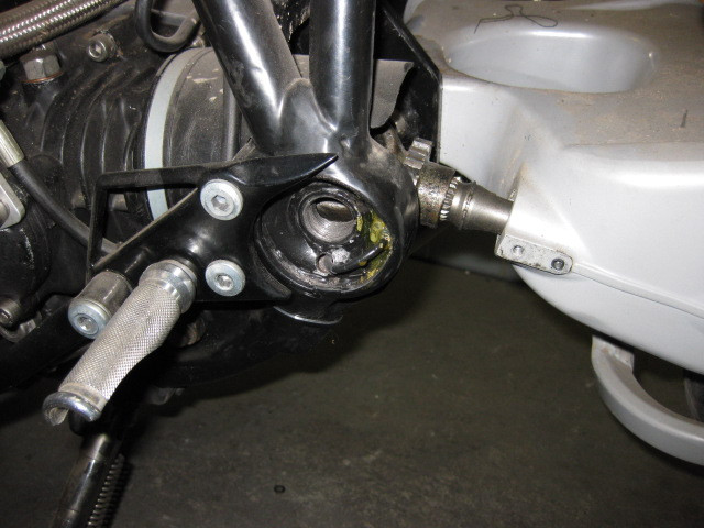

      Because of the different swingarm construction the left frame pivot point has been deleted as such and the frame has been modified to accept the new axle pivot point. A 3cm wide spacer was needed to get the middle drive gear inline with the shaft.

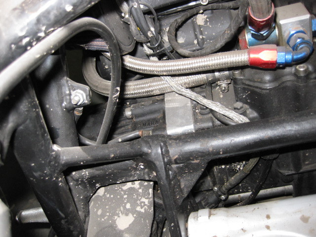

      Click image for larger version  Name:	alles 363.jpg Views:	0 Size:	113.7 KB ID:	876470
      Deleted stock swingarm pivot point ... now houses the speedo drive sensor..

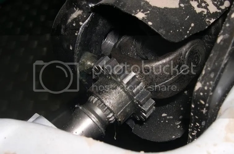

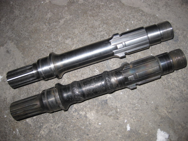

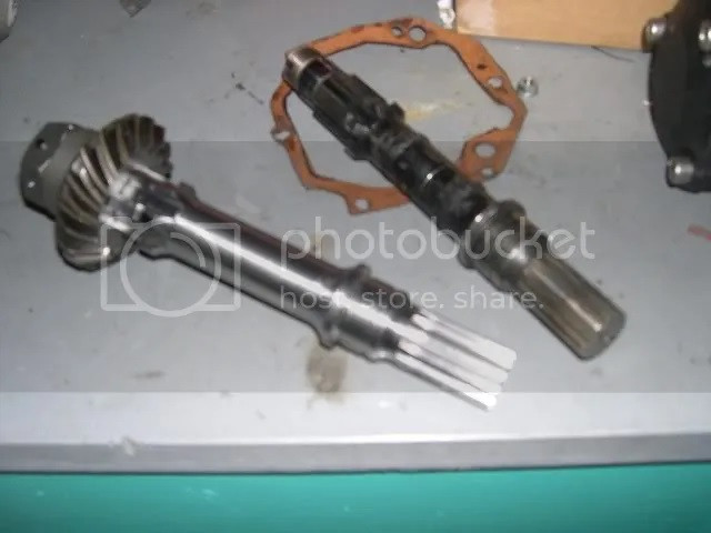

      Two longer middle drive gear shafts... one lengthened by welding, one completely new one-off. Both 3cm longer than stock.
      Click image for larger version  Name:	alles 367.jpg Views:	0 Size:	114.6 KB ID:	876474

                New lenghtened middle drive shaft (the one on the left)
                Click image for larger version  Name:	DSCN1828a.jpg Views:	2 Size:	51.4 KB ID:	876476

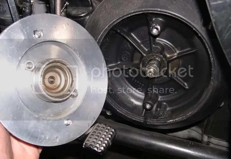

                Hydraulic clutch engagement. Just made a small adjustable adapter between the cylinder and clutch actuator to fill up the gap.
                Click image for larger version  Name:	DSCN2753aa.jpg Views:	2 Size:	106.6 KB ID:	876477

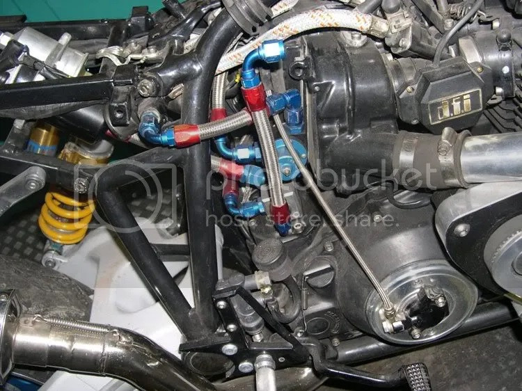

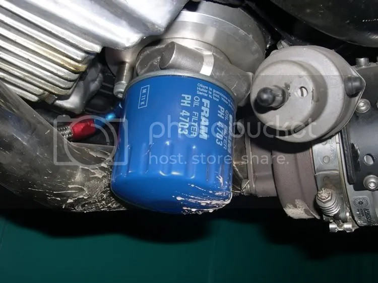

                Oil filter adapter plate with thermostat and cooler connections:
                Click image for larger version  Name:	DSCN2761aa.jpg Views:	2 Size:	104.7 KB ID:	876478

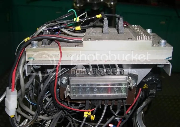

                  Kawasaki DFI set up slaughtered und put together again in the correct intake width:
                  Click image for larger version  Name:	DSCN2769aa.jpg Views:	0 Size:	159.1 KB ID:	876485
                  Computer Electromotiv:
                  Click image for larger version  Name:	DSCN2767aa.jpg Views:	0 Size:	110.6 KB ID:	876486
                  upper cable is for EFI Injection, lower for tacho drive
                  Click image for larger version  Name:	DSCN2752aa.jpg Views:	0 Size:	162.5 KB ID:	876487
                  Coils from Electromotiv:
                  Click image for larger version  Name:	DSCN2763aa.jpg Views:	0 Size:	118.5 KB ID:	876488

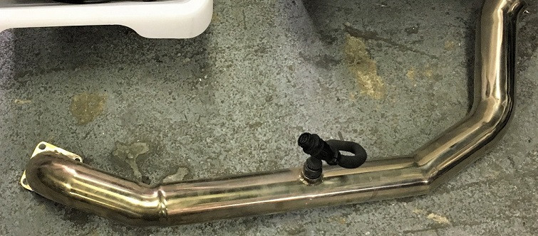

                  Lambda probe welded into the interlink pipe between turbo and muffler

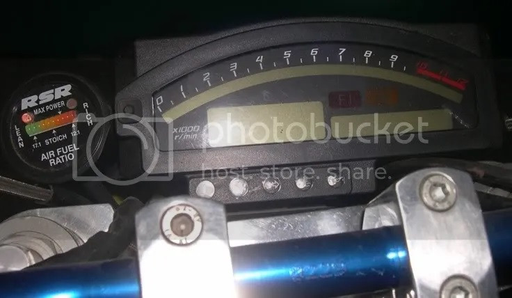

                    Honda SP-1 cockpit and RSR air/fuel gauge:

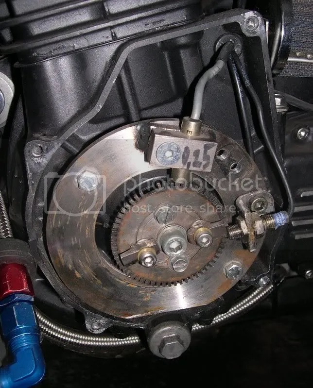

                    speedo drive by NPN-sensor (in the abandoned swingarm pivot housing) reading the number of teeth passing from the modified transmission gear pressed onto the U-joint..

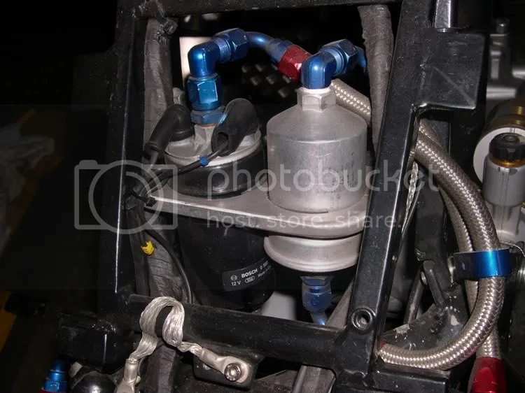

                    fuel pump and filter:
