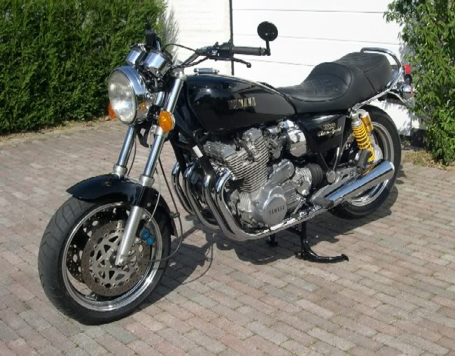

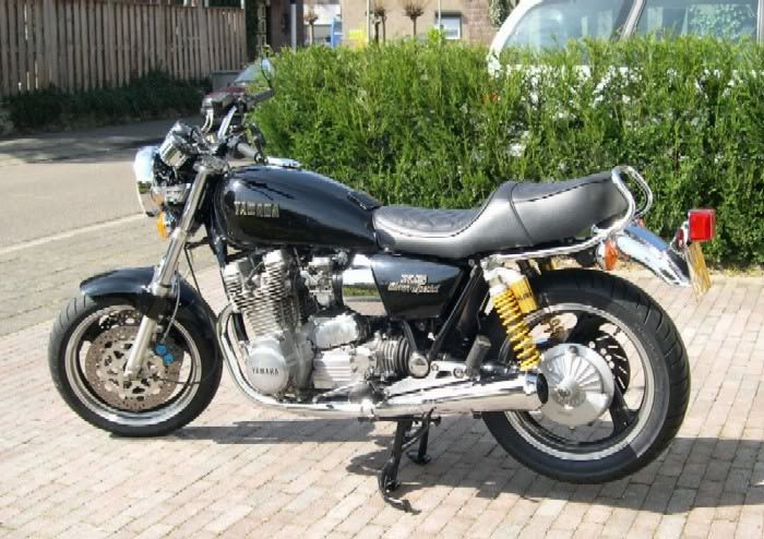

        Hi Guys, I decided to sell this bike......
        before throwing it on the market and sell it to a stranger I was wondering if one of you USA members is interested (and wealthy) enough...

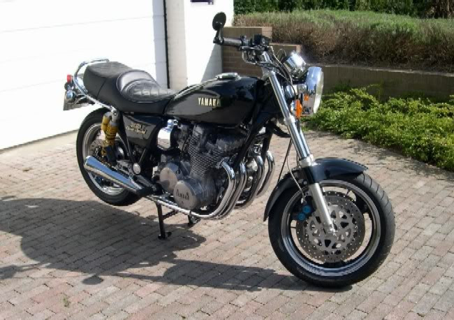

        Multiple reasons: lost my job after 30 years of dedication, so cash flow is coming to a halt....
        Still want to build another project: a seventies endurance racer type bike with one-off frame and chaindrive to take out on trackdays ...

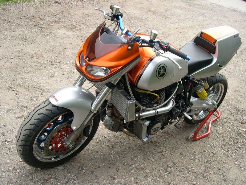

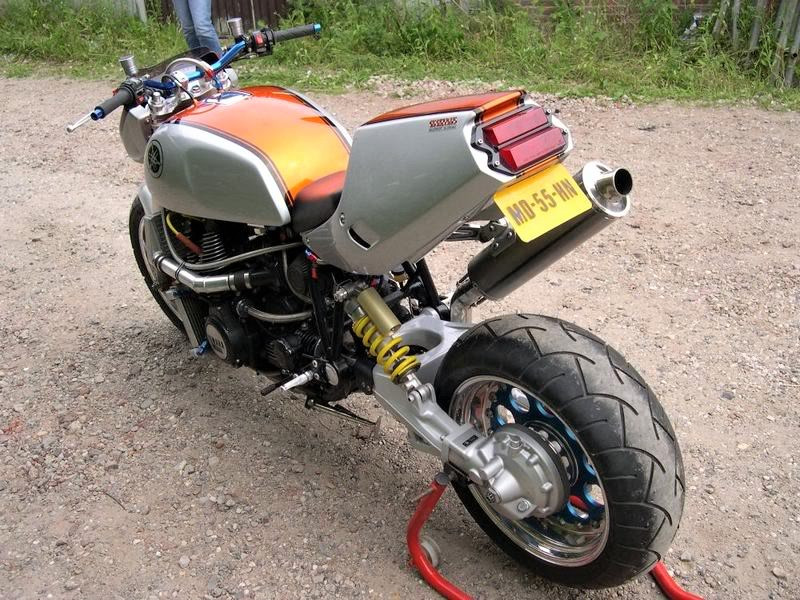

                      Hi Oldnortonrider, got beaten by these two guys in answering your question. Here are some pictures from my girl friends' special
                      Front fork has been replaced with a 41mm jap-spec FZR750R one (pre exup). Just had to make a spacer to fit below the lower bearing in order to make it fit. Guard and wheel is also from the same bike. Discs are YZF750 and brakes are R1 (both bolt-on). Headlamp ears are modified special, risers were handmade. This bike has 17" front and rear with modern Pirelli's and handles like a dream.
