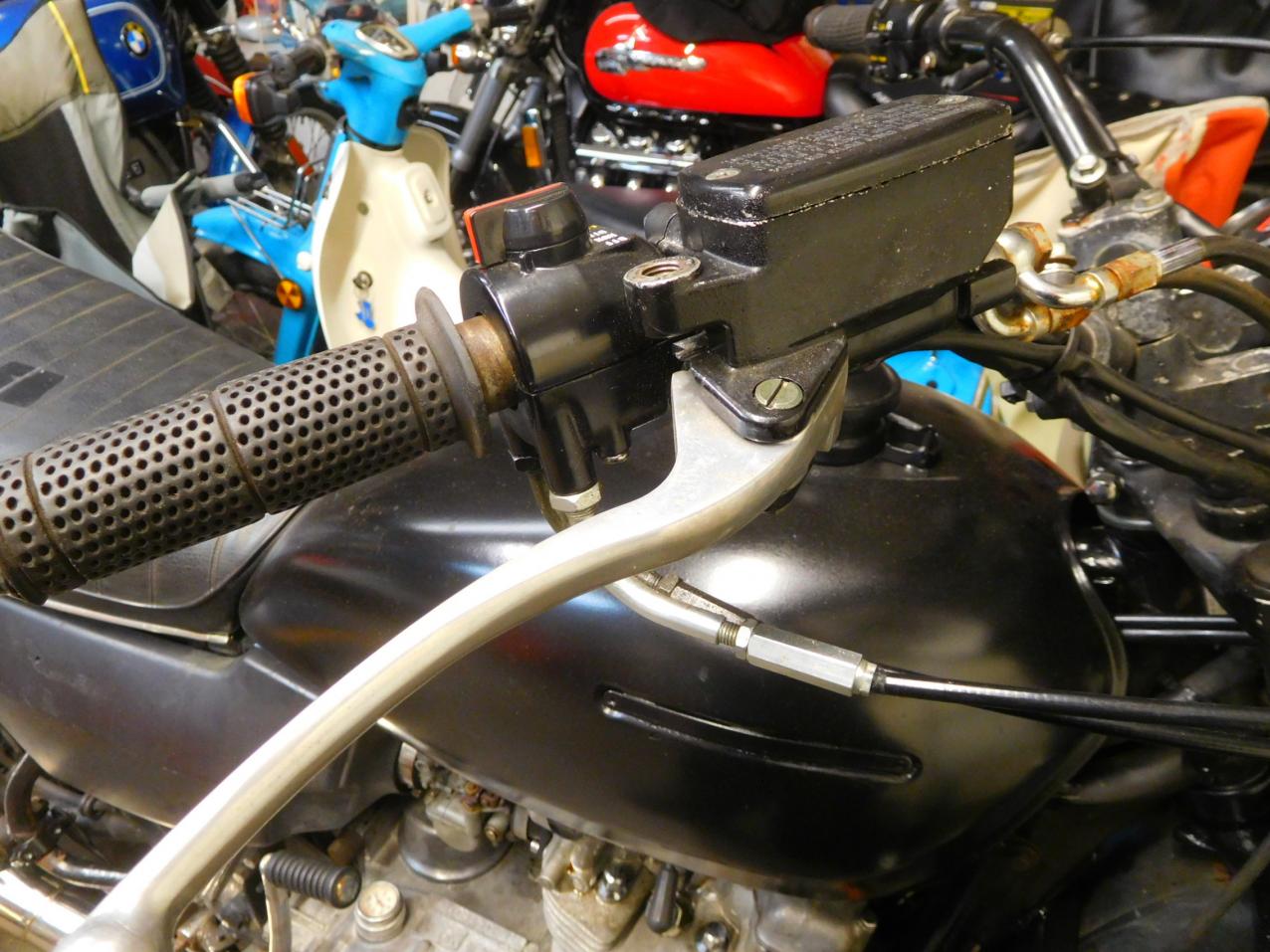

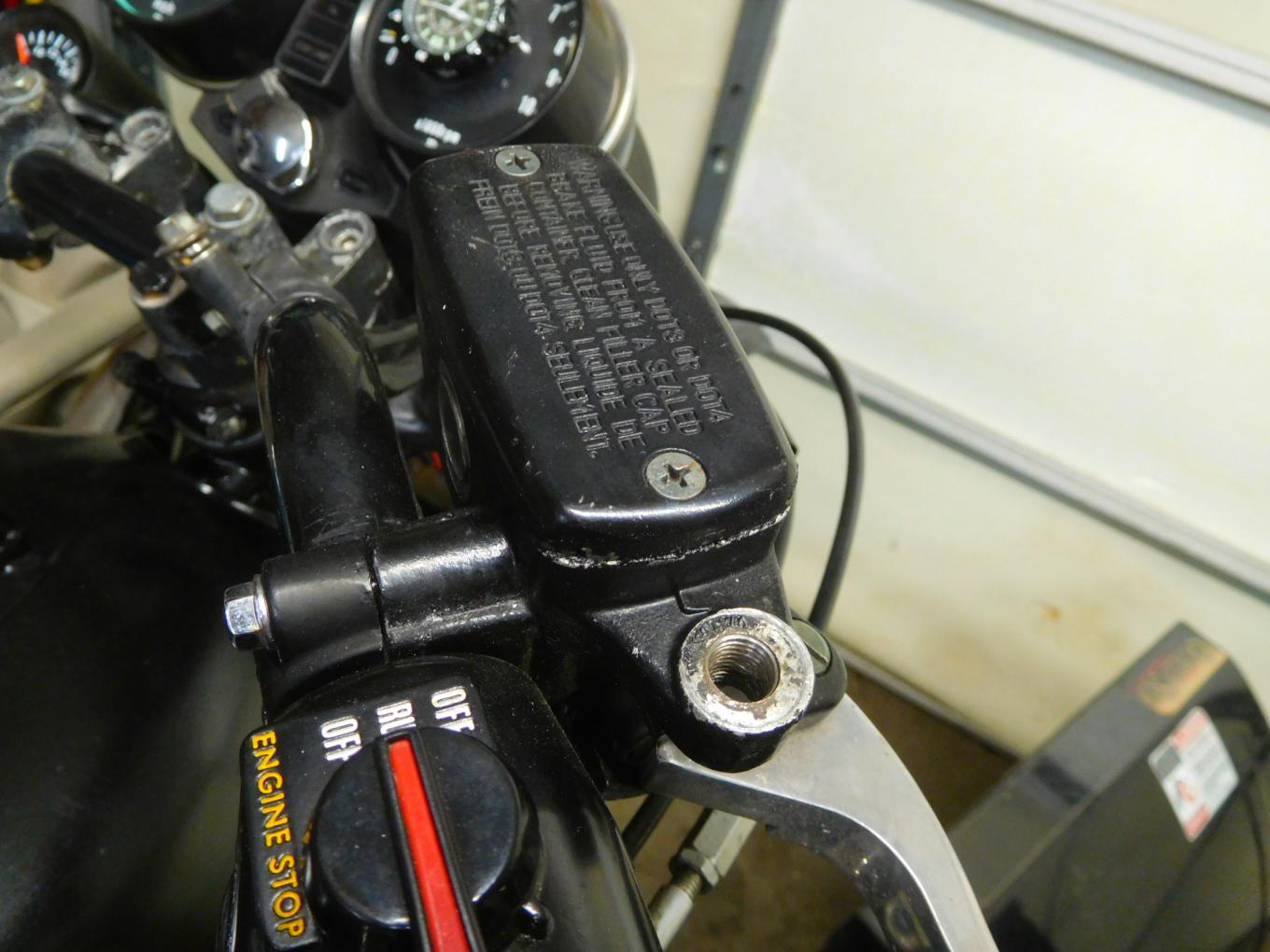

      Master cylinders are not perfectly sealed. They have tiny orifices to let in make up air. Moisture does enter the system over time. It is one of the most missed items on a bike service. This is why calipers lock up over time even when stored in a dry garage over a long period of hibernation. Brake fluid is hydroscopic. I have rebuilt many, many brake systems over the last 40 years. All of them the victim of neglect.

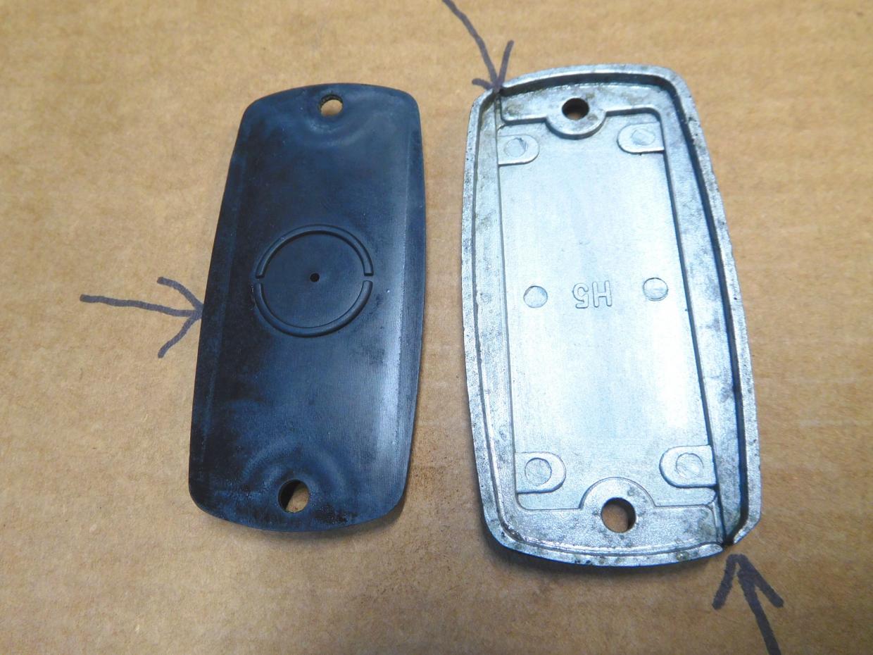

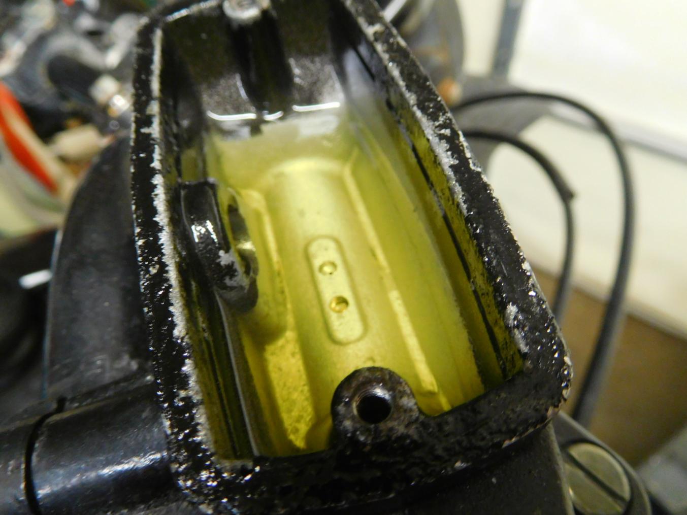

                  I am listening so I can learn something.......but those vent holes in the master cylinder are above the diaphram? The point of having the diaphram is so the brake system is sealed, and the diaphram can move up and down as the brakes are applied without introducing new air or leaking fluid. The vent holes allow the air above the diaphram to come and go.
                  You would never want to expose your brake fluid to rain or the garden hose.
                  Honestly, the fuild would be leaking out the master cylinder if it were vented. I had a master cylinder that leaked fluid below the diaphram and I had to get it to seal so it would stop leaking fluid.
                  Therefore, if you never open the system, it seems like it should last a long time before moisture becomes a problem.
                  PS: A bit of trivia.....the term is hygroscopic. Took me a few years to notice.
                  I am listening if there something for me to learn.

                    My brake comments come from repairing hundreds of motorcycles from every marque over the past 40 years. When I come across trouble with a hydraulic brake system locking up it is always a moisture issue and it usually enters from the master cylinder which is visually indicated by a crusty master cylinder cap and dark brown brake fluid. Lots of aluminum oxide. It's the weakest seal in the system other than the piston seals. Perhaps in my line of work I see the worst ones. I guess it's possible for brake fluid to last for years under some circumstances. I just would not let it go for too long. Just some friendly general advice to folks at home that are new to restoration.

                      I agree- letting the fluid go too long is what causes problems.
