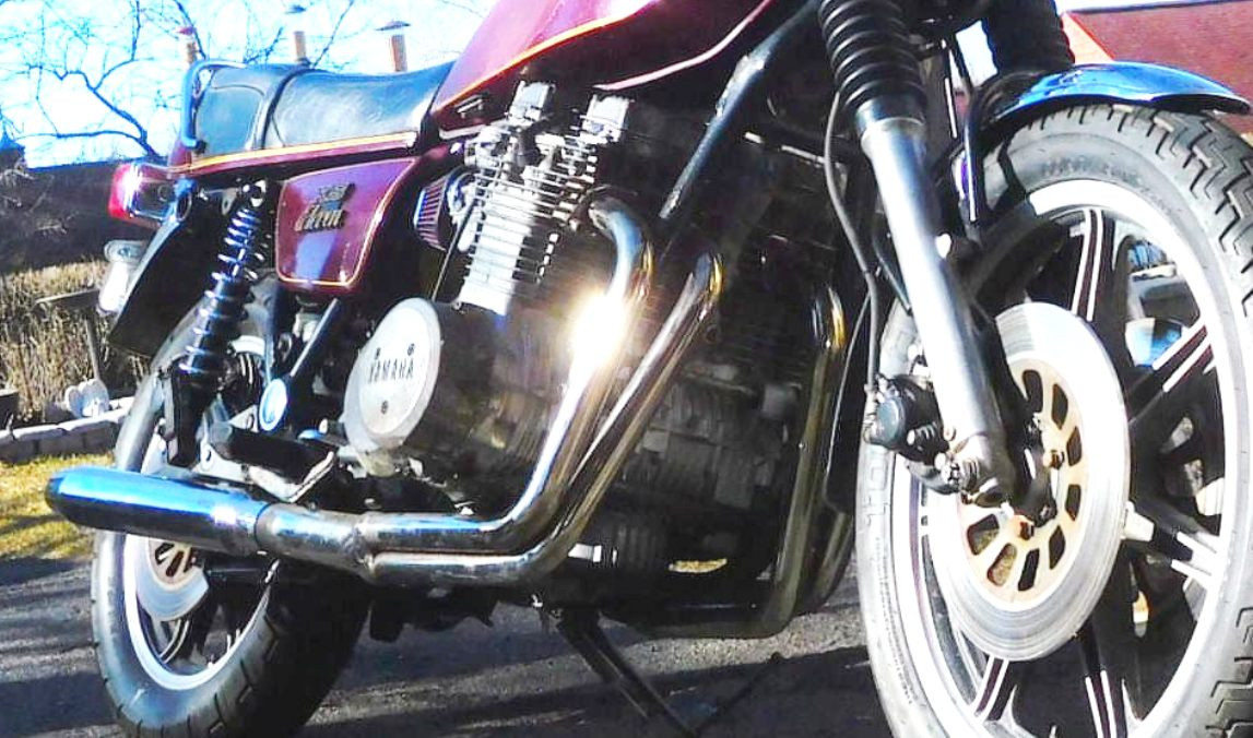

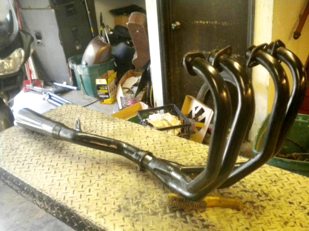

    I believe it is a MAC exhaust. They made 4 into 1 & 2 into 2.

      Is that the Delkevic exhaust? If so, it sounds worse than a Mac or cheap Dunstall exhaust
      Agreed. I think it’s a Mac. It’s only an upgrade if the stock exhaust rotted away. IMHO, the only upgrade might be the shocks. Progressive springs were stock.

        He acquires some nice bikes, but gathers his info from some website summary. Doesn't ever sound like he's intimately familiar with any bike he sells.

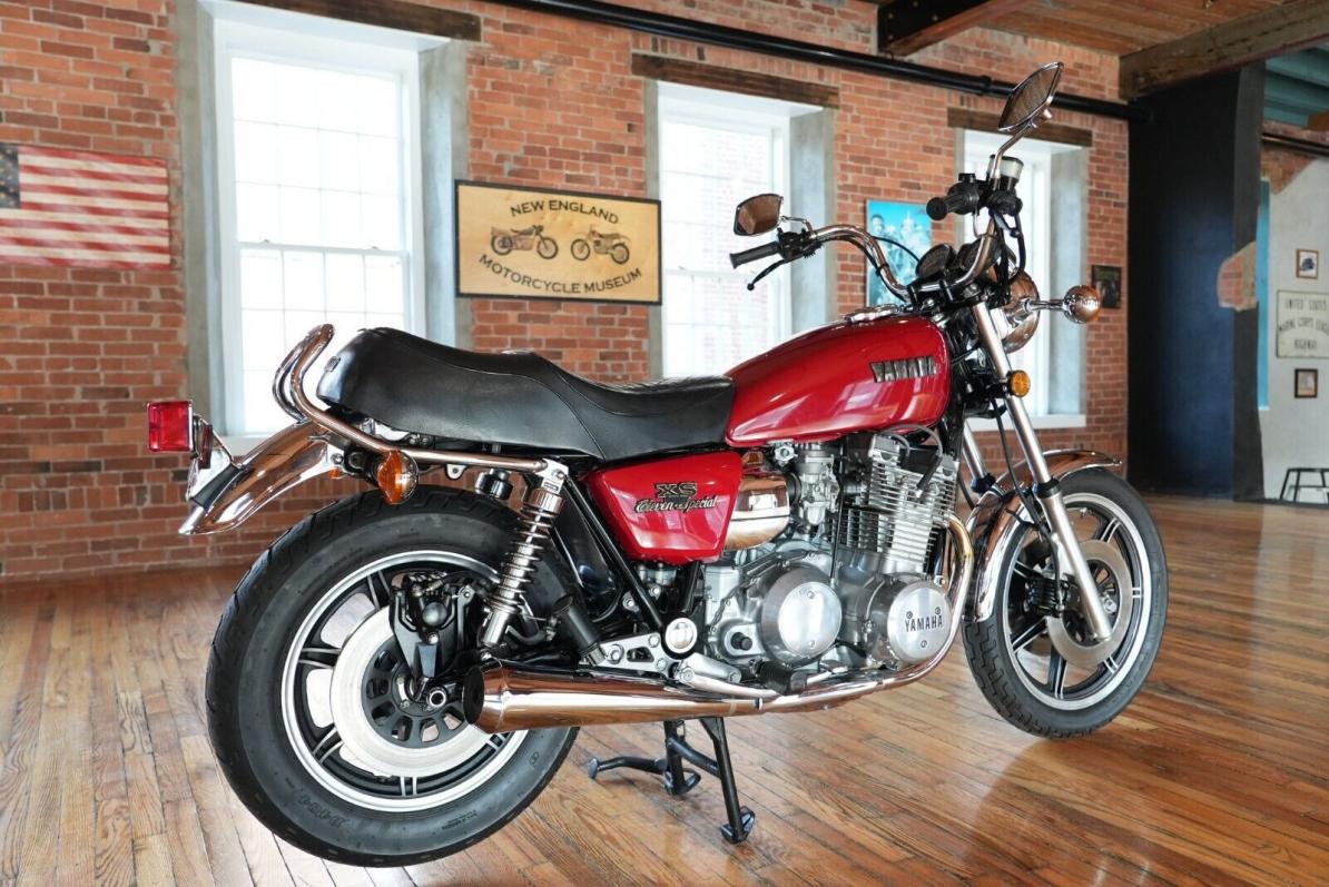

            Here is the latest from Budget Wolverine. A 79 Special. Clean. Do you like that price? Wow.
            https://www.ebay.com/itm/36467847219...Bk9SR9CF9vKgYw

              He does seem to get his hands on some rather nice bikes. That one is in really pristine condition. I don't know about the price. I was reading through the list of things done to the bike and one thing they stated was they converted the bike over to DOT 5 brake fluid. Never thought of doing that which poses a good question for the group here. Who has done that and anything to worry about? Would be nice to not have to worry so much about brake fluid break down with water absorbtion problems eliminated. The DOT 5 fluid is more difficult to find these days. Harley used it on their bikes prior to them implementing ABS on their bikes. All their new bikes are back to DOT4 because of all the safety features now in place. Having a silicon based brake fluid that DOT 5 gives you and the fact that it is not hygroscopic (absorbs water) has got to cut down on much of what we have to watch for on our antique brakes. Anxious to hear feedback on this one and may be a project in my future for my bikes.

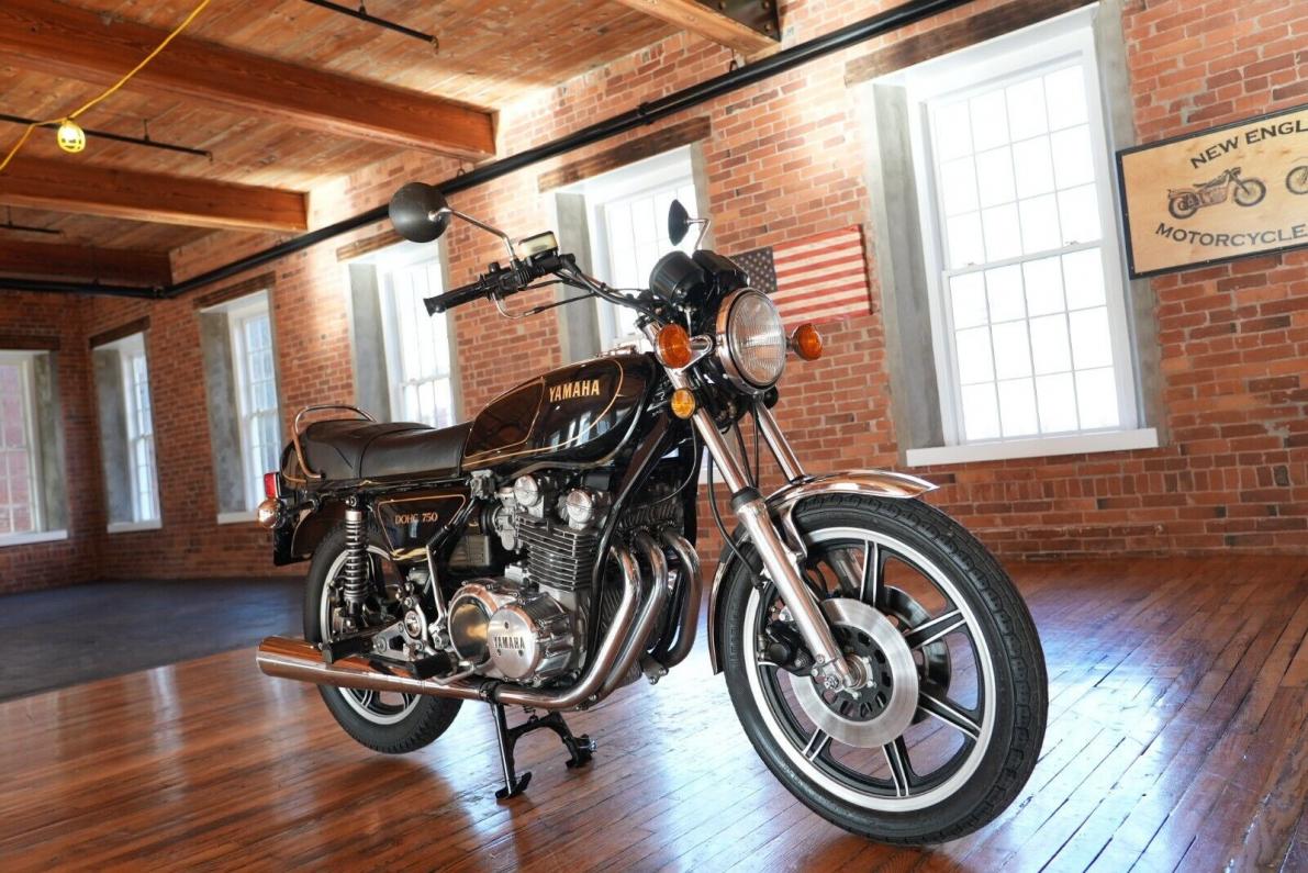

                A triple.

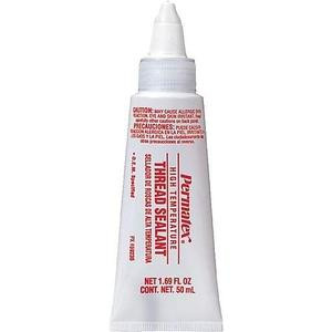

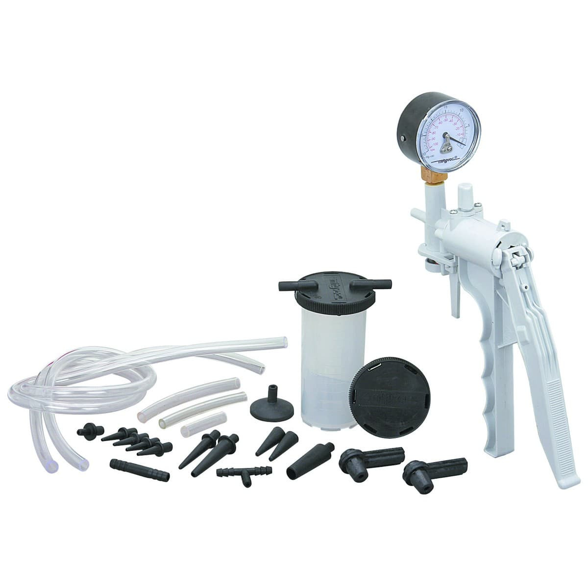

                              I usually change any type of brake fluid about every 2 years. Same with fork fluid. I usually include both in a standard motorcycle service. If you ride in the rain or store your bike outside it really needs to be done sooner than later. It doesn't take long with a Mityvac. The trick is to use some liquid teflon on the bleeder threads so air does not leak out from that area when using the vac. I do the car & truck every few years as well. It will save your calipers (as long as you grease the carriers as well).

                                I use something similar to this with a piece of clear tubing attached and clamped over the bleeder for what's called "reverse bleeding" Fill the caliper with fluid then force it up to the master cylinder, makes a lot more sense than forcing air bubbles downward!
