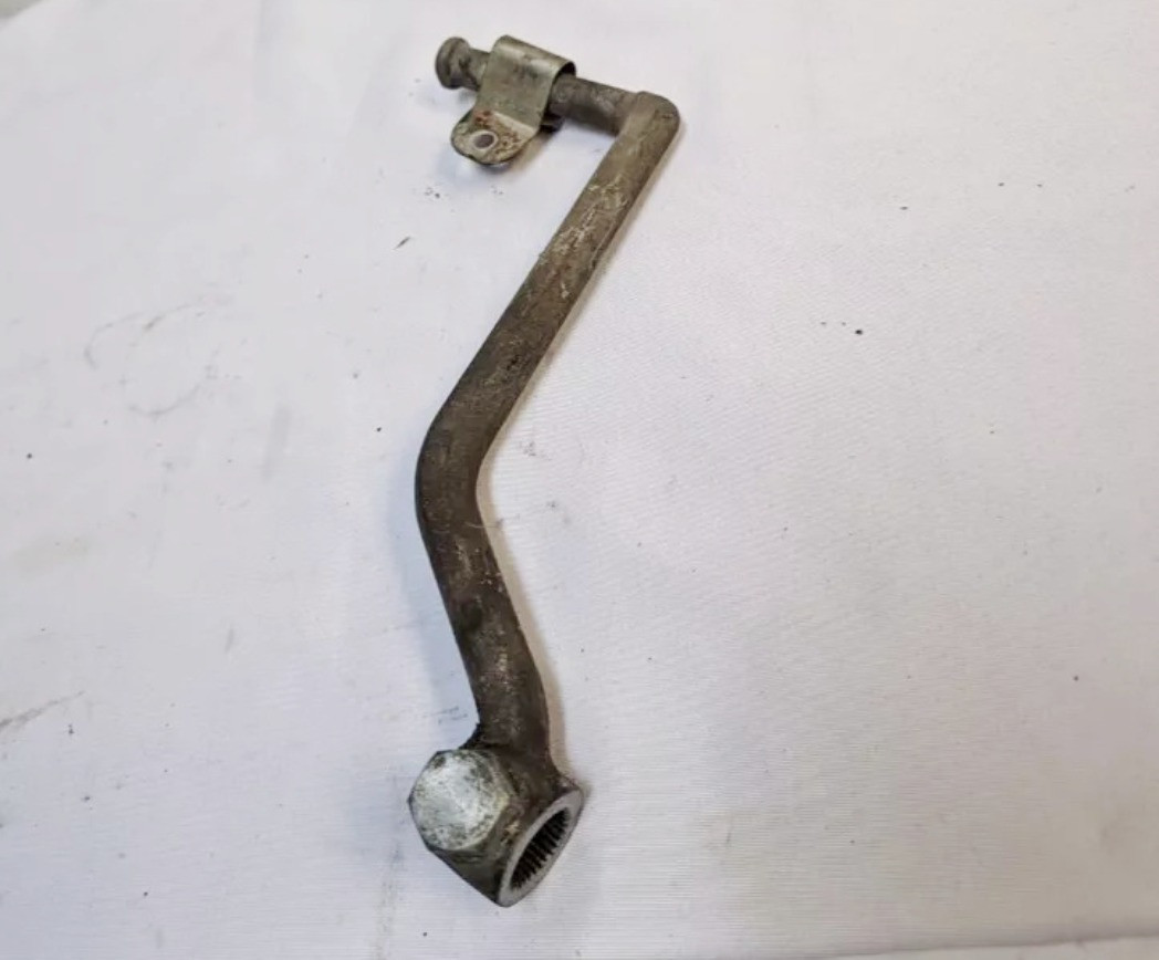

Wanted: Kick starter bracket etc to hold kick starter on to frame.’79 XS1100 Special
Wanted Kick start bracket

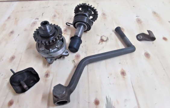

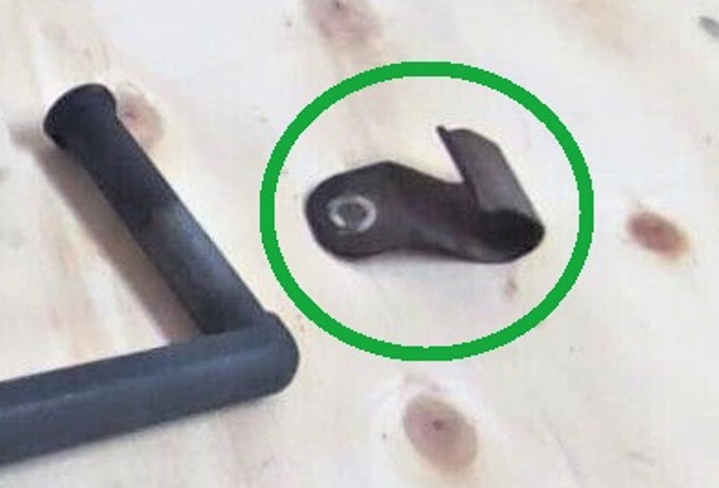

On your 79 Special, the small bracket that holds the part of the kickstarter where you place your foot should be already installed under the battery box on the left side of the bike. As for holding the other end of the lever to the frame on the right side of the bike, a metric bolt of the correct size and a washer could be used instead of that hard to find cap/wing nut assembly.2H7 (79) owned since '89
