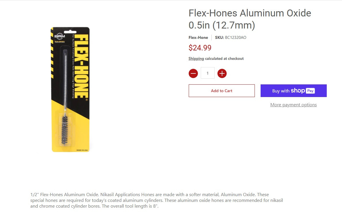

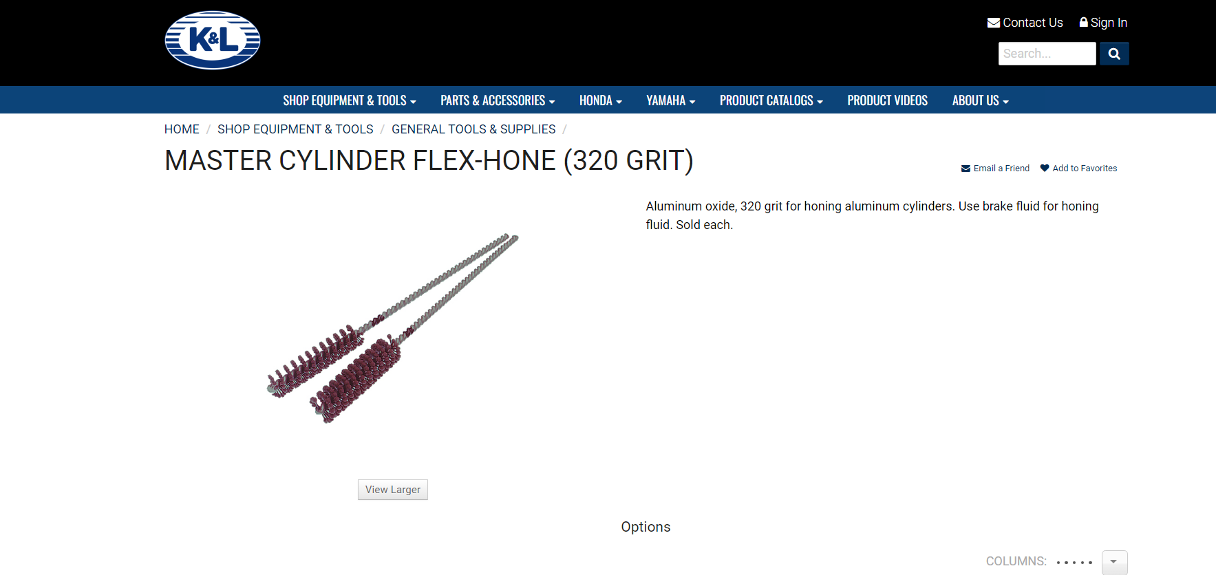

              wow those ball hone tools look perfect!
              '98 GSF1200S '81 GS850G

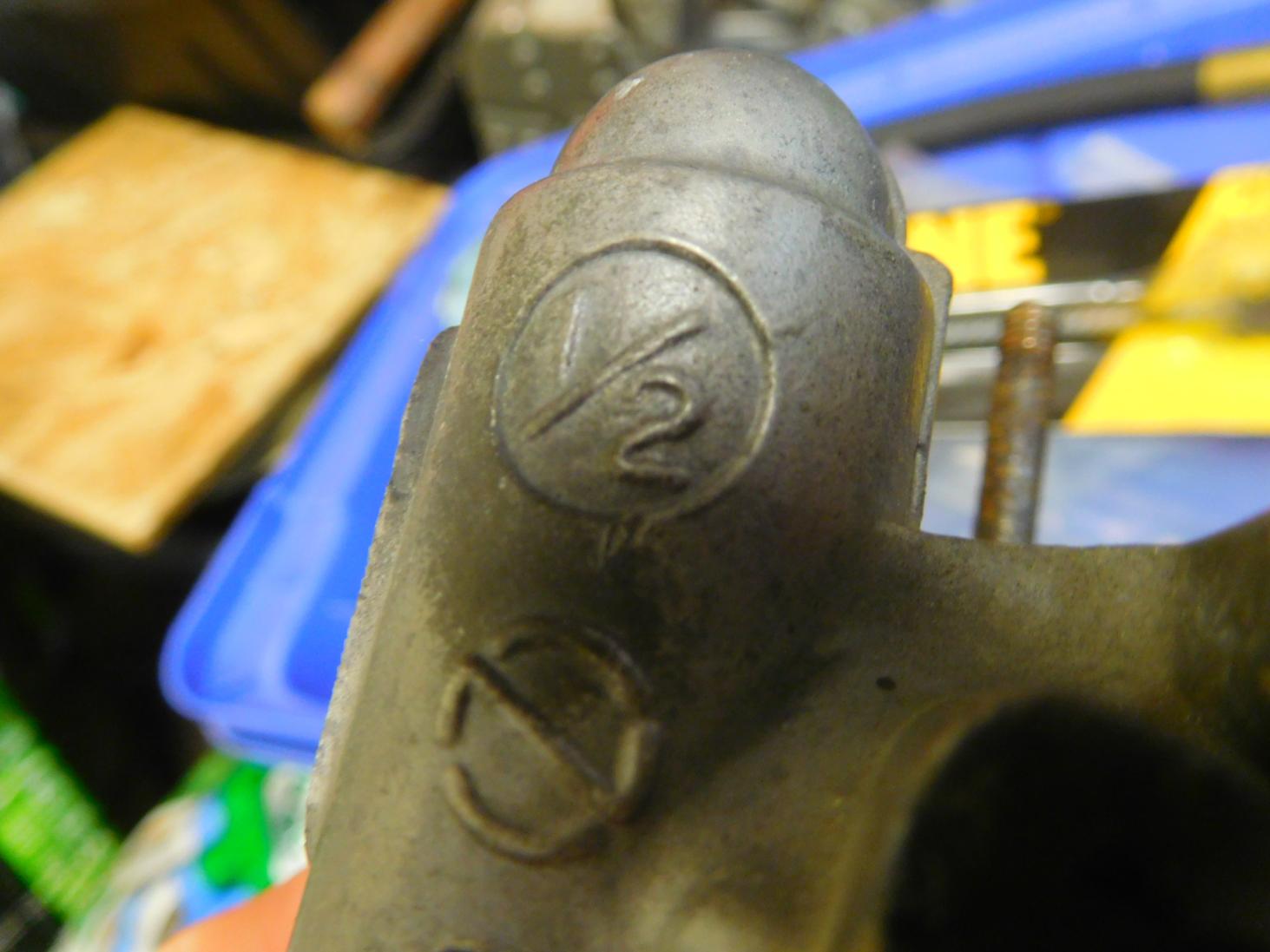

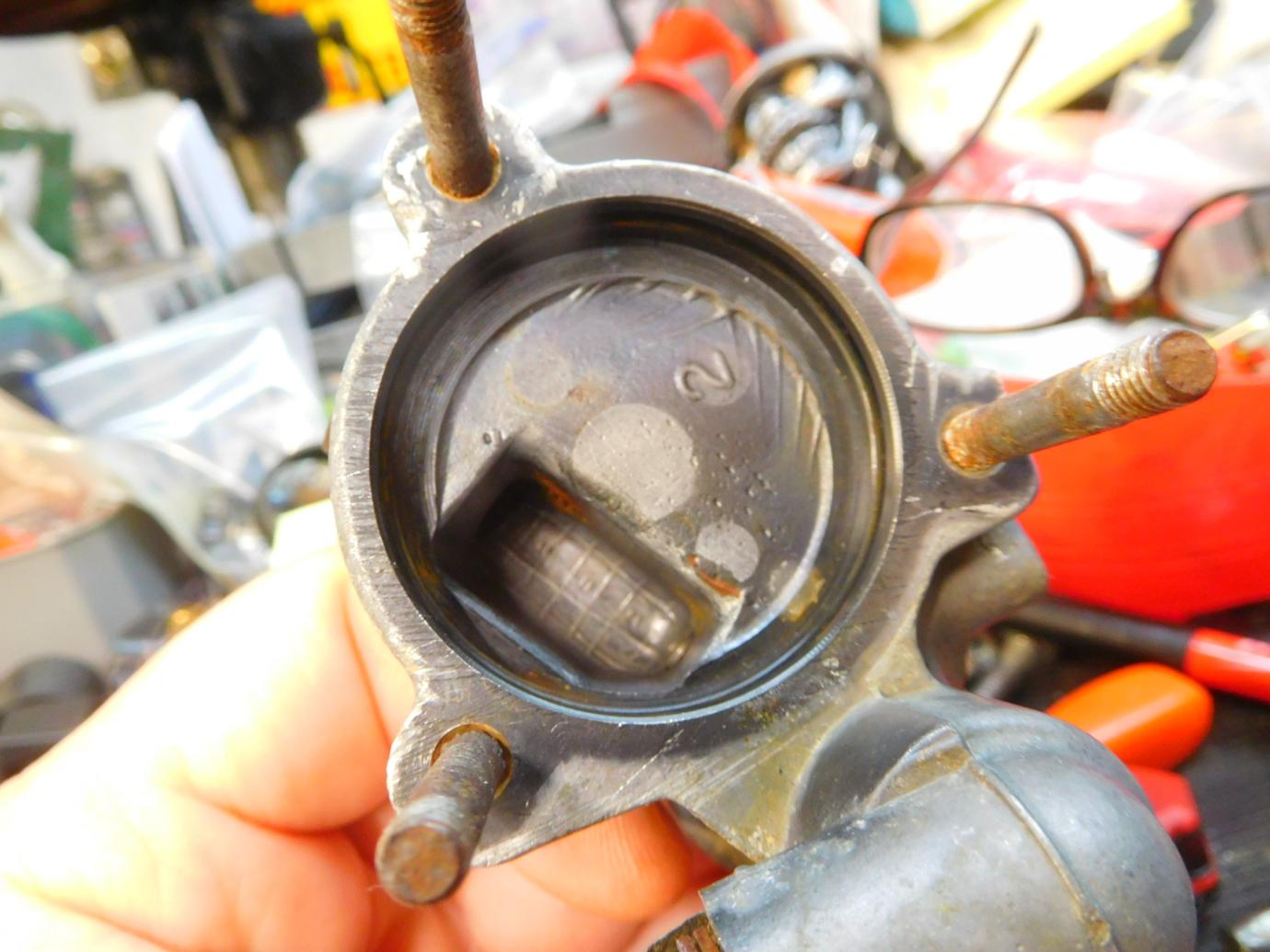

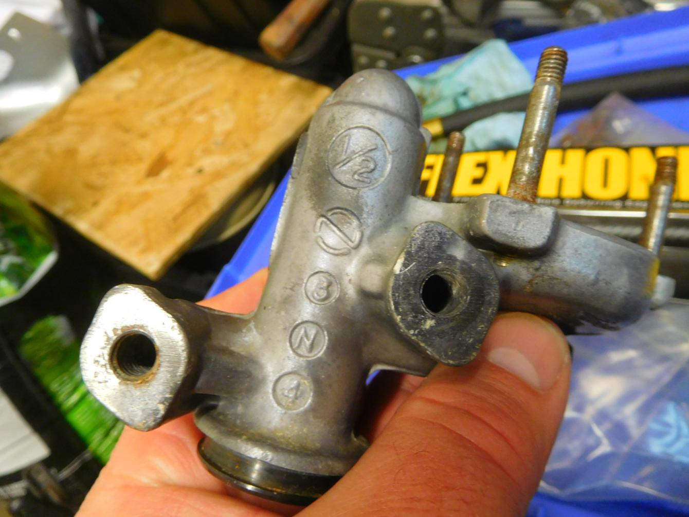

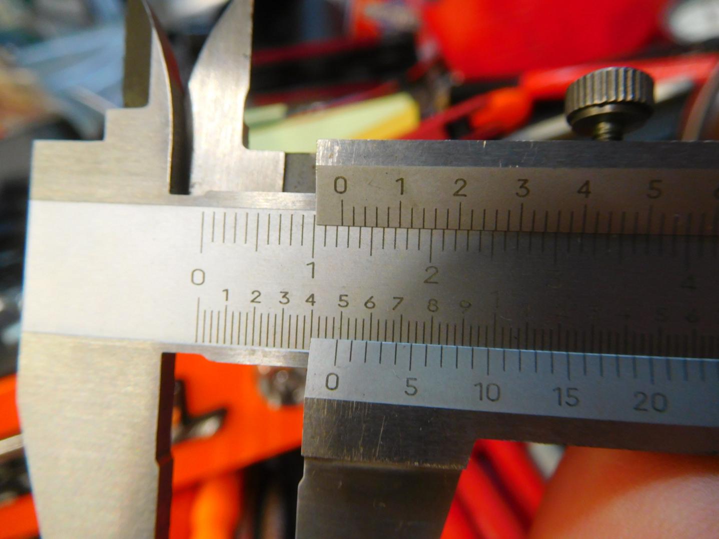

                BTW the bore is 1/2 inch or 12.7 millimeters. A 320 aluminum oxide hone at about 13 mm diameter would work. Do NOT use silicon carbide as it is too aggressive (it's for steel) and will will ruin the bore.
