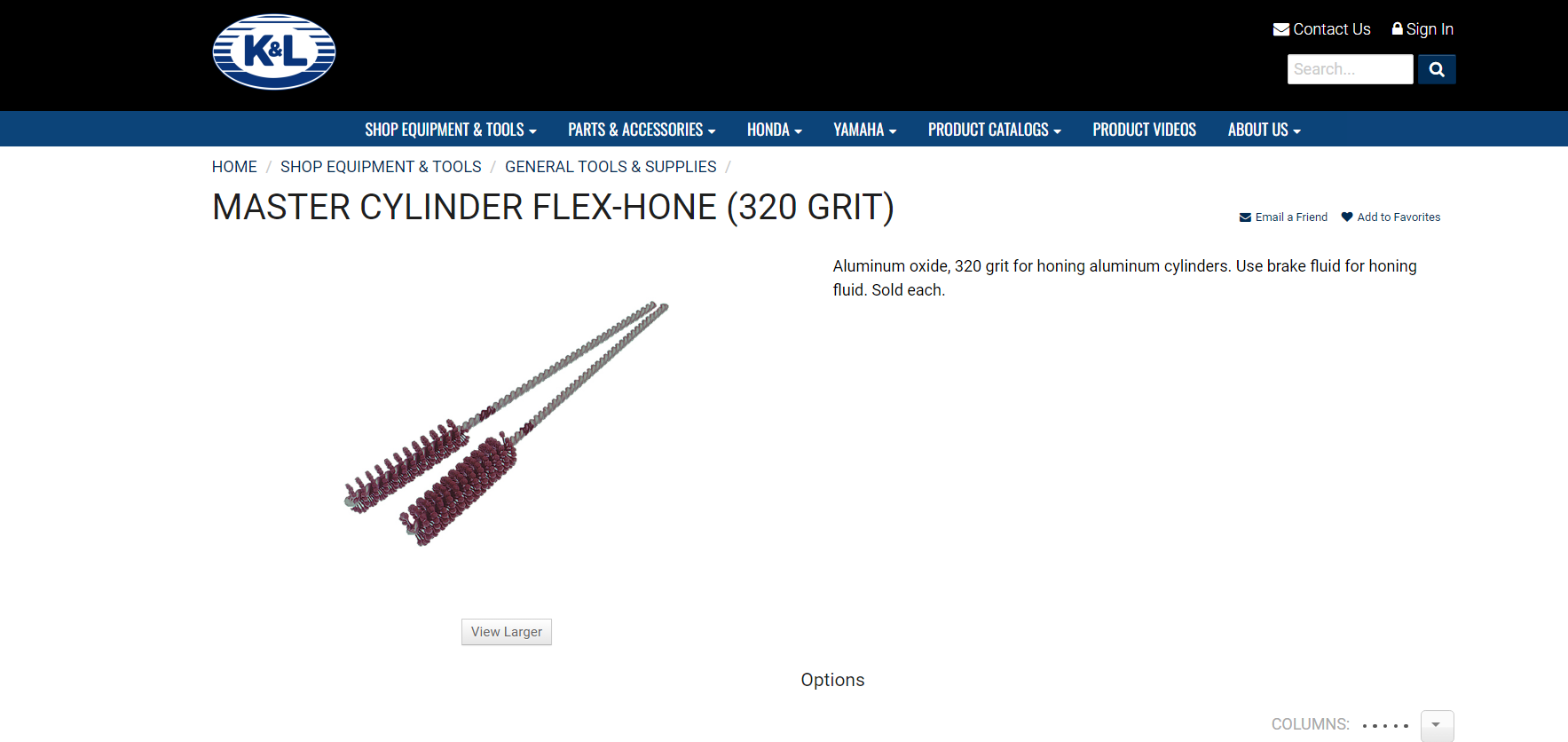

                    This is the tool to use to properly hone master cylinders. Clean the bore afterwards with hot soap and water to get rid of the grit. Leftover grit may be your issue with sealing. it's difficult to clean a bore properly after a hone. If it's not done right you will have the type of issues you are experiencing.
                    Aluminum oxide, 320 grit for honing aluminum cylinders.Use brake fluid for honing fluid. Sold each.

                          Good info on that ball hone tool for future reference Deebs! I ordered one of Bob's MCs that he had listed on ebay, and also finally seem to have my original not leaking and finally bled it correctly. With the new braided lines, the pedal feel is fantastic now!
