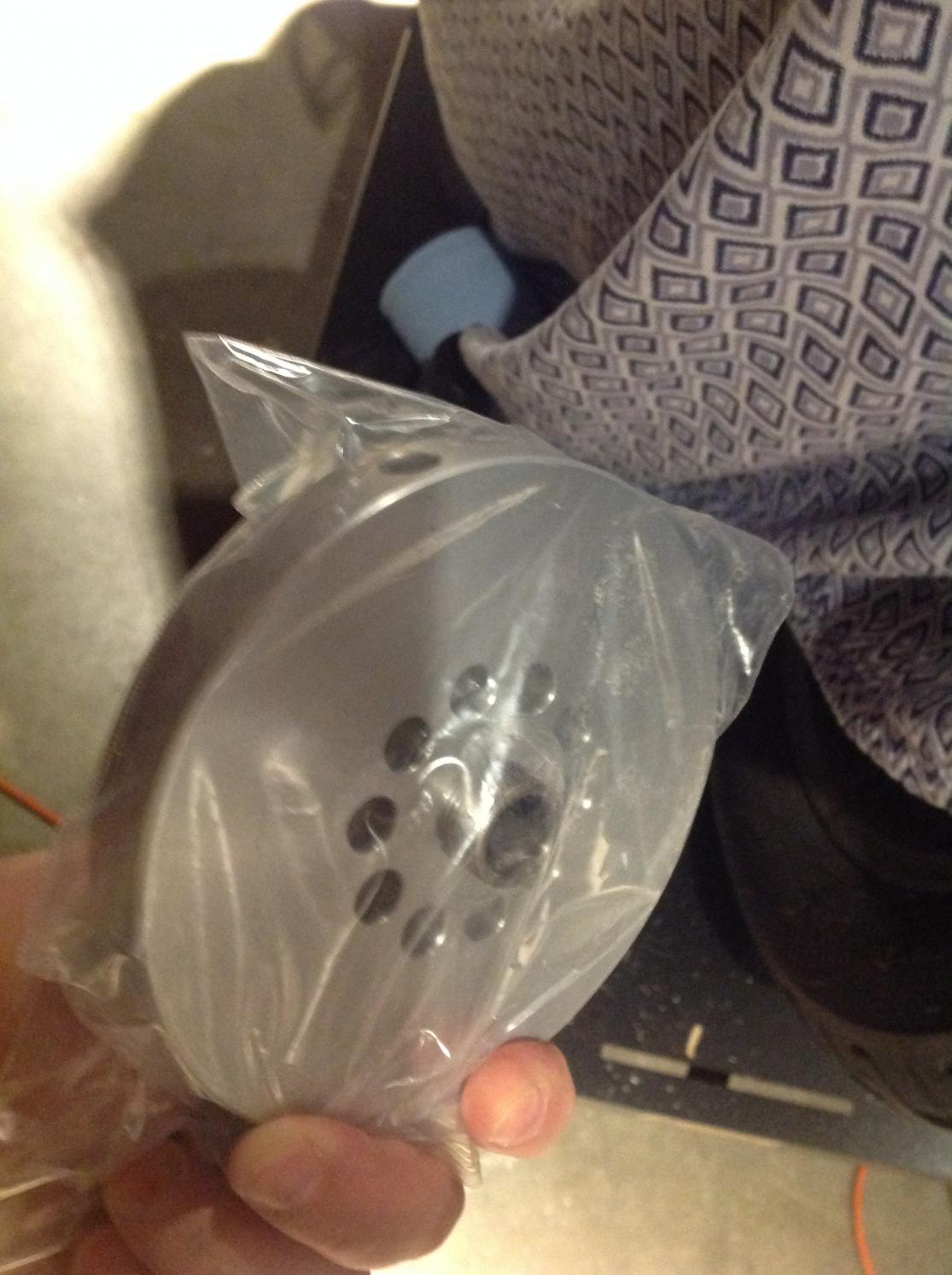

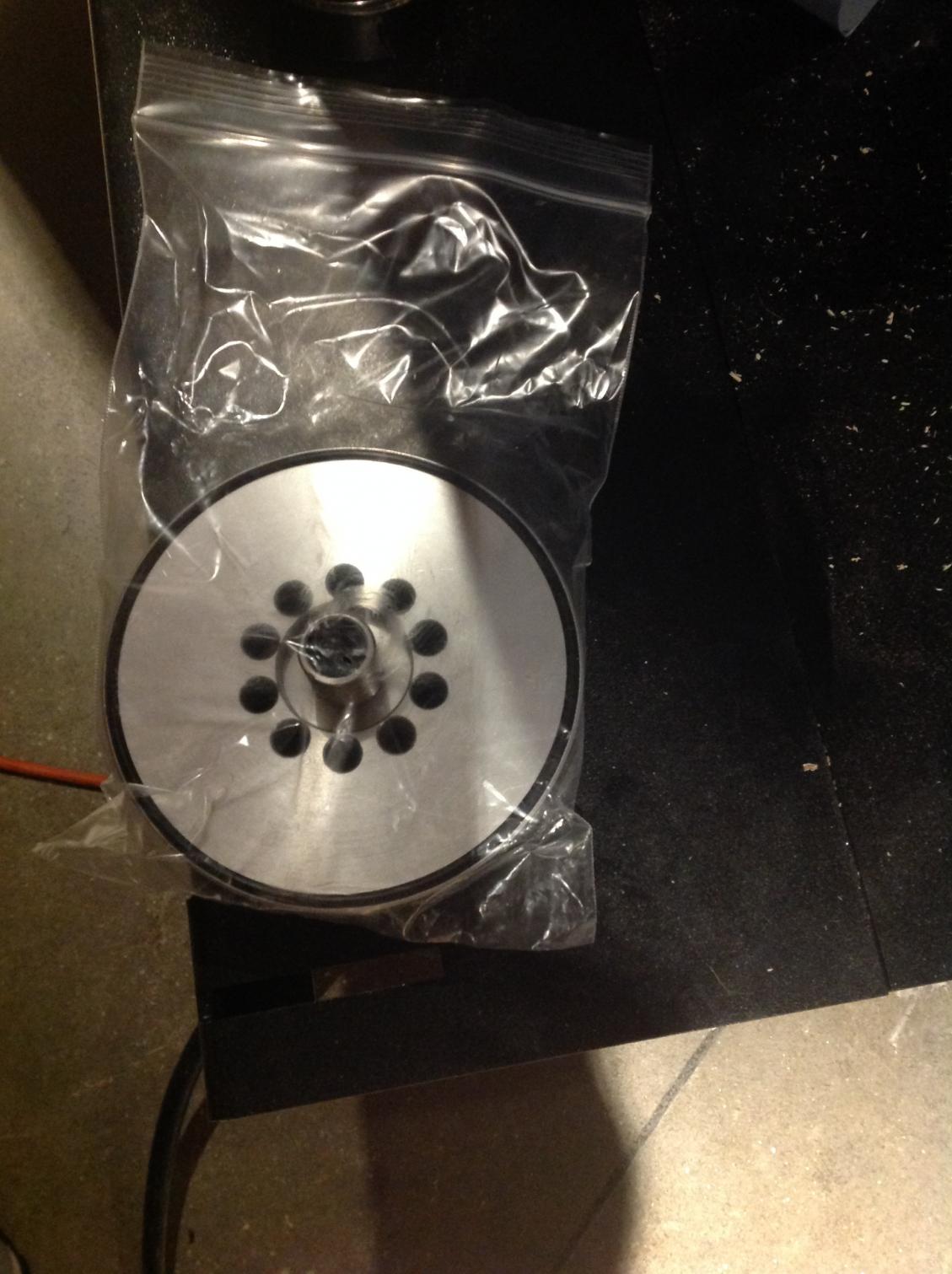

    Hi Greg, I have one. I have not put on the bike yet. If you noticed that I'm modernizing my SG to EFI which will also include an oil cooler so I'll probably end up fabricating my own with a temp thermostatic bypass..... I'll take a pic of what I got and send to you if you're interested.

                        Hey Bax, where did you get that adapter, and was it specifically made for the XS11, or some other model, ie. Venturer/Vmax?? A closer view of it shows that the recess in the middle around the mounting threaded pipe doesn't look deep enough to fit the XS11. The XS11's threaded knob that sticks down from the engine that the OEM filter bolt screws into sticks out around 0.67" above/below/beyond the OEM filter housing mating surface, that's why the S.O.F.A (Spin-on Oil Filter Adapter) that I made had to be about 1.15" thick to allow enough depth for that protruding threaded stub AND have enough thickness for the central threaded section to have enough threads to provide a strong mounting onto the threaded mounting pipe.

                            TopCatGr58 I collected that SOF plate quite a few years ago after my first oil change on the SG = big mess. I'm not sure where I got it, some web site for sure, I would have been sure to get one listed for XS models, if something else was shipped to me it would have gone unknown sitting in the garage parts closet Never attempted to install it as I had an inventory of filter cartridges I was using up (still have one left). Passing it along to BA80 as I will incorporate an oil cooler into the bike with thermostatic bypass and an oil temp sensor to run into the ECU. I just decided to make one up that'll include those features in the same adapter.

                              BA80 Greg, preemptive apologies if it does not fit as TC suspects.
