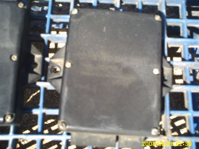

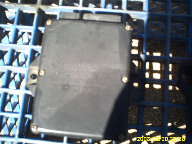

            This is what I have now.
            The S/N isTID14-01
            2H7-10
            Jack Williams
            Hesperia ,Ca.
            jackjet
            • randy
              • Dec 2003
              • 4521
              That TCI will not swap to a stock XJ. It is for an XS, '78-'80. '81 and up used a TCI that has advance built into the box and the XJ also added a vacuum actuated boost sensor connected to the TCI.
              This TCI will run the engine, but it will run poorly.
              Jacket, have your TCI's been tested and how much $$ do you want for one?
