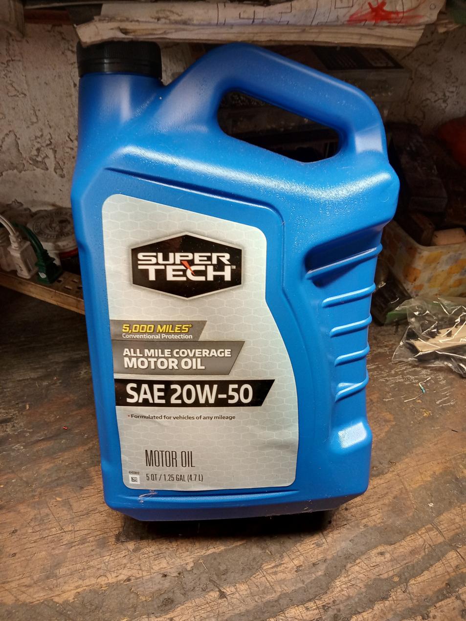

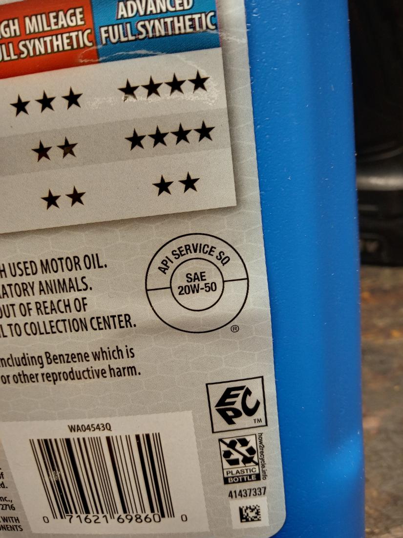

      Wal-Mart Conventional 20W50
      Click image for larger version  Name:	IMG_20260919_160756.jpg Views:	0 Size:	173.2 KB ID:	891571
      Click image for larger version  Name:	IMG_20260919_160819.jpg Views:	0 Size:	169.9 KB ID:	891572
      Nothing written in bottom half of circle which means no friction modifiers added that may cause clutch slip.

          I don't want to start an oil debate but this is car oil not motorcycle oil. Even without the friction modifiers it is formulated for use in automobiles not motorcycles. Do you own research on the debate concerning use of oils engineered for automobiles and it's use in motorcycles.
