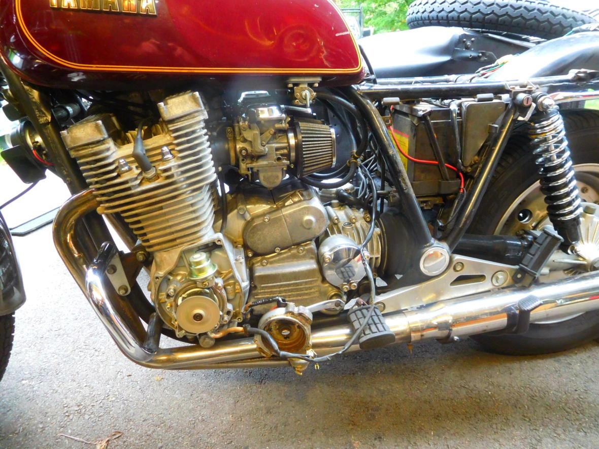

      Here is an update: Wrenched on it all day. Here is what I tried/found:

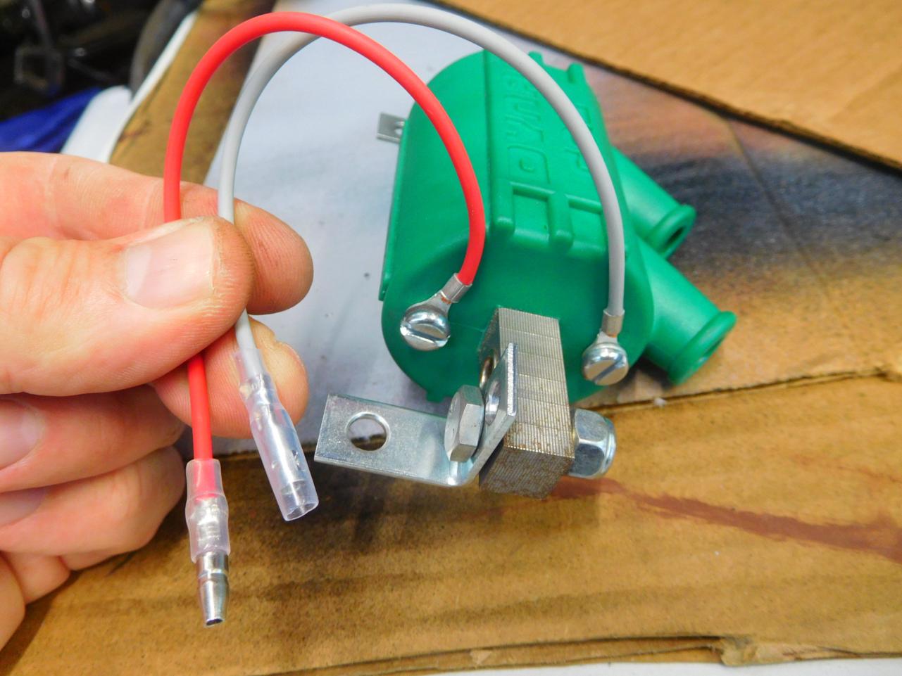

      Checked all voltages including every pin on the TCI and coils. All normal 12V. 13V-14V while running.
      Compression check - All 4 cylinders within 5 PSI.
      Tried a set of known good used plugs. No change.

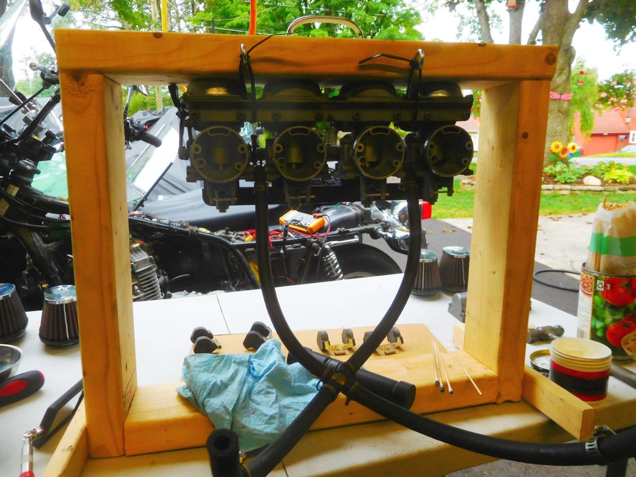

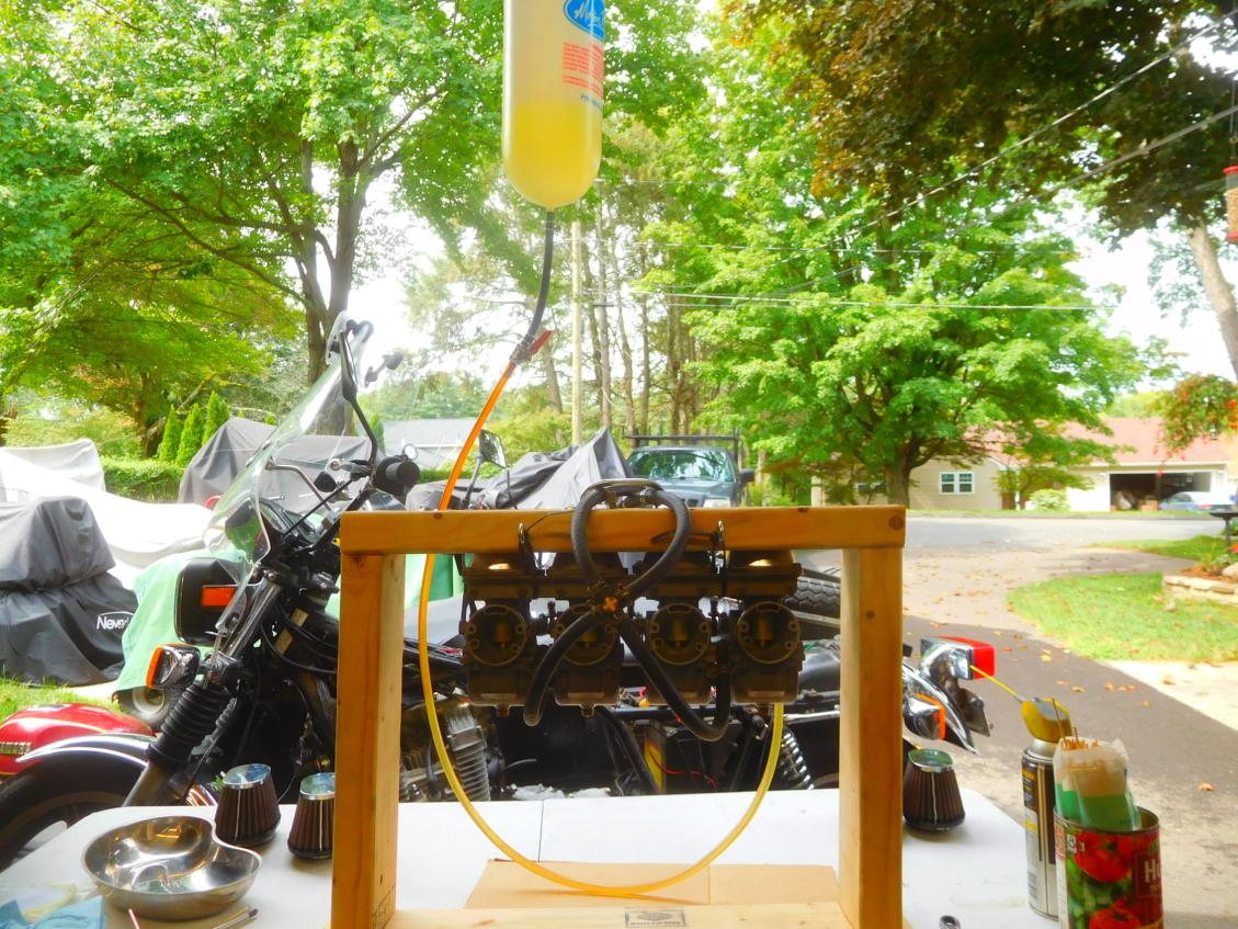

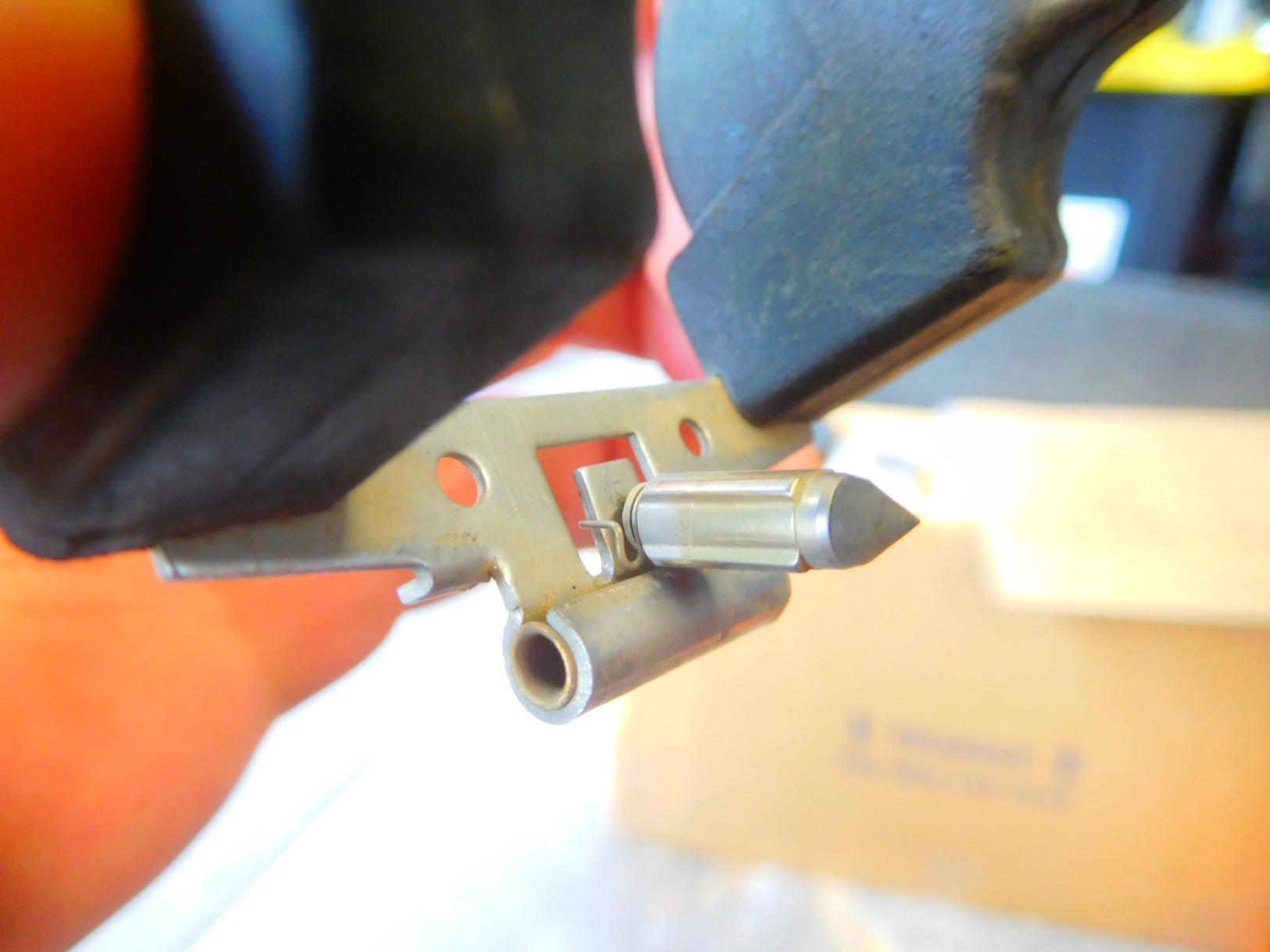

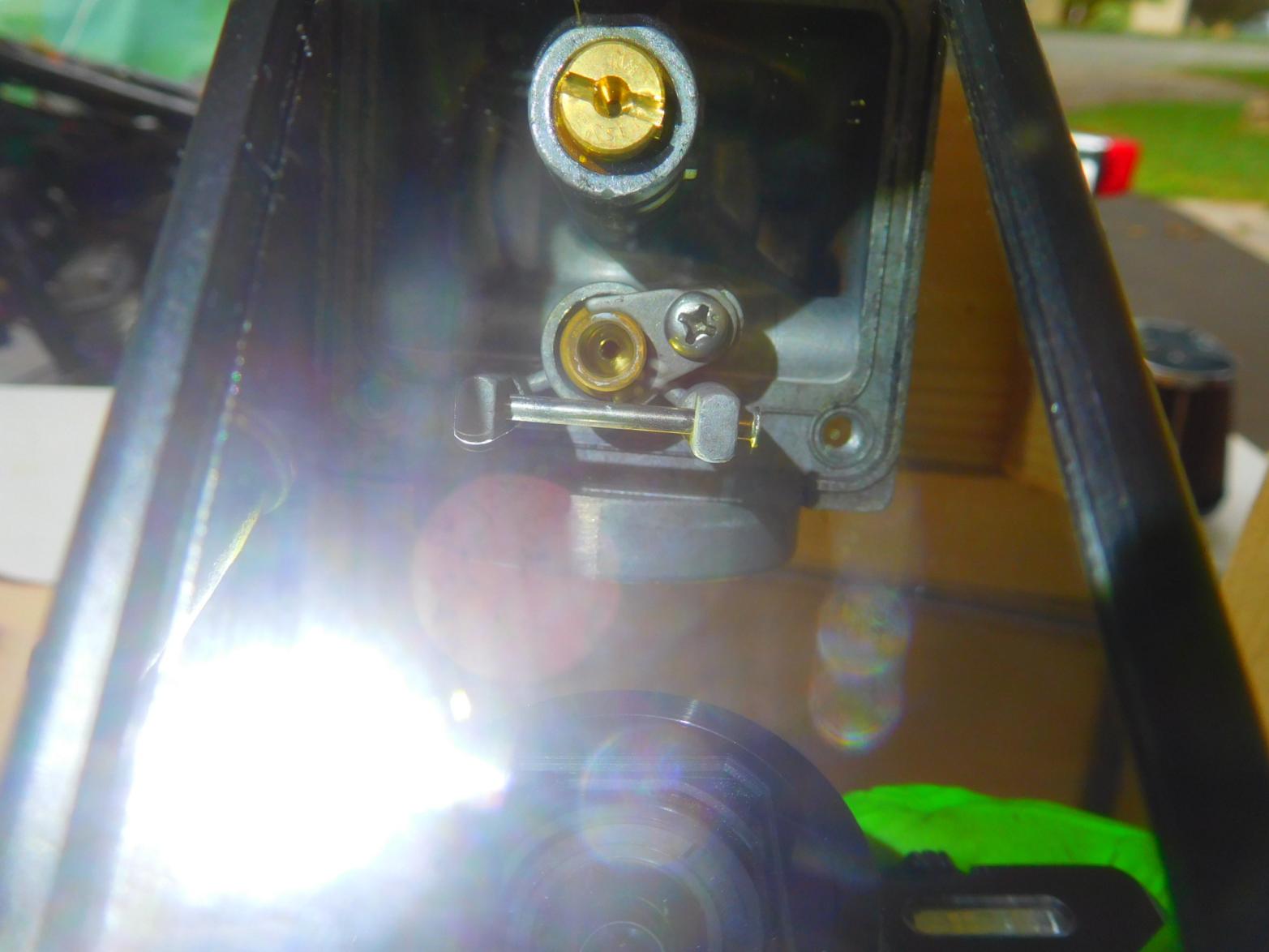

      Removed and serviced carb floats. Cleaned seats with polish. Checked fuel level in all 4 carb bowls. No change.

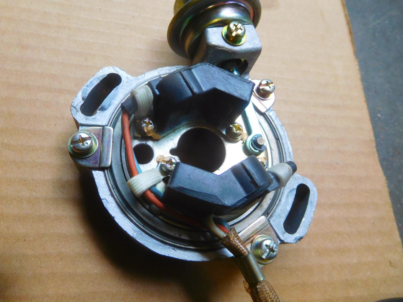

      Installed a mint 1980 advance unit with only 18K original miles. No change.
      I can only draw two last conclusions. A weak coil or the cam jumped time. However, the engine runs smooth (internally) no weird metallic noises.

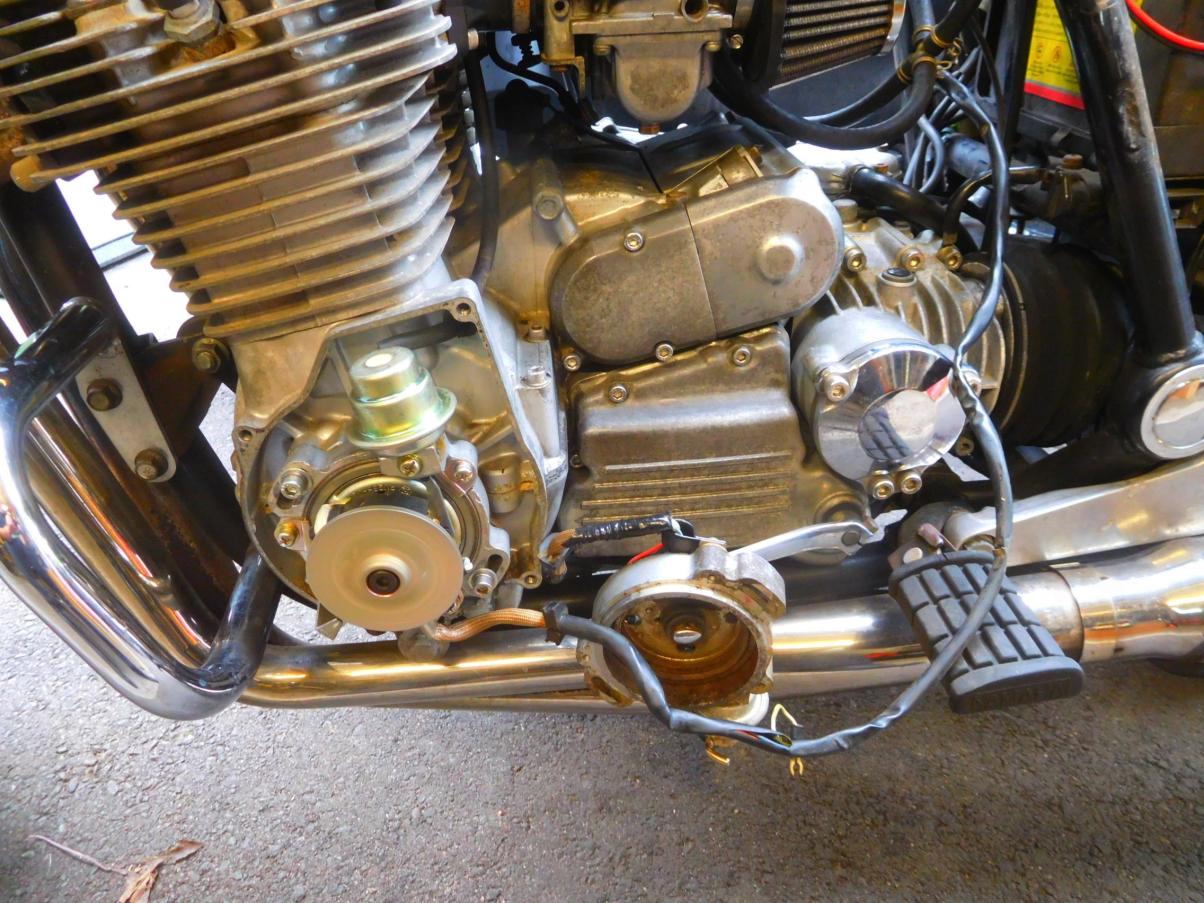

        • 2047
        Spare Advance unit. No change.

          • 7827
          That is just the vacuum advance unit. Did you service the mechanical advance that lives behind that? If you have a little rust on the weight fulcrum points, it may cause a lag.
            • 2047
            Good point Ray, It is clean, well lubricated, and works perfectly.
