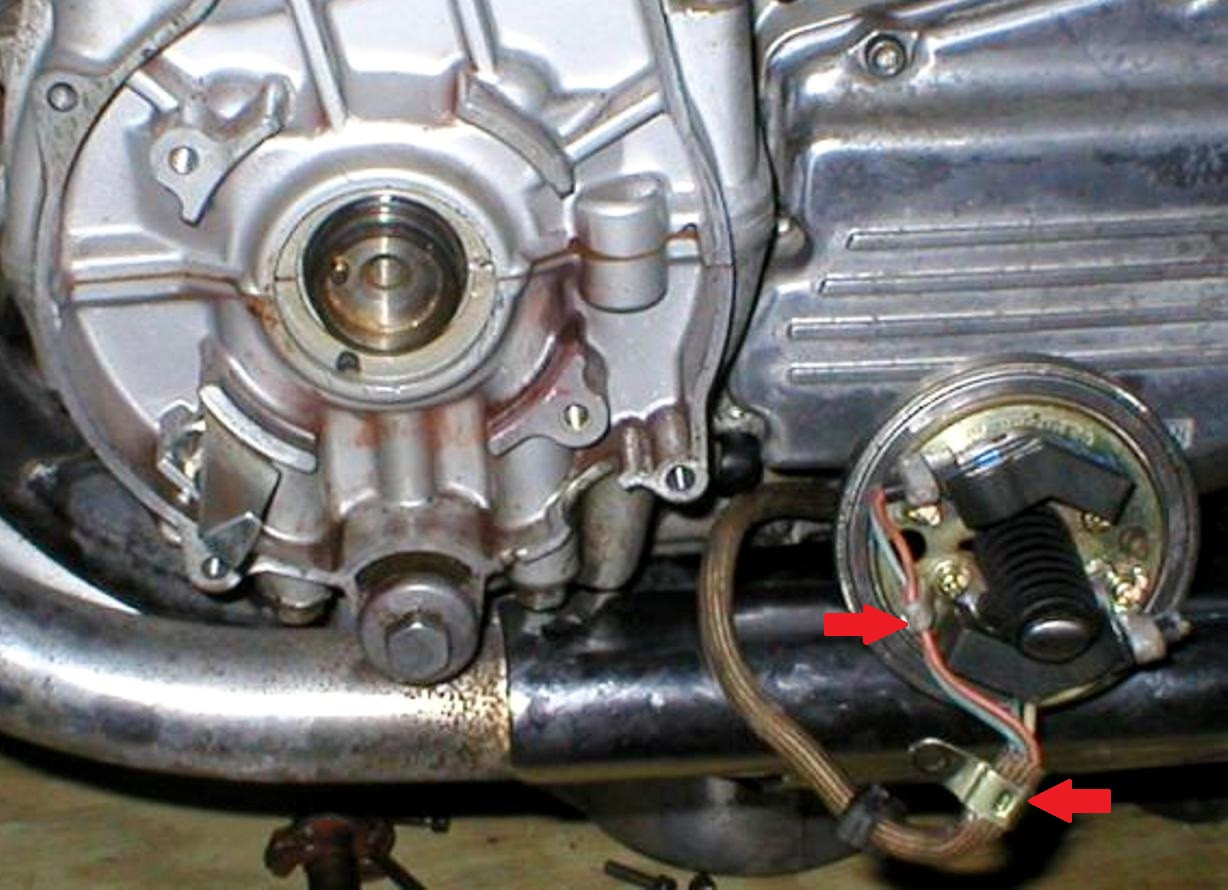

    My first thought: Advance unit broken wire(s). Had this happen a few years back and it was an easy diagnosis and fix. But no. I really got in there and pulled on all the wires while the bike was running and it still idled.

    Wow. This one is a head scratcher. I guess I need to check the cam timing marks next (did it jump?). I am still wondering about the advance unit. I have a good spare that I will install and try after I check the cam timing. I have read here in the forum about the neutral wire interfering with the sensor wires but the sensors did read 740 ohms. I will try new spark plugs as well. Will also check for a cracked coil. This is a tough one.

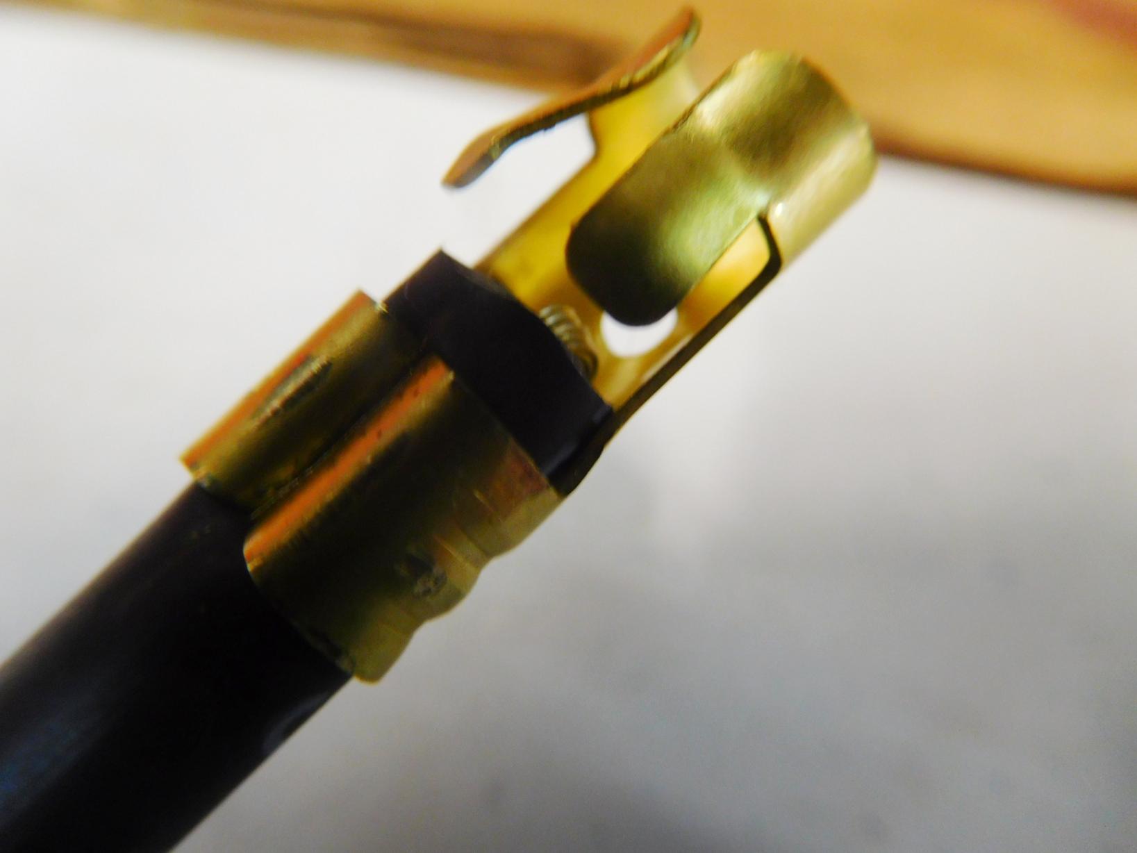

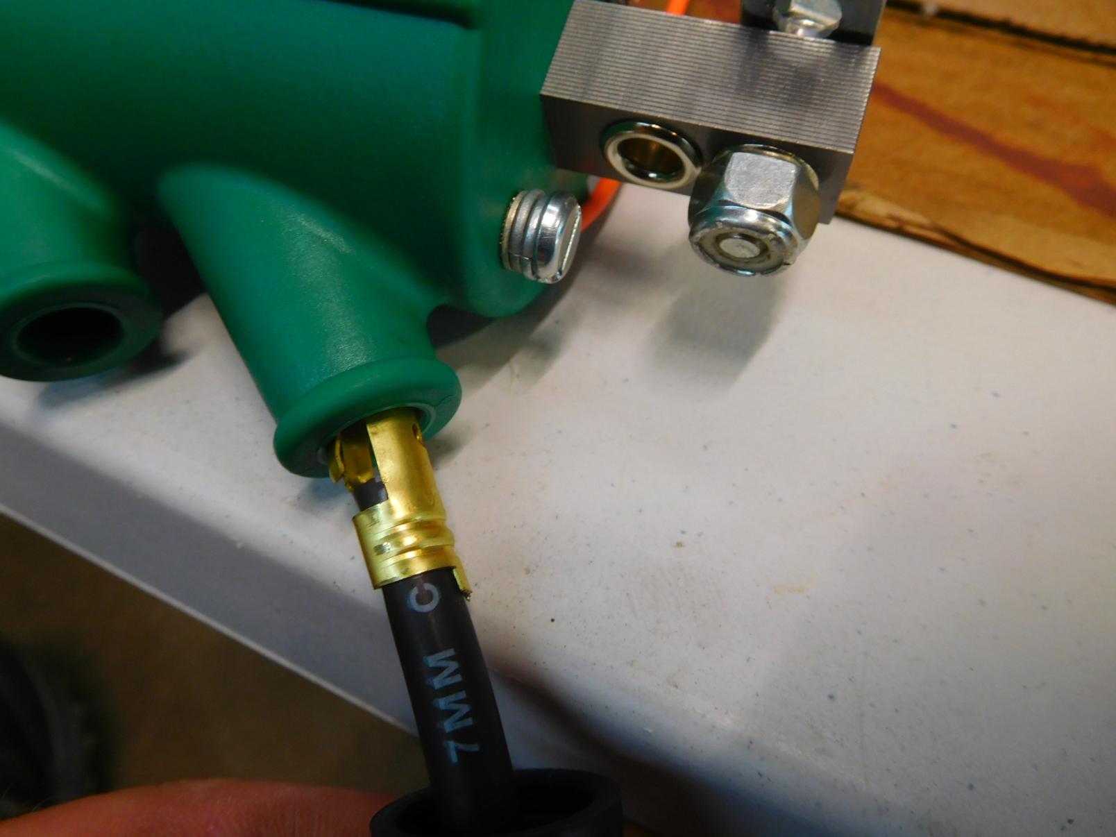

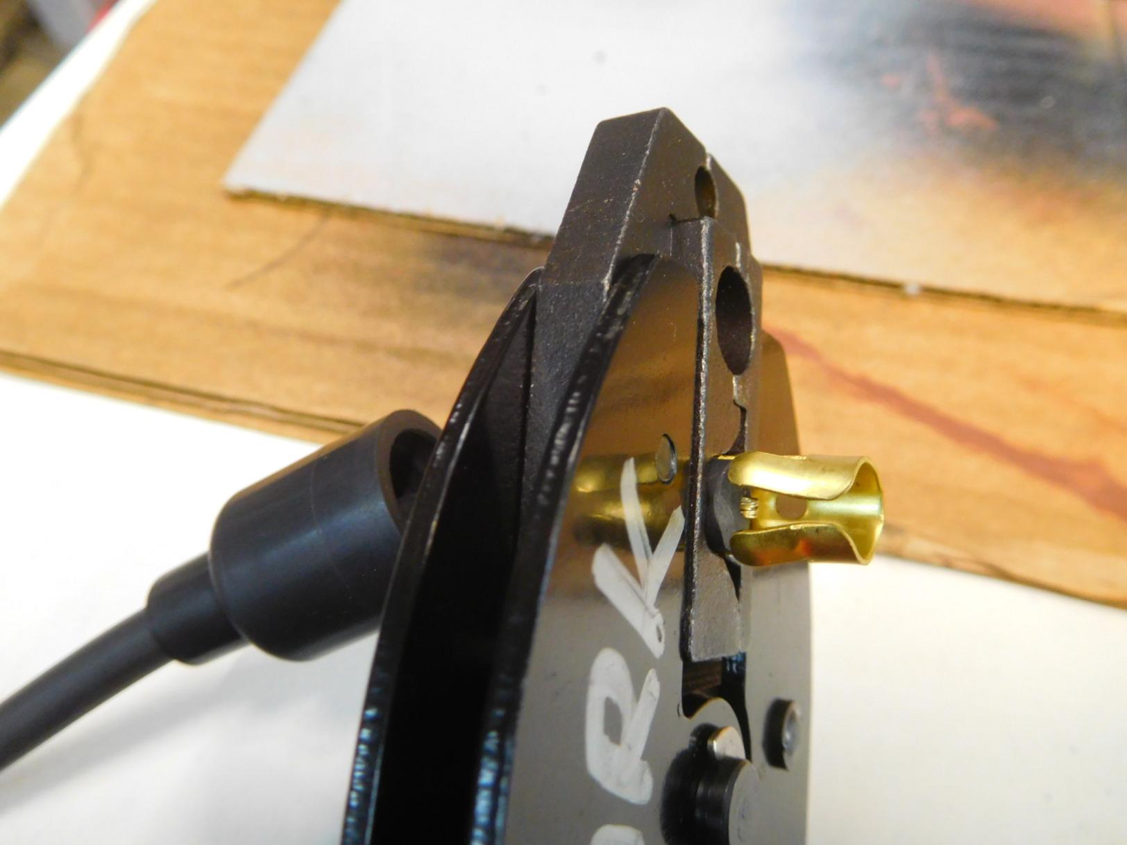

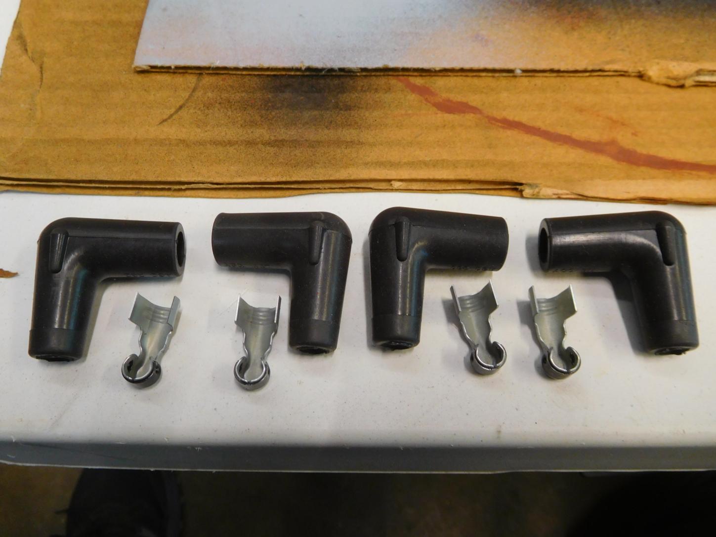

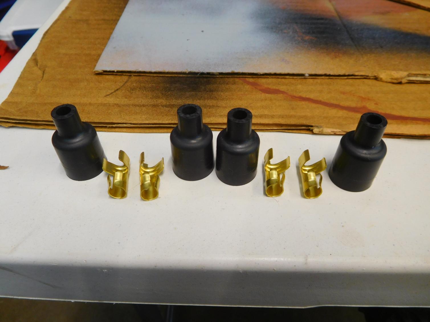

          LAB3 - 0 ohm plug caps. Wires are mint. I made them myself. I will check the coil voltage. However, I have a Geezer voltage regulator that charges rather high and my volt meter sometimes reads as high as 15v (possible meter inaccuracy). One of the coils (possibly 1&4) could be defective under load because of overheating. I had this happen on another bike.

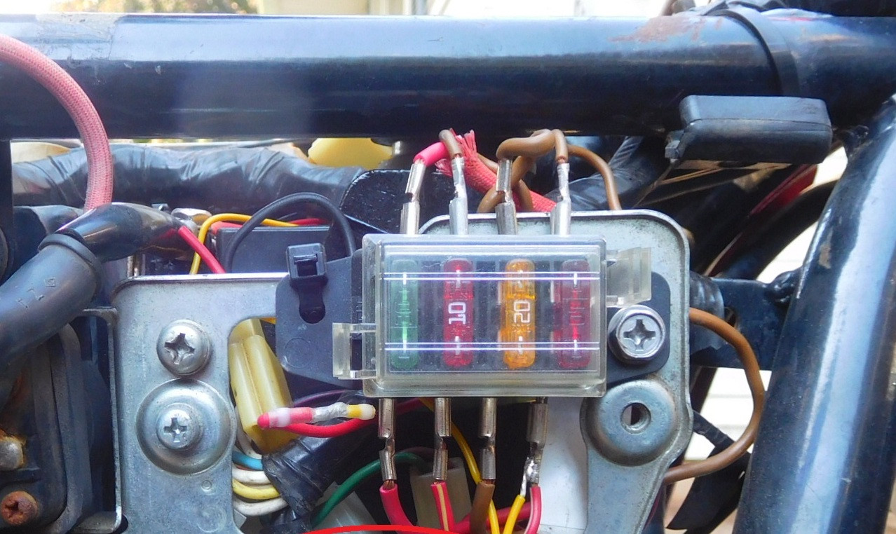

                LAB3 I have this aftermarket fuse holder and I will check to see if the fuses are possibly corroded. Especially the one that feeds the coils. I will also check the ignition switch for any voltage drop.
