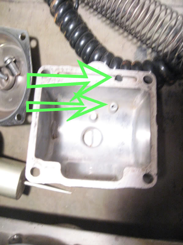

        Yep, make sure the starter jet is clear down the carb bowl tunnels...

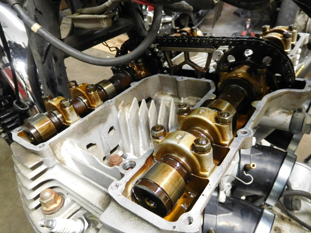

          This sounds like a classic case of valve adjustment issues. The gap on the lash is closed and the valve does not sit tight on the seat. You might actually have low compression issues. No gas is getting sucked into the cylinders on the first stroke. Seen it many times. Check those valves and then do a sync.

                    I'm with Deebs, check your valve clearances. Listing everything something COULD be doesn't help much until the most obvious choices have been eliminated.
