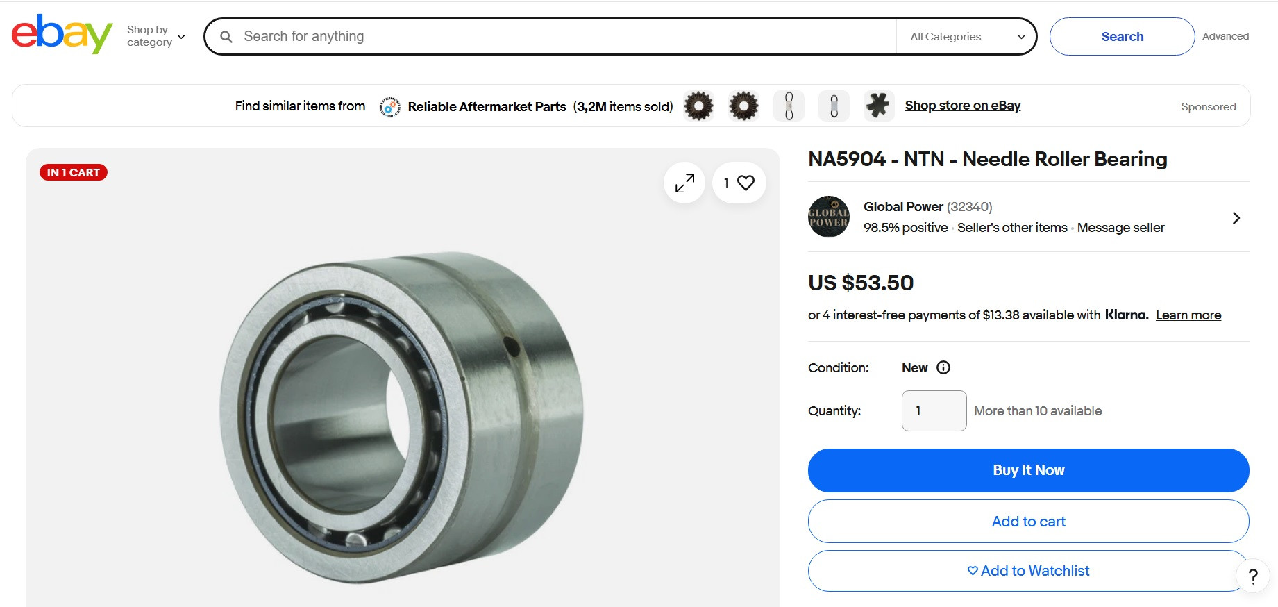

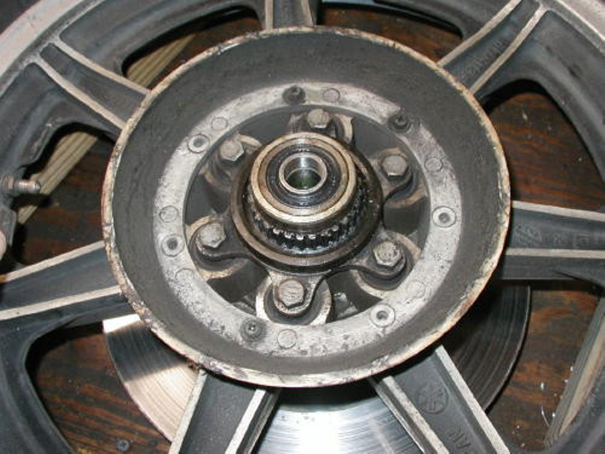

I am doing tires, so thought I might as well replace the original wheel bearings. I like to sort things out slowly as I go with the bike. So of course the front bearing was easy to find (not easy to remove, a whole different story) but the rear bearing seems to be unobtanium. DEEBS11 I saw you using one off Ebay somewhere? I haven't pulled the back wheel yet, I am not really sure what the bearing setup is back there. What bearings do I need, and seals? Cheers.
The Infamous Rear Wheel Bearing

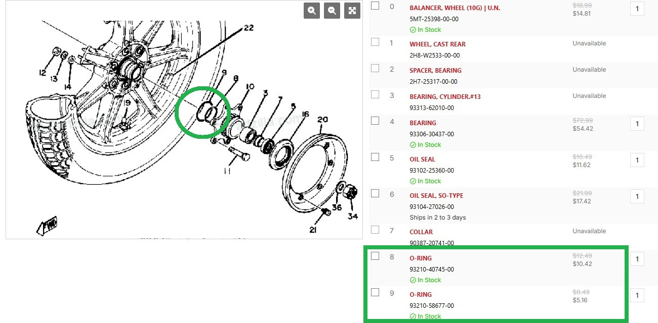

Left rear wheel bearing for sale - XS11.club Forums You can go to Partzilla and look up your bike and you can find the rest of the bearings listed and I believe most are still available. It was the one NA 5904 which was thought to be unobtanium. As you can see it too is available.2 - 80 LGs bought one new
Jim -
Bearing replacement starts by removing the right bearing first after removing the retaining clip. This will expose the base of the left bearing that can be knocked out with a long drift. Because of this, the left bearing can be removed without damaging it. I usually warm up the bearing area with a propane torch first. Everything moves much easier that way.

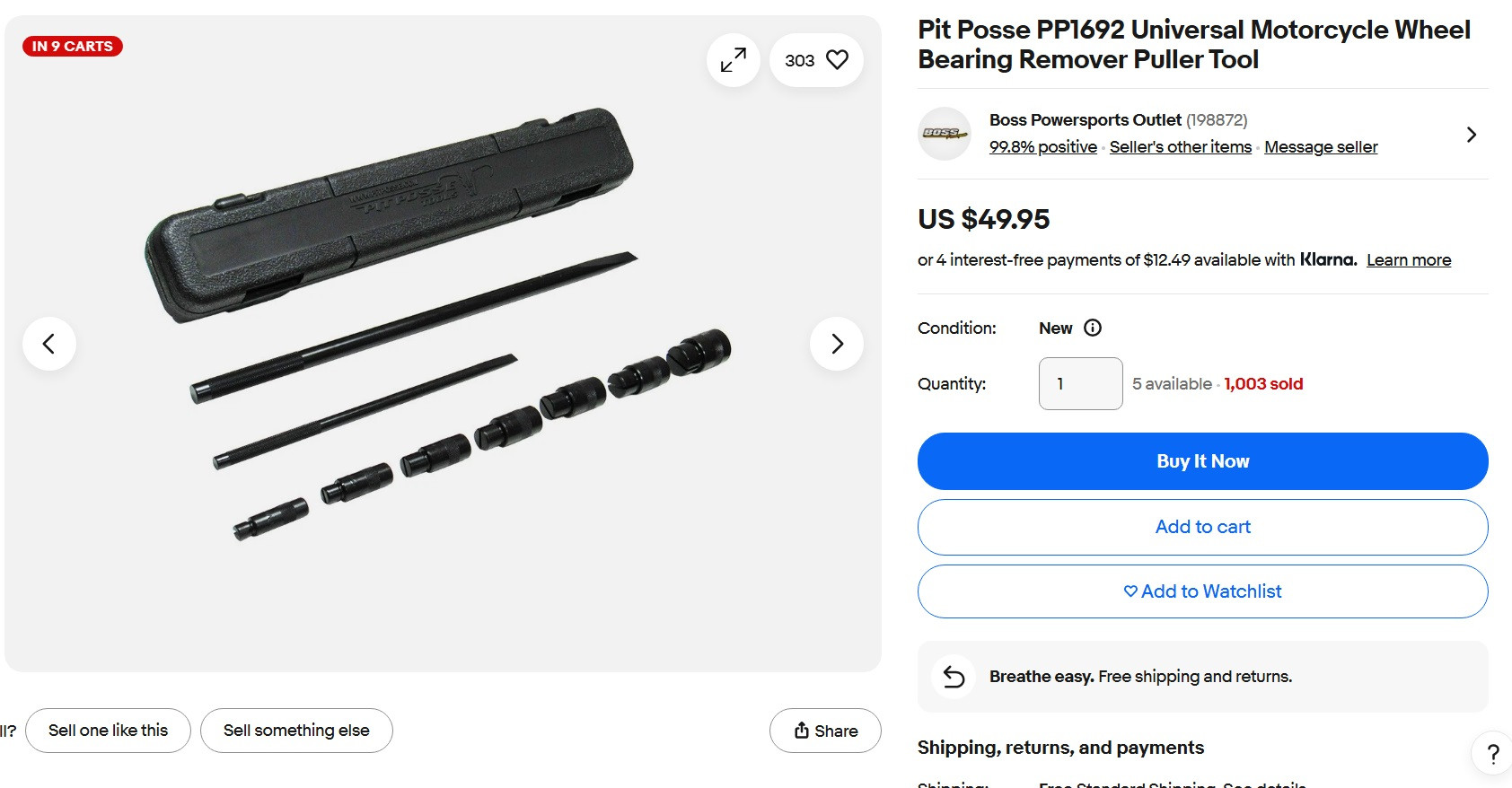

This is the best tool for removing wheel bearings (& a propane torch).
https://www.ebay.com/itm/40108492592...Bk9SR6aew5XJZw
👍 1Comment
^+1
I bought that same Pit Posse bearing remover and it made my life SOOOOO much better. I wished I had bought it sooner.
I used to spend a couple of hours heating and pounding on the bearings to get them out. Now it just takes a few minutes with no trouble.-Mike
Previous: '68 Motoguzzi 600cc + '79 XS750SF 22k miles +'84 Honda V65👍 1Comment
That is where I am today.... HOURs of trying to catch the slightest edge with a drift... and no luck at all. Bought a blind bearing puller off Amazon, did not work either. I will have to look into this.😞 1Comment
Dean, Only if you have access from the other side. Meaning you have to be able to pass the punch rod through from the other side. Here is a video showing the use of the Pit Posse: How to Remove a Wheel Bearing Using Pit Posse PP1692 Wheel Bearing Remover (Street) - YouTube. For truly blind bearings with no access from the opposite side you would have to purchase a blind bearing removal kit which are ok and work but you have to work at it a bit more and results may vary. I own this as well VEVOR Blind Hole Bearing Puller Set – 16-Pc, 6-59mm. Like Deebs stated heating things up a bit helps.2 - 80 LGs bought one new
