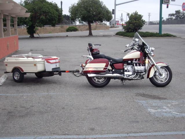

      I always hated working on full dressers and charged more for obvious reasons. Takes for ever to get to anything. The ironic math of it all is the bike is made for heavy miles so you end up needing to do a lot of maintenance if you use it for what its intended. Even oil & filter is a chore. And rear tires are a real pain. I once had to change a thermostat on a 1500 Goldwing. Body panels, hoses, wires and a lot of swearing. I do like working on my Valkyrie because there is no (unconventional) bodywork.
