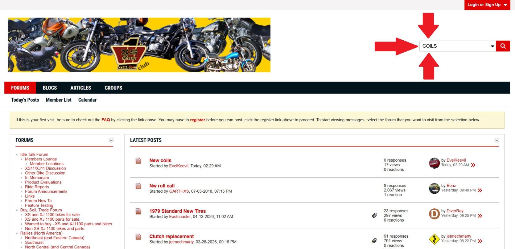

    You can do a search for coils. The need to be the correct resistance with or without the ballast resistor.
Name:	search for coil info.jpg

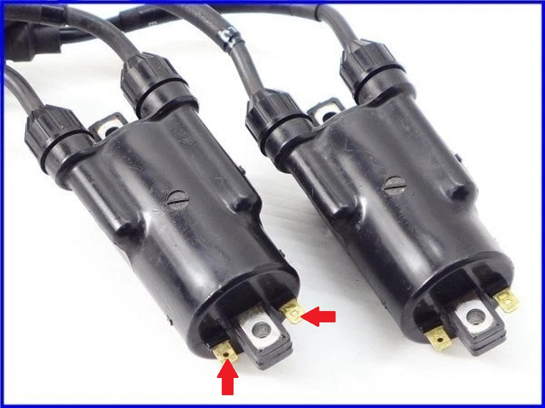

          Like I said, you need to use a meter & measure the resistance of the coil primary terminals and tell us what the number is. Should be around 3 ohms.
          Click image for larger version  Name:	coil primary measure.jpg Views:	0 Size:	153.2 KB ID:	889389

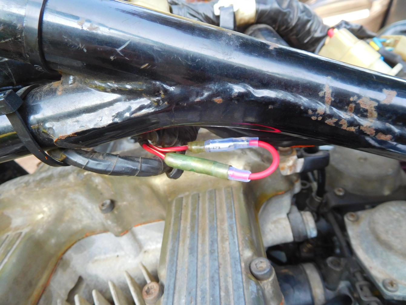

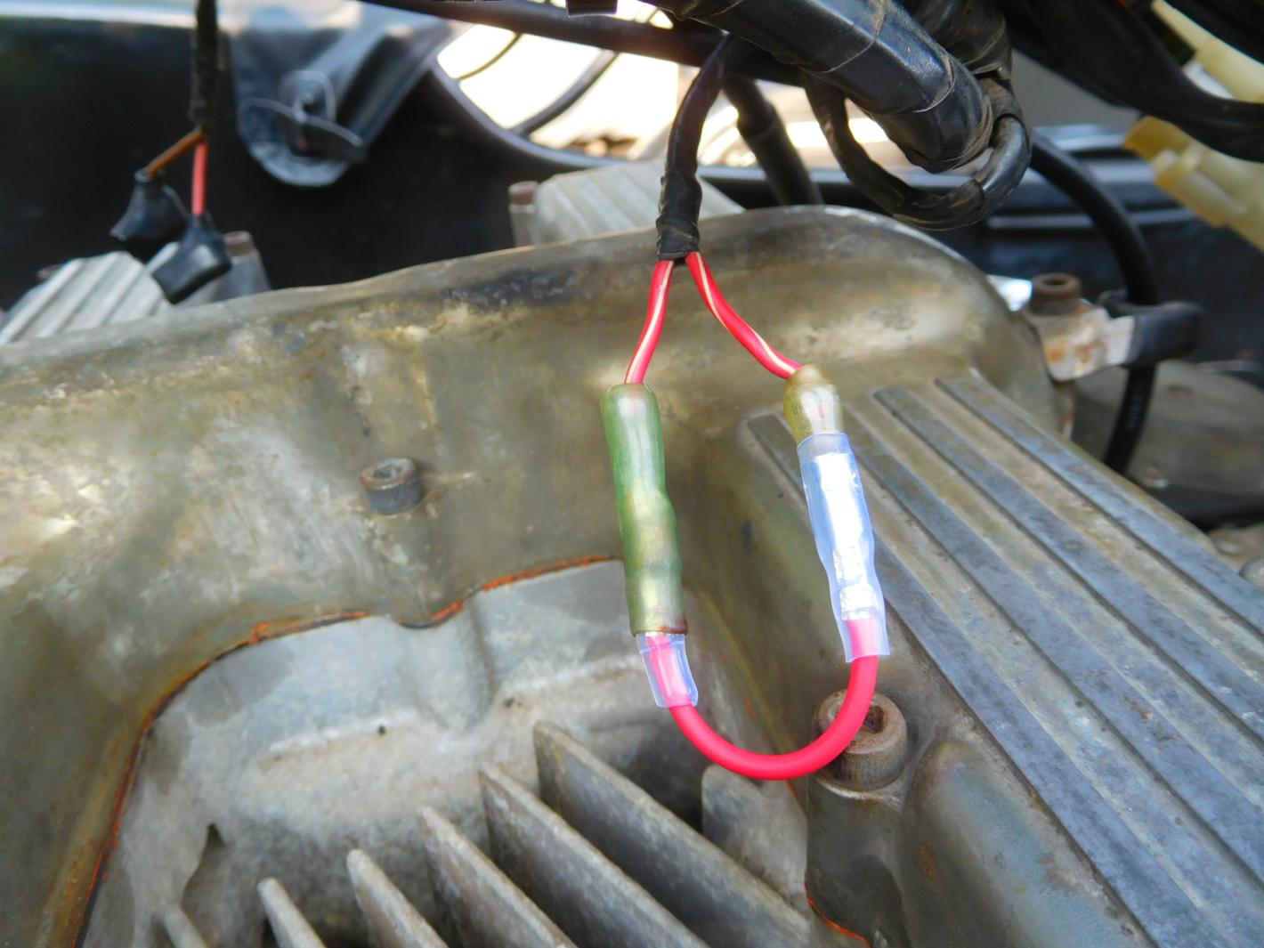

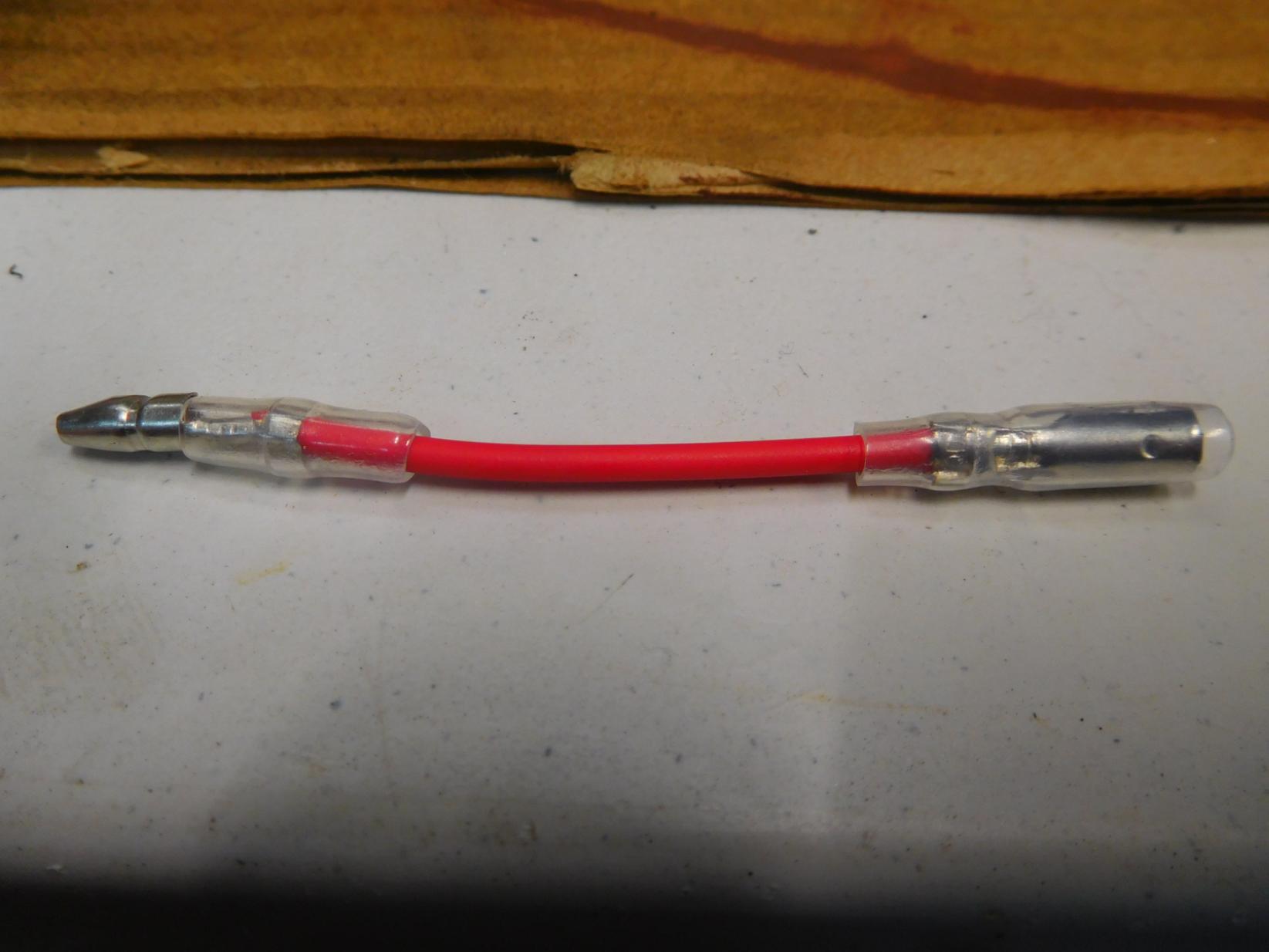

              If they turn out to be 3 ohm make sure you bypass the ballast resistor.
ID:	889407 Click image for larger version
ID:	889408 Click image for larger version

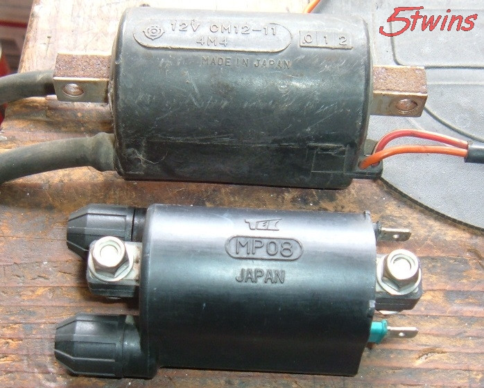

                  From XS650.com:
                  Sounds like you may have a bad coil. Many times when a coil goes bad, it acts up when hot but works fine when cold. A nice cheap replacement is a used Honda MP08 coil ......
                  about 3Ω, give or take.
                  These should fit the bill, and the budget.
