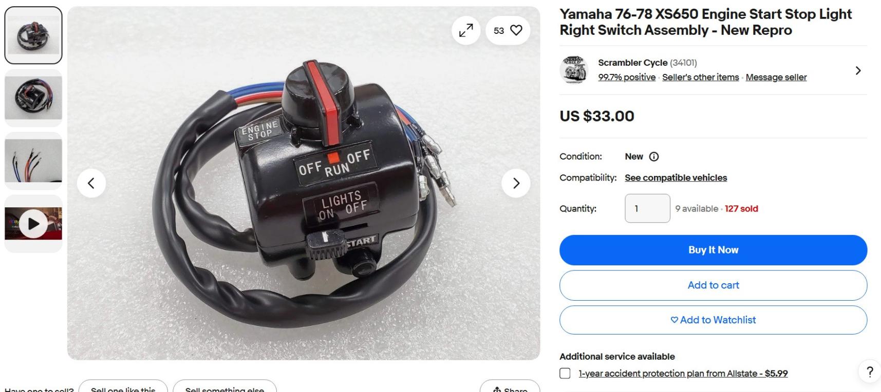

    MikesXS switch? It’s probably roached. Good used is often better than MikesXS parts.

              I second what Jetmechmarty said about the Mike's XS switch. ( •_•)
              If you had a used-but-good OEM switch then at least someone here could verify what wire(s) in the switch were connected and where in a functional/good setup for a comparision. ( ͡° ͜ʖ ͡° )
              But since it's an aftermarket switch and that's the last corrective action you took before this "event"? (O_o)
              I'm thinkin' they're connected and in a bad kinda way. (•﹏•)

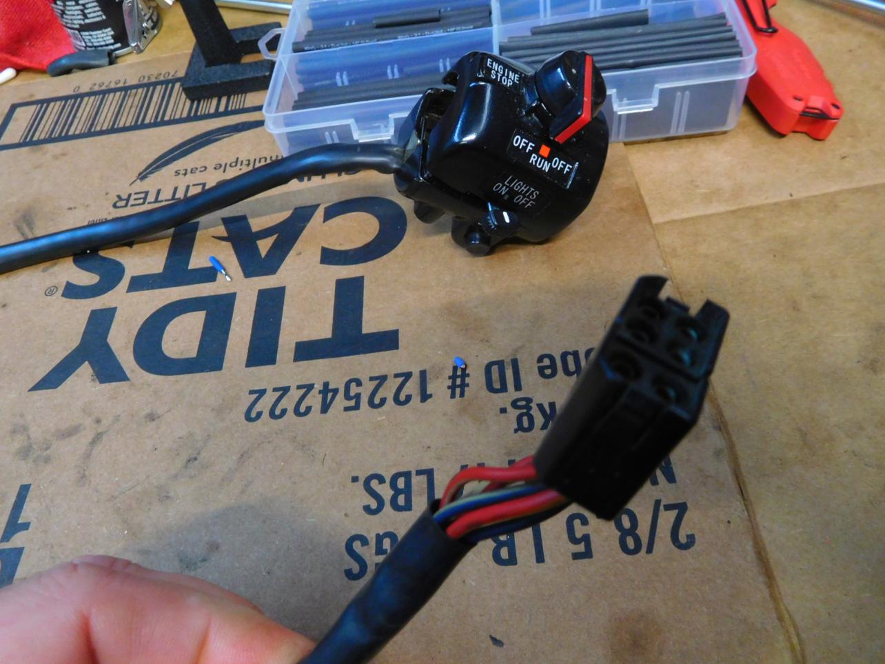

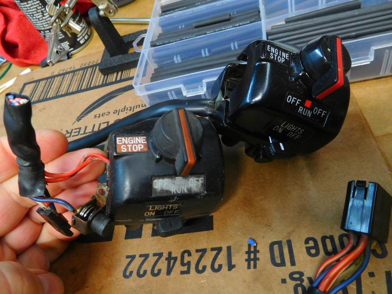

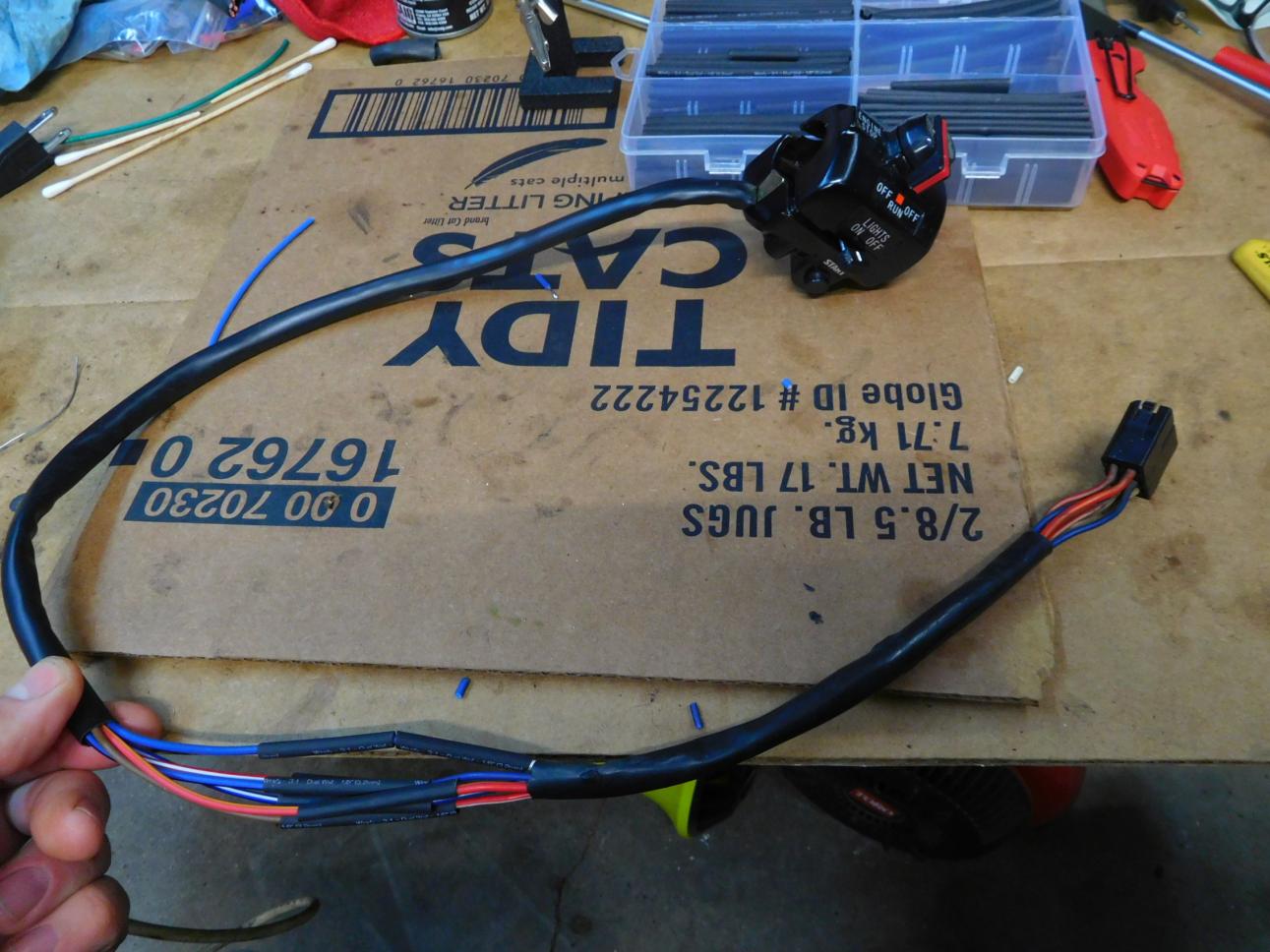

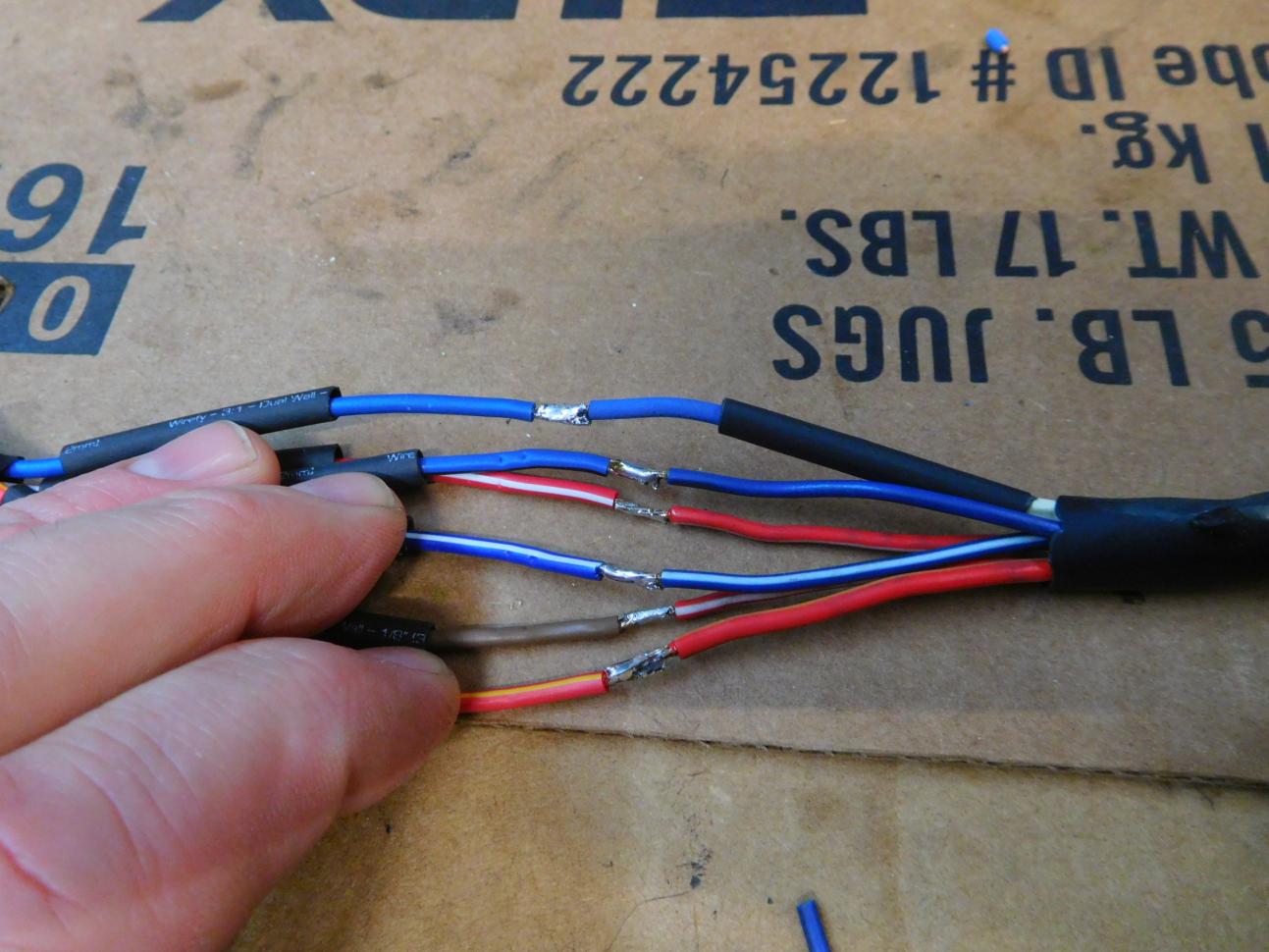

                I used these aftermarket XS650 switches. High quality and have been very reliable for several years/many miles. However, you have to map out the switches and splice them into your existing harness plugs.

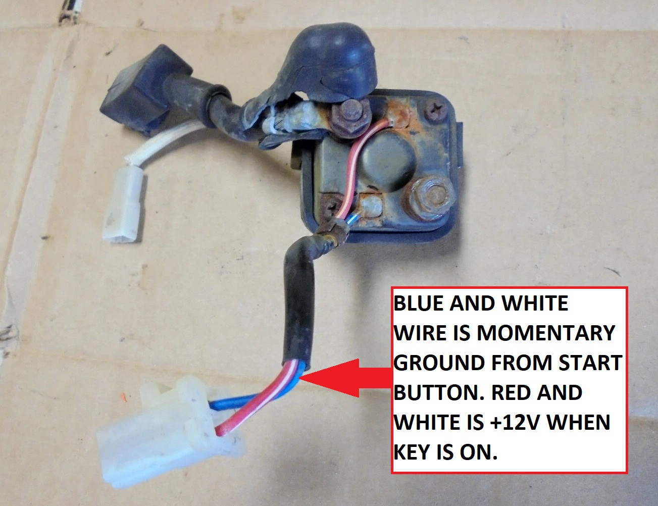

                        Starter relay could be shorted or the start button could be shorted. The blue and white wire activates the relay when the start button grounds it at the handlebars. There is a connector with two wires at the solenoid. Try disconnecting the connector.

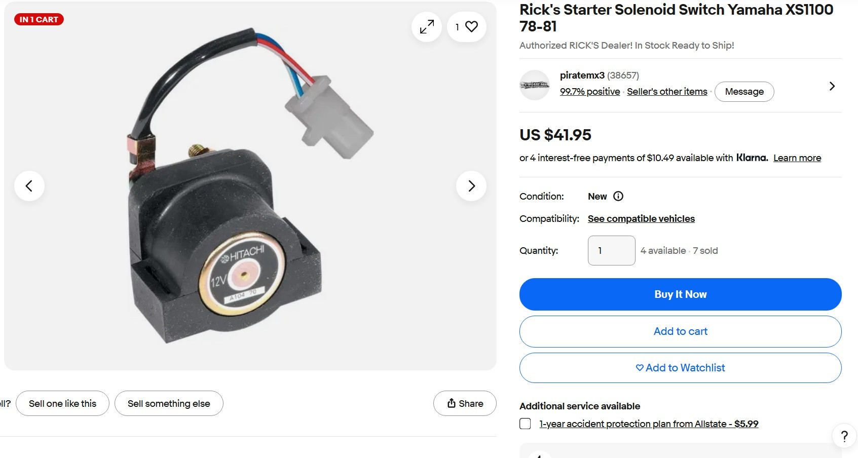

                          If needed, the only aftermarket solenoid that is a quality unit is from Rick's. I run one on my sidecar rig. The rest are Chinese garbage.
