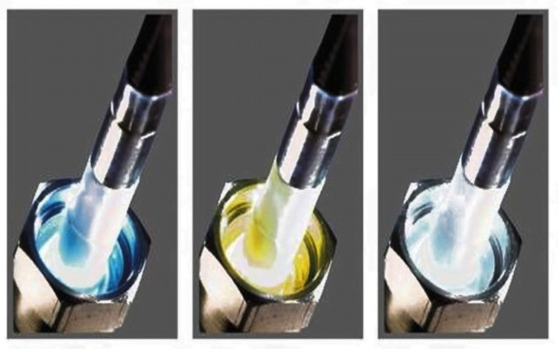

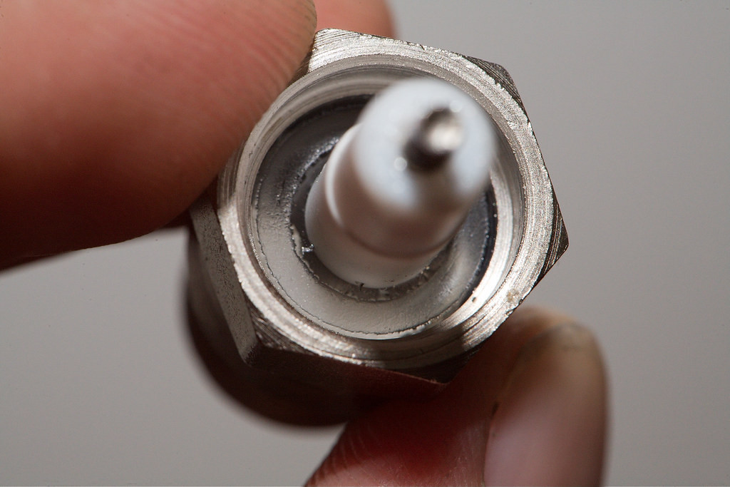

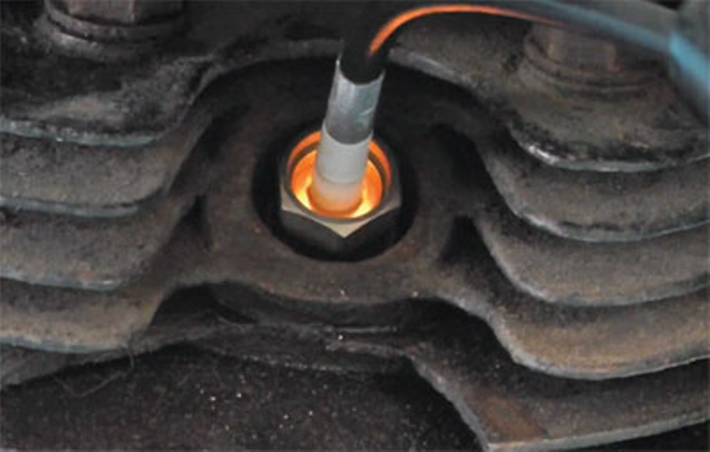

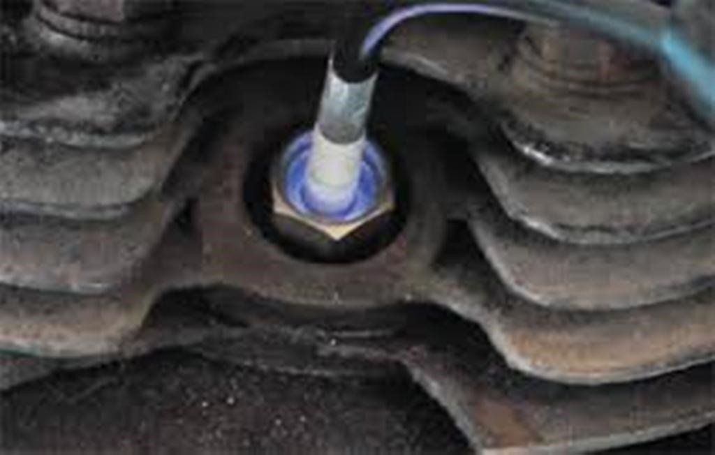

    I've had a Gunson Colortune in the drawer for a very long time. I put it to use today on the XS11. Carburetor #2 was very close. The rest read very rich. I did the setup with a warm engine and fresh E0 fuel. I'm wondering what difference it's going to make. I'm going to find out. Yes, I followed by syncing the carburetors. Fuel economy last checked was 37.4 mpg.

        I couldn't even get them close by ear. The Color tune is my go to. I always tune them in so that they are just a 1/4 turn to the rich side. I prefer that versus the lean side to guard against heat.

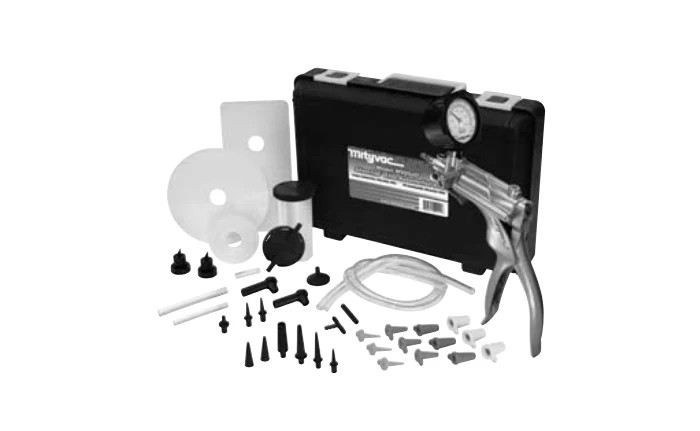

            NOT Gonna take this tho-
            It's never actually been used and I don't wanna look like an idiot if I TRY....(つд⊂)

                Should be the 14mm, same size as the spark plug is.

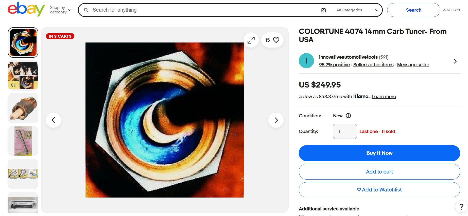

                  I was just doing a search for one and it seems that the 14mm are out of stock on the Gunson site. There are several available out on Ebay but most are from Australia with an almost 280.00 price tag. I know the tariffs have things screwed up but that price is just a tad high.

                        https://www.ebay.com/itm/23645477006...Bk9SR9jjr5OlZw
