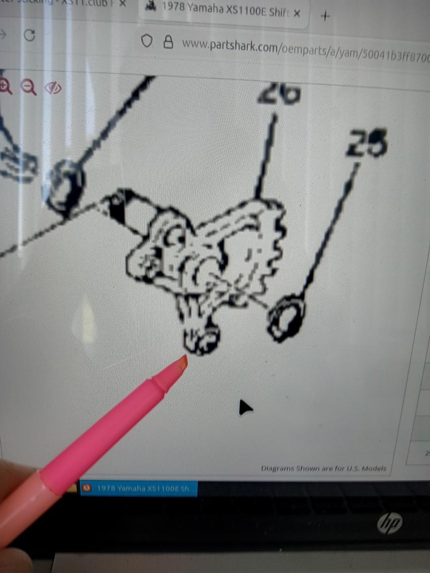

    I had a similar problem with the shifter sticking. What it turned out to be is the one of the two shifter stops on the shift pawl was worn down causing the drum to rotate too far. It could also be the pins and/or the starfish washer is bent on the shift drum.
    Click image for larger version  Name:	IMG_20260312_090351.jpg Views:	0 Size:	96.9 KB ID:	888617

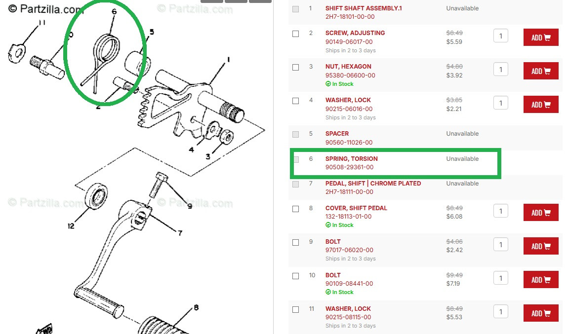

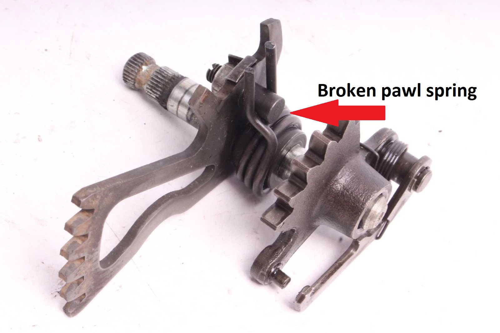

      All them "bones" are connected, pull the cover and it might be the spring right inside the cover, or at worst a bent fork.
        Yes, my vote also is for the pawl spring.

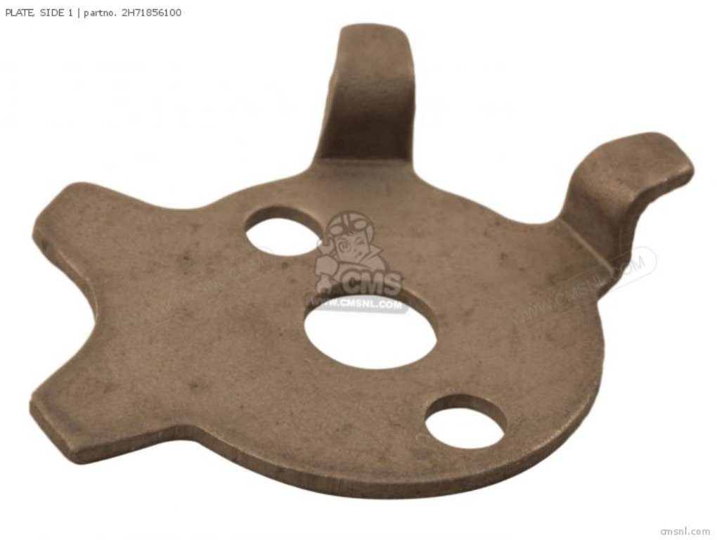

                Is it this part?

                  Yes. That's it.
