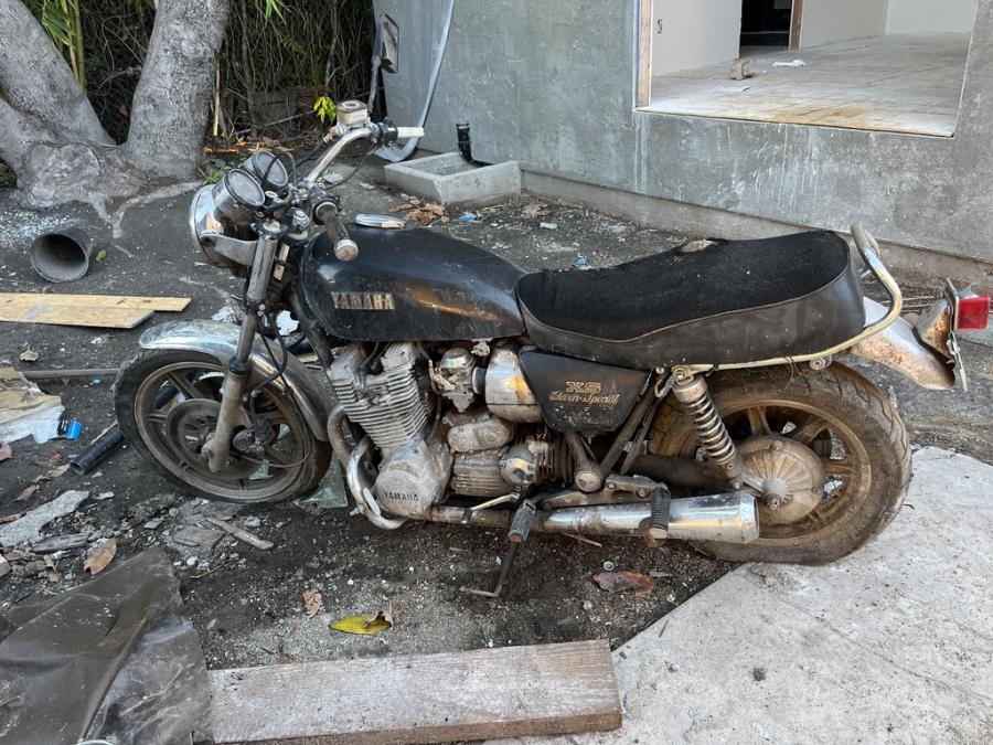

    Just got her today. Ran the VIN - not stolen. She was abandoned in a garage, probably for 20 years. I named her Lucky.
    Looks like a '79? If so, you do have some one year only body parts on the bike. Seat pan, side covers and grab bar are all '79 only. Almost everything else is easy to find. And yeah, nice find!
      Looks like a '79 Special with Standard handlebars.
      Congratulations - looking forward to watching her come back to life.
        It has the 80 and later type carbs.
          It looks like it was very wet in that parking spot area so the motor might be seized (on whatever cylinder had an open valve all these years). Pull the plugs and pour two shot glasses of Marvel Mystery Oil in each cylinder using a small funnel (and re-install the plugs hand tight) and let it sit for a few weeks before you try to turn over the motor. At the end of the 2 week wait, remove the plugs and put some balled up rags over the spark plug holes. Do not used the electric starter. Shift the bike into 5th (NOT 1st) and rock it back and forth until she releases. Oil will come flying out of the spark plug holes, that's what the rags are for.
          Also: Does it have a title? Might be impossible to register without one in your state. It's just about impossible here in the state of Connecticunt.

            I see a '79 XS1100SF and it still has the stock exhaust and the grab bar around the seat. The picture shows the whole bike. Replica turn signals are available. If those are in fact 1980 carburetors, consider yourself lucky. The '79 carburetors had aluminum tops and chrome came in 1980. The later carburetors have plastic floats rather than the '79's brass. I have the SF parts catalog around here someplace.

              Thanks Ray. I am missing the left side cover. If I can get her to run I'll start putting in the time and money to find it.

                Thanks DEEBS for the tip - especially the 5th gear thing. And as a former nutmegger I feel you. Here is Sunny CA there is a path to title, especially if it's not stolen, but it invovles both DMV and CHP. We love conservation of all kinds here!
                  The picture shows the left side cover on the bike? Are you missing the right side cover?

                        Yes. If I can get it running I'll be looking for something original if I can find it.
                          https://www.ebay.com/itm/20544798860...HA1XQD492KF4XN
                            I don't believe XS1100SF and XS1100SG side covers interchange. I think SF side covers fit only one bike.
                            1979: 3H3-21711-00-H9 (-E9 for red)
                            1980: 3J6-21711-00-2J
                            The SG, SH, LG, LH have different part numbers due to different colors, and the badges may have different holes.
                              Right.
                              That eBay listing is for a '79 Special cover.
