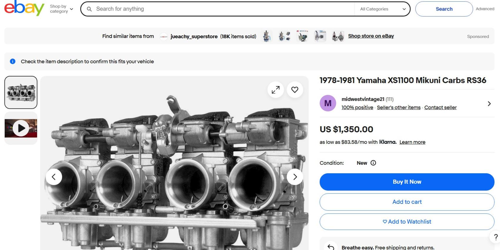

              For those with the funds:
Name:	RS36 carbs.jpg
                • 2117
                Even if they line up the jetting challenges aren't worth the effort. Clean, stock carbs are hard to beat.
                I got my GPZ 1100 carbs but my 80 SG ran excellent with the stock carbs was the reason why I didn't switch it.
                    Deebs, the ebay photo shows KEIKEN carbs, NOT Mikuni! We all know those are NOT factory carbs.
                      Ray... I believe what Deebs posted are indeed Mikuni RS36 carbs. The video that Marty posted of Andy installing them on his basket case shows the same carbs. The listing that Deebs posted in the actual description say that the carbs have actually been pre-jetted and spaced correctly for the XS1100. I suspect that is why the price is a bit higher than others out there. One other thing that has to be considered if anyone is considering those for their XS1100's is that by default they are push pull cable carbs and in Andy's video he addresses that problem. Here is the actual link to the Ebay listing 1978-1981 Yamaha XS1100 Mikuni Carbs RS36 | eBay.
